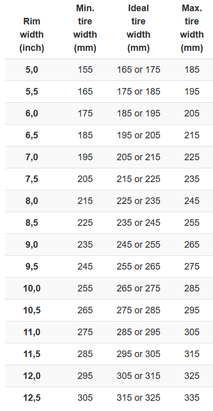

Discount Tire says they will.
Did you tell them that the wheels are only 7” wide? This is an unusual width for a 19” wheel, and the MME probably isn’t in their computer yet, so they likely wouldn’t know that. This chart suggests that 225 is the widest tire you can put on the 7” wheels.

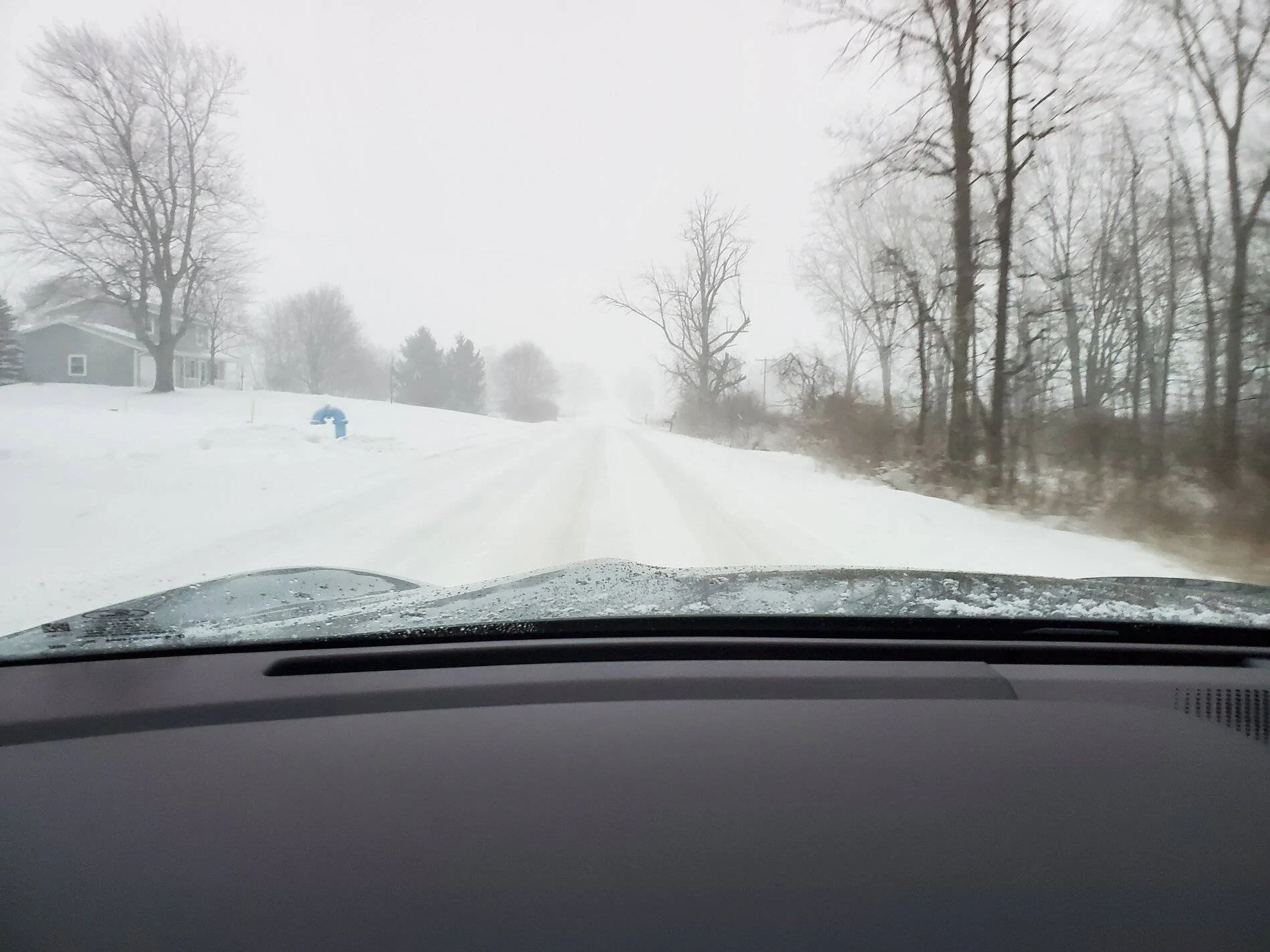

I have been driving mine for about 10 days and we just had some good snow staring Thursday and still snowing. If you have traction control on there is absolutely NO issue in the snow; fresh powder or packed and ice. I have even tried to get some slide and glide for fun and it is tough to do. Very minimal slip on starts if any. On a side note, 1PD in Engage is very effective at stopping on very packed/ice roads.
UPDATE: The photo is an example of the road conditions.
I was just out again and had a perfect parking lot to have some high schooler type fun. I turned off traction control to see what fun could be had. Definitely more slip on start up and could easily throw back end into some tight donuts with acceleration but just as easily pulled it out for straightening up. Man this car is FUN!

Oh, I was not aware they were 7", that is good info. I may have to go with the load range 99 crossclimates that are the same size. I will probably wait until September and get a few miles on the stock tires first.

I‘m planning to get 8” wheels for winter, but will likely stay with 225 tires. I’m a big fan of the Nokian Hakkapalita R3, but it’s a dedicated winter tire.
