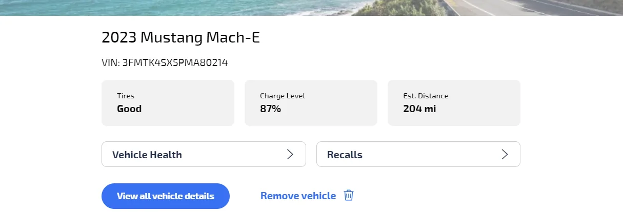

you're going to the "vehicle dashboard" not the ".......account" page, it will appear as in my case "chris' account".

You are looking vehicle page. Illogically, Ford put the LVB SoC on the Account page. ?‍♂?

Where did you find the SOC of the 12v battery. The charge level is the high voltage battery?
I went to Ford.com/my account then where?

No, on the named account the SOC is the 12v battery, this is covered in some depth on Mach Lees excellent 12v FAQ thread, the first post.
You log on to your ford.com " my account", then click on the person icon again in the upper right corner, the dropdown menu select "......account" NOT "vehicle dashboard" it will list the 12v battery SOC (this is NOT the HV battery status) along with tires- "good" and range. This updates after every access of the car, charging driving etc. https://www.macheforum.com/site/threads/12v-battery-faq.32744/
