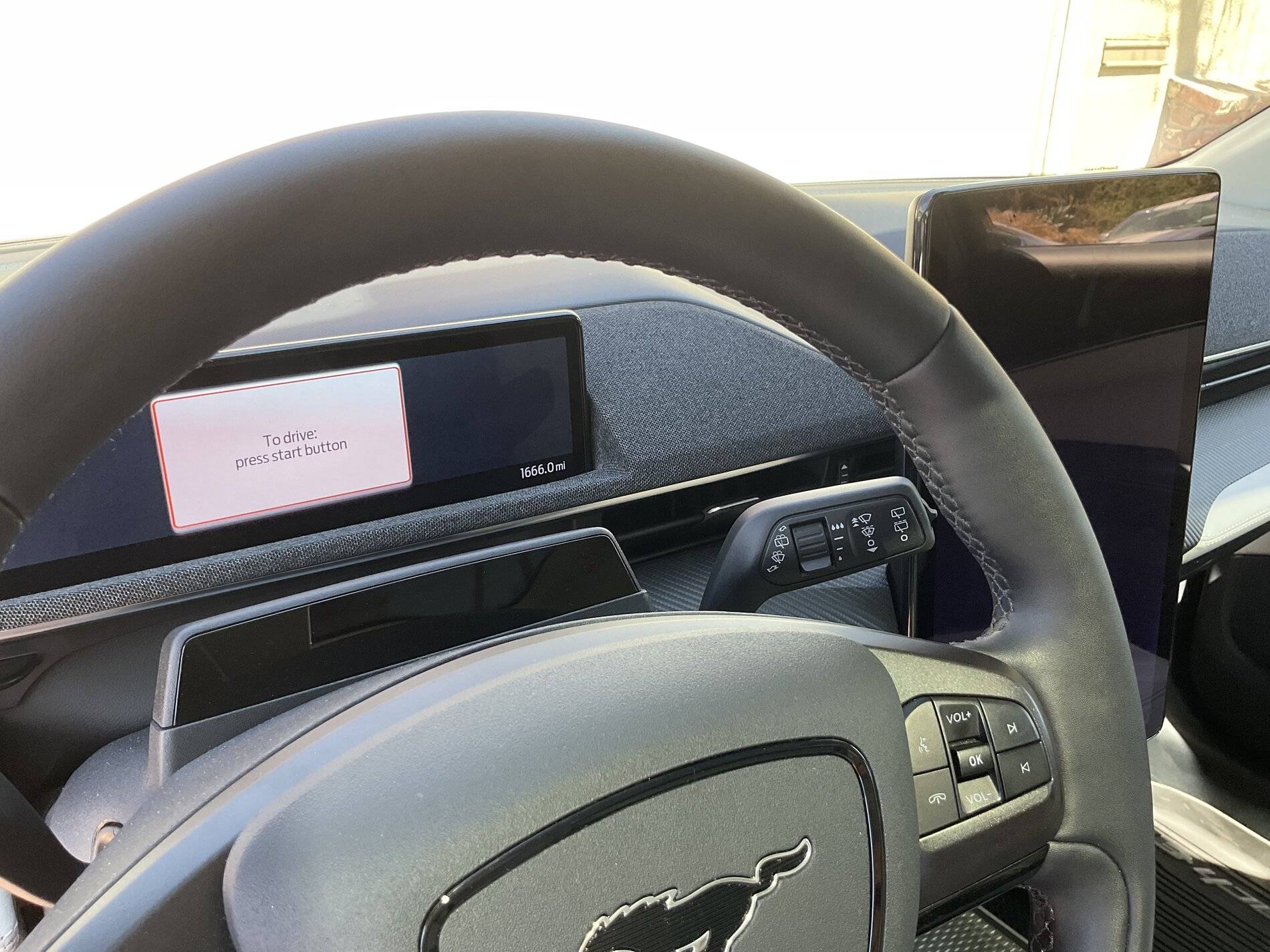

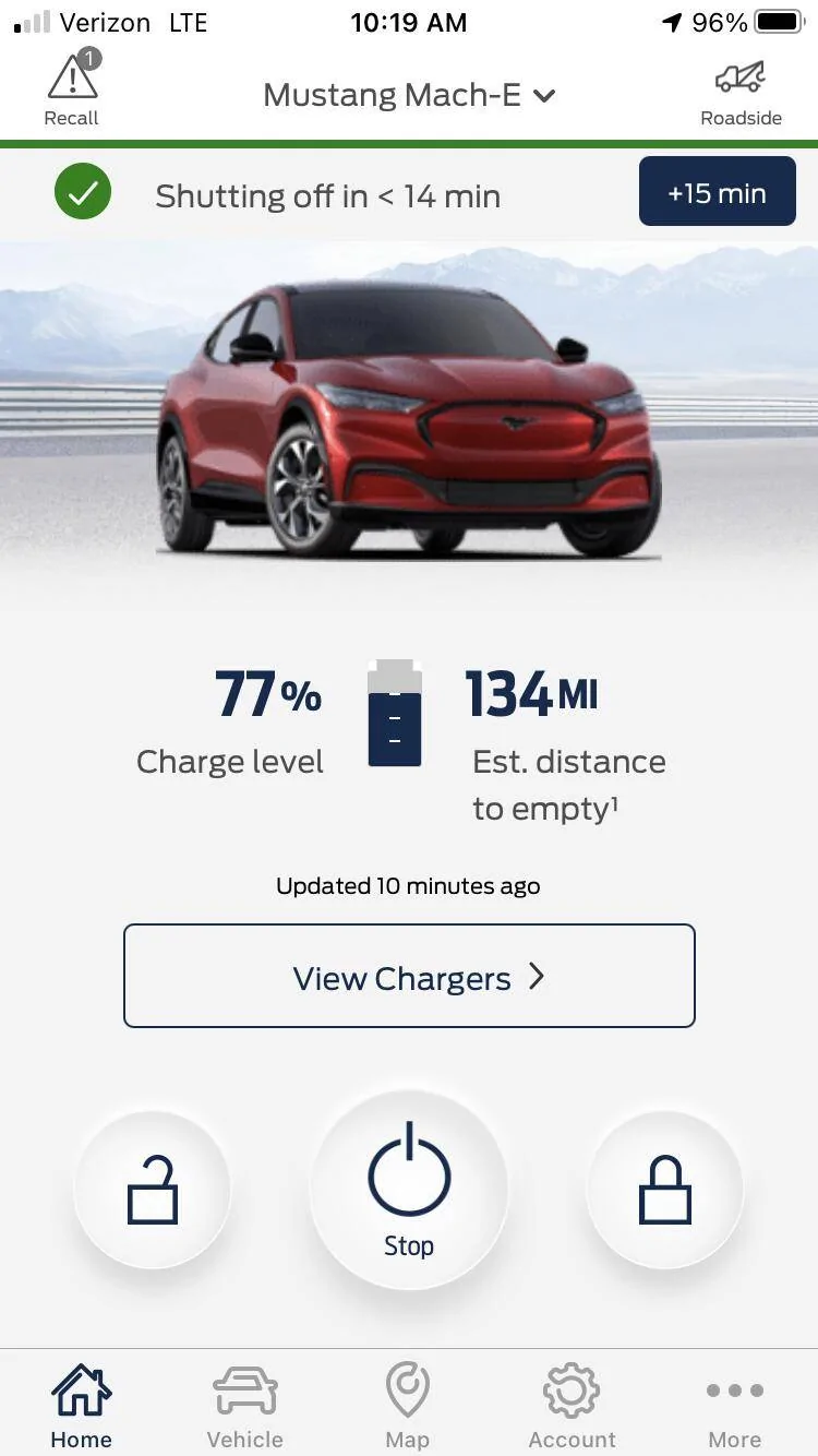

So I wanted to see what would happen if I remote started the vehicle, if I could drive off without having the back-up code or, if it is required in this situation, if remote starting might at least help prompt the back-up code screen to appear. Unfortunately, no luck either way.
I was able to remote start the Mach-E (turned off wifi and bluetooth on my phone to not trigger PaaK), and I did hear the a/c compressor come on.
Ford Mustang Mach-E Failure of Back-Up Start Code Screen to Appear 5D5A0B66-04C5-4114-90D4-A26FF074DB5B
And when I got in, the driver display did say, “To drive: press start button”.
Ford Mustang Mach-E Failure of Back-Up Start Code Screen to Appear 04333F5D-37B9-4864-80DB-240B423CA00A
But when I pressed the start button…
Ford Mustang Mach-E Failure of Back-Up Start Code Screen to Appear 0544FE1D-E353-44AA-A89C-B0CD52BE7981

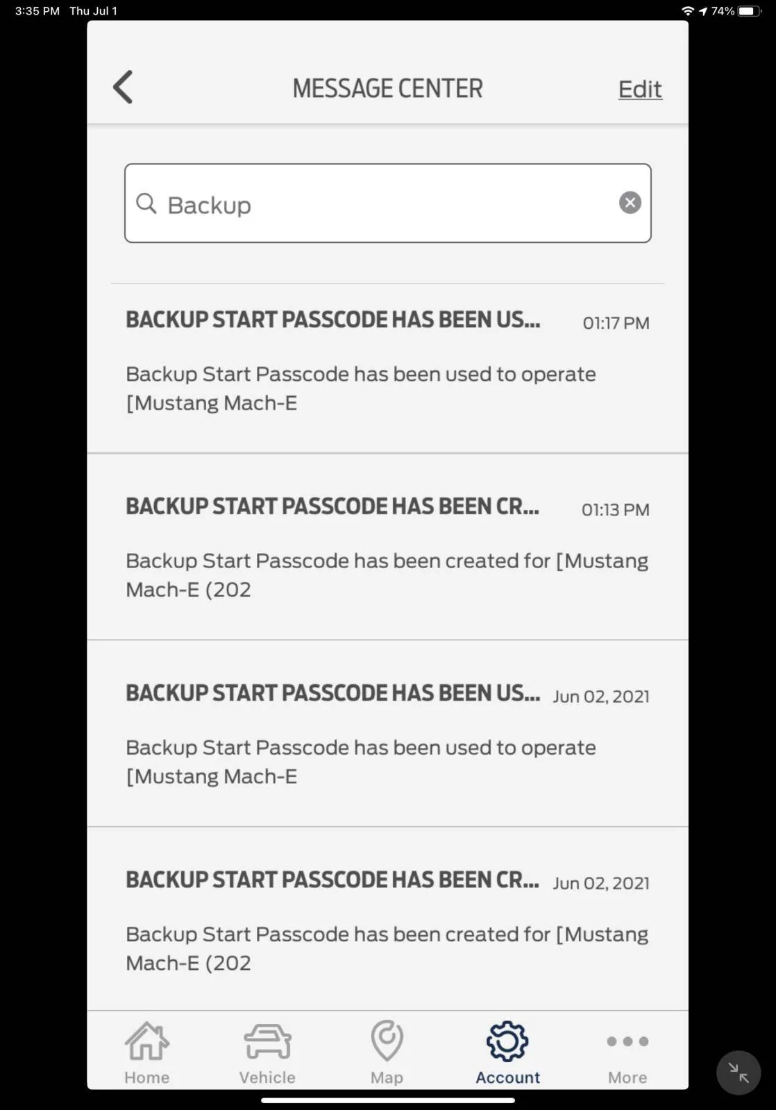

I wanted to follow up on this issue for the benefit of anyone who might be concerned about a back-up start code misfire.
In the week since I posted this thread, I had the back-up start code fail to appear once when I had a PaaK issue while out and about (luckily PaaK started to work after I force closed and restarted the FordPass App). Since I was home this afternoon, I also decided to see if I could get the back-up start code to work in my driveway. Unfortunately, the screen to input the code once again failed to appear when I used the door code to gain entry to the Mach-E and tried to start the car with no key fob or PaaK device by me.
At this point, it looked like I was experiencing a total back-up start code failure, not just an occasional issue. I started to think about why that might be happening. I thought perhaps the issue wasn’t with the back-up code prompt failing to appear but maybe something wrong with the back-up start code registration itself.
This turned out to be the case. I ended up going to my Mach-E with my key fob and PaaK enabled phone. When I navigated to the back-up code screen in settings, the vehicle was asking me to create a back-up start code, as if it had never been set up.
But I definitely did set up a back-up code when I last reset PaaK about a month ago. Understanding all of this, I recall that in the days after I reset PaaK and reset my back-up code in early June, I would get a weird notification about a minute after I started driving asking me to set a back-up code. It wouldn’t let me do it while moving, and would disappear in a matter of seconds before I could pull over. Anyway, it stopped appearing after a couple of days and I thought nothing of it because not only had I set up a back-up code, but had successfully tested it too. I’m sure on this because I have the FordPass App notifications showing I set it up and successfully used it in early June (see below screenshot).
So the issue appears to be something that went wrong in the back-up code set up process, where I am reasonably confident it was working initially, but then appears to have somehow deleted/reset itself.
If I get that message to set up a back-up code while moving again, I will try and take a picture of it to post.
Ford Mustang Mach-E Failure of Back-Up Start Code Screen to Appear FC42F044-626D-4982-8A01-FE82A6EC0F97

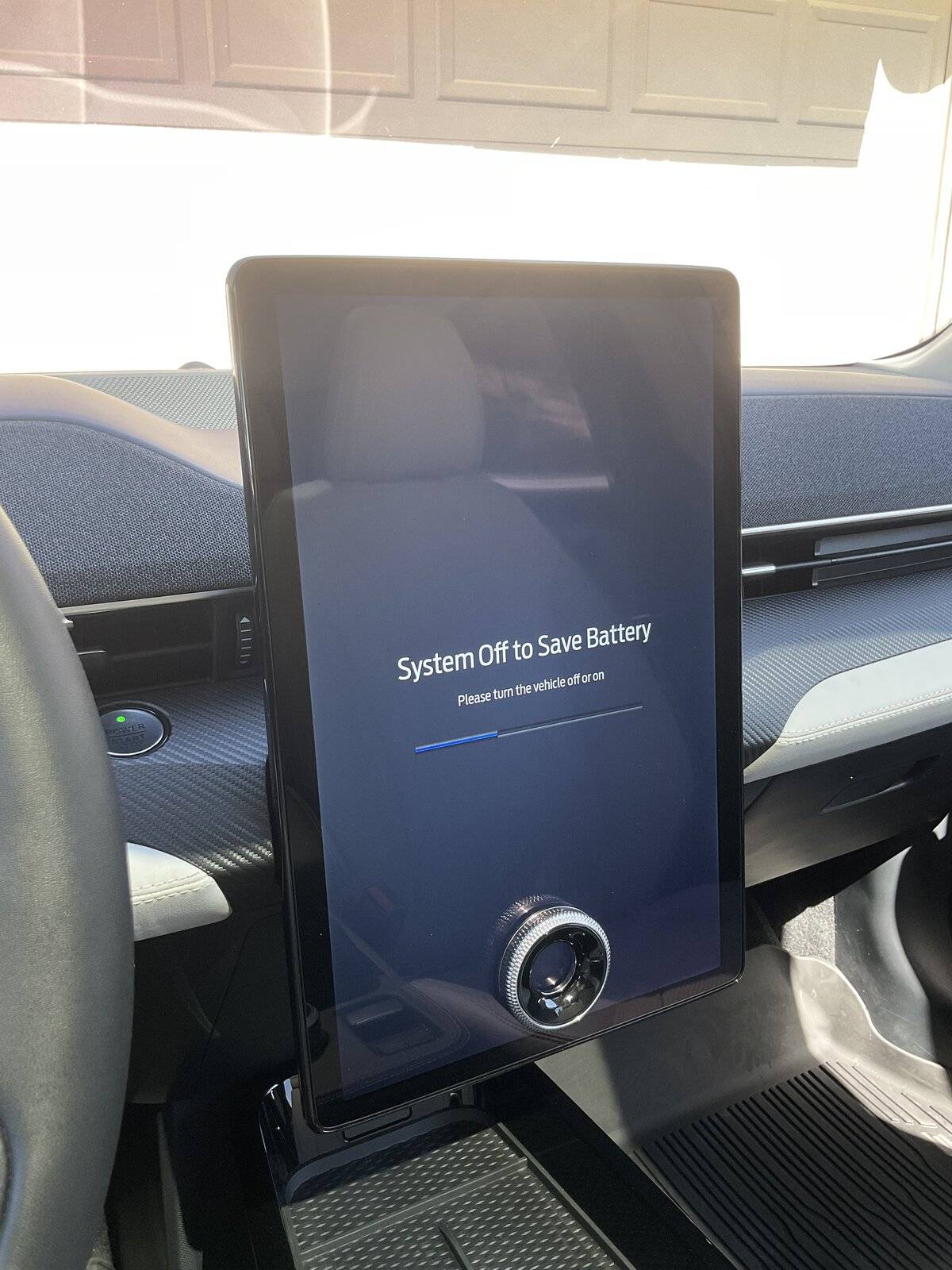

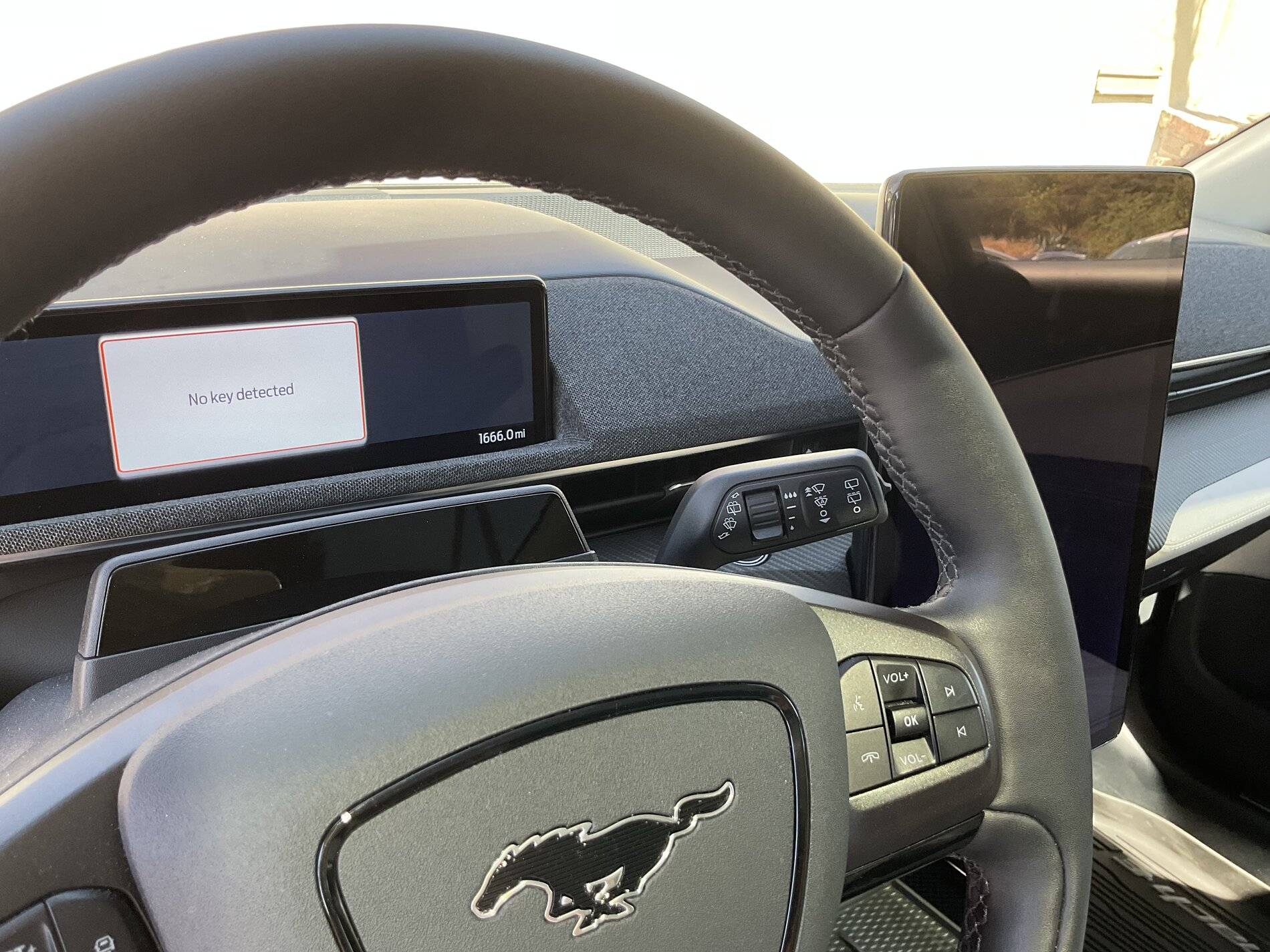

So yesterday morning I too couldn’t start my brand new MME. Just took delivery 4 days ago. I got the no key detected message. I only had my PaaK. After 3 horrible hours with “customer service” from the FordPass phone number, I finally had my wife bring the fob. Even with the fob, couldn’t get it started. I was in an area with dicey reception but still. It’s currently at the Ford service department. I also couldn’t even get a screen to work off of. Talk about a buzz kill after my new car high.
