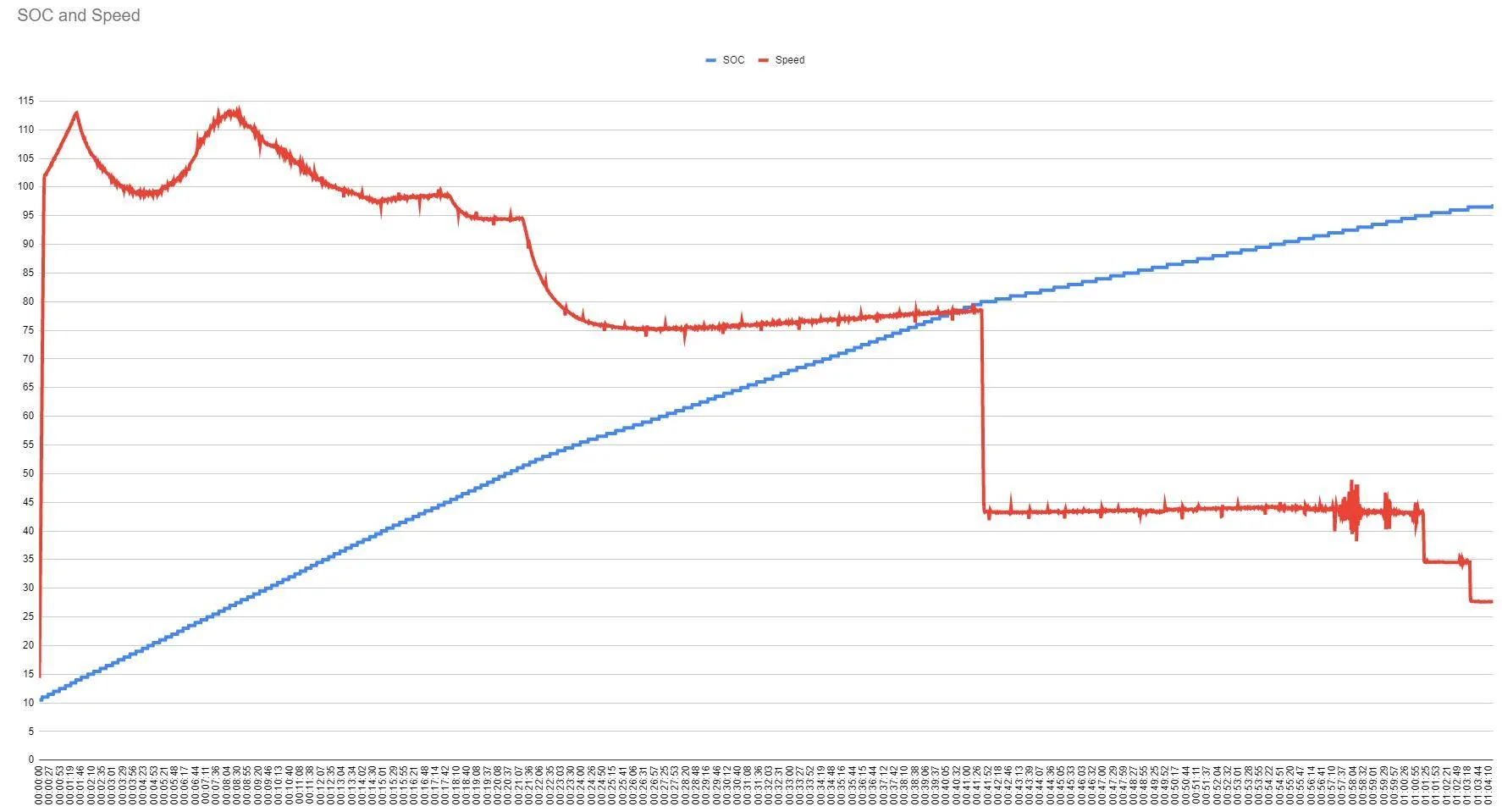

It isn't easy finding the new charging curve data in this forum, and I have not done a complete charge myself. But @Mach-E VLOG created a spreadsheet and graph here:
Ford Mustang Mach-E Fast charging - to 80% or 90%? 1664796420067
In this test, at 80% it slows down to 42 kW, and at around 95% it slows down to 36 kW. Above 96% it slows down to 28 kW, which is still a lot faster than L2, but too slow if you are on a trip. The test stopped before 100%, but the charge speed probably keeps slowing down as it approaches 100%.
