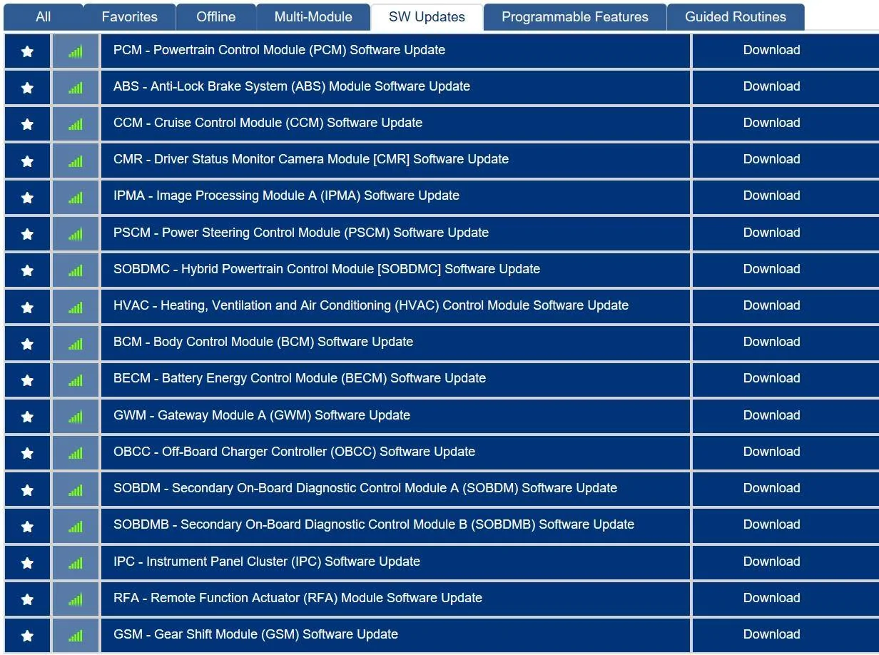

The update that changes the charge curve and allows fast-charging at greater than 12kW is 21P22.
