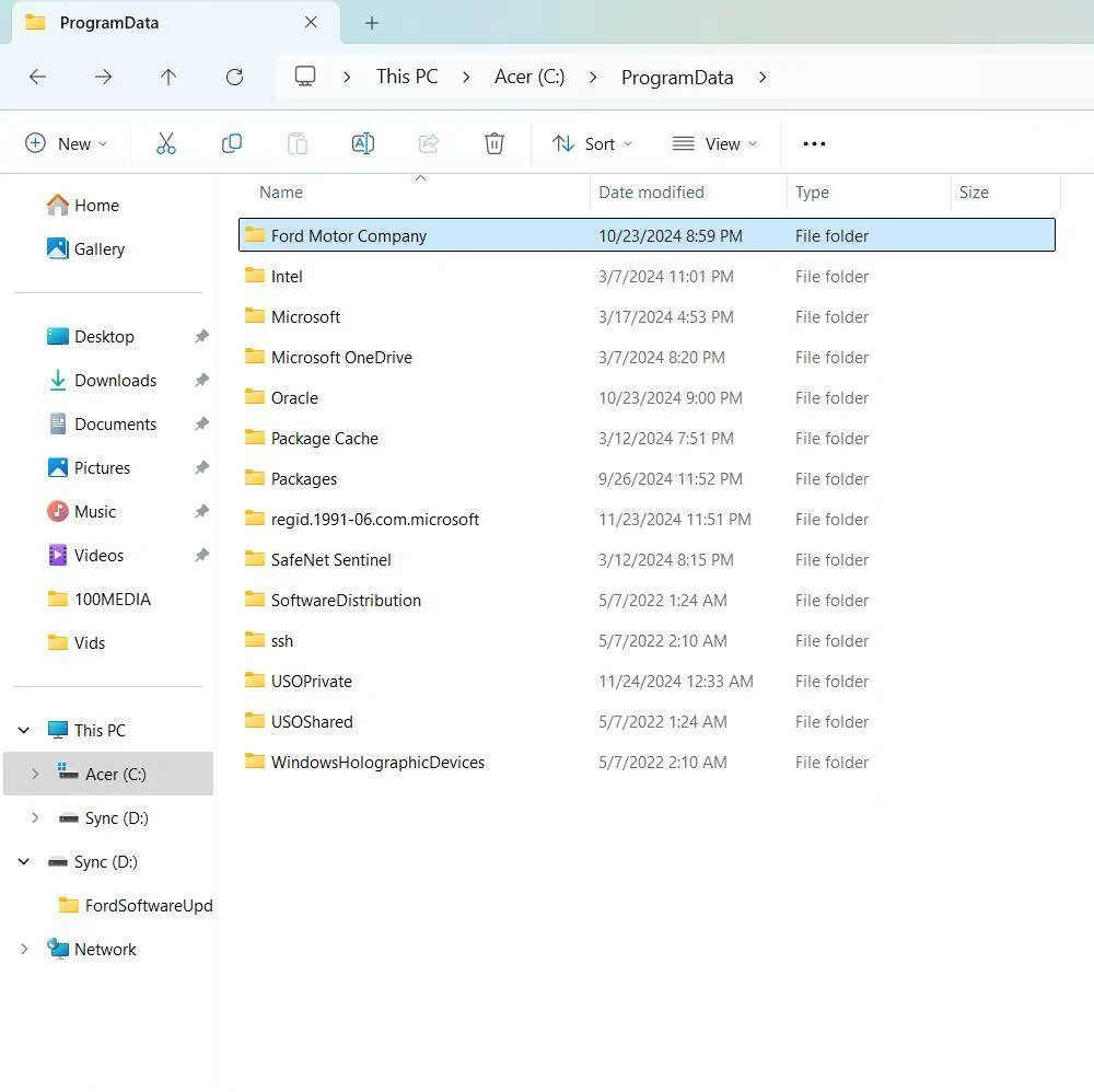

Try uninstalling FDRS completely (delete all files associated with FDRS) and try installing an older version to see if it lets you log in:
https://www.dropbox.com/scl/fi/0ekr...ey=rfyoxhv8v57cbzvvpms3cnnvj&st=268vjcwu&dl=0
https://www.dropbox.com/scl/fi/zixv...ey=3dpf566ywkckuxyr0n48ko10a&st=ykkvo78c&dl=0
The first one is 39.6.4 and the second link is 41.5.6.
To make sure all files are deleted, go to your c drive and make sure you have it showing hidden files. Go into program data and make sure the Ford Motor Company folder is deleted after you uninstall FDRS. If it is still there, delete and then try to install the older version of FDRS to see if that works.
