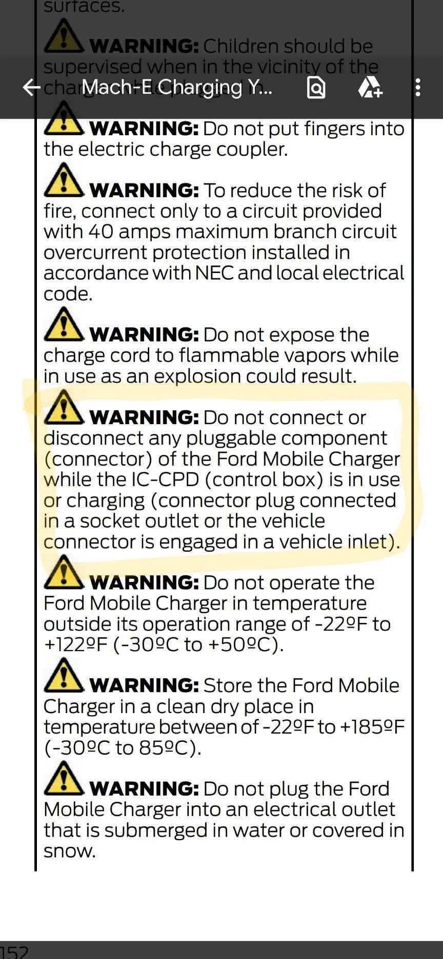

I'm not worried about bricking the car it's the mobile charger I don't want to brick. It's all I got right now.
As others have posted, I think it is harder on the charger to frequently disconnect and connect a new pigtail as you switch back and forth between 120V and 240V. It is best to unplug at the car and then unplug at the outlet, and leave the pigtail adapter undisturbed. Otherwise, unless you have a defective EVSE, I would not worry about bricking it just by using it.
Keep it plugged in except for when you want to take it with you in the car. Personally, I only use the Ford supplied EVSE when traveling as I have a hard wired EVSE installed in my garage. That is what I recommend as it gives you the most flexibility, and a backup charger in case the one in your house fails.

He's trying to disconnect it from electricity for safety. He figures leave the plug to not wear socket out, and disconnect it midway. I am saying disconnect nothing and hang it up.

Just do not do it. The Ford Mobile Charger (FMC) is not adjustable. It runs at 32A and requires a minimum of a 40A circuit. It will be a problem one way or the other. ??
You will be stuck either charging on the road or charging at your GF’s at 110V if you must use the FMC. If you cannot charge on the road, I would suggest a Tesla Mobile Connector with a 10-30P pigtail and a Tesla Destination to J1772 adapter. The Tesla will down rate to 24A so that it is safe on a 30A circuit. I use this exact setup at my co-worker’s duck club (10-30Rs at the camp site). ??

Most dryer outlets are on a 30A circuit. It is unsafe to use the Ford Mobile Charger on a dryer outlet because the FMC draws 32A. If you wish to continue using a dryer outlet, get an EVSE that can operate at 24A. Containing to use the FMC on the dryer outlet is a fire risk. ??
