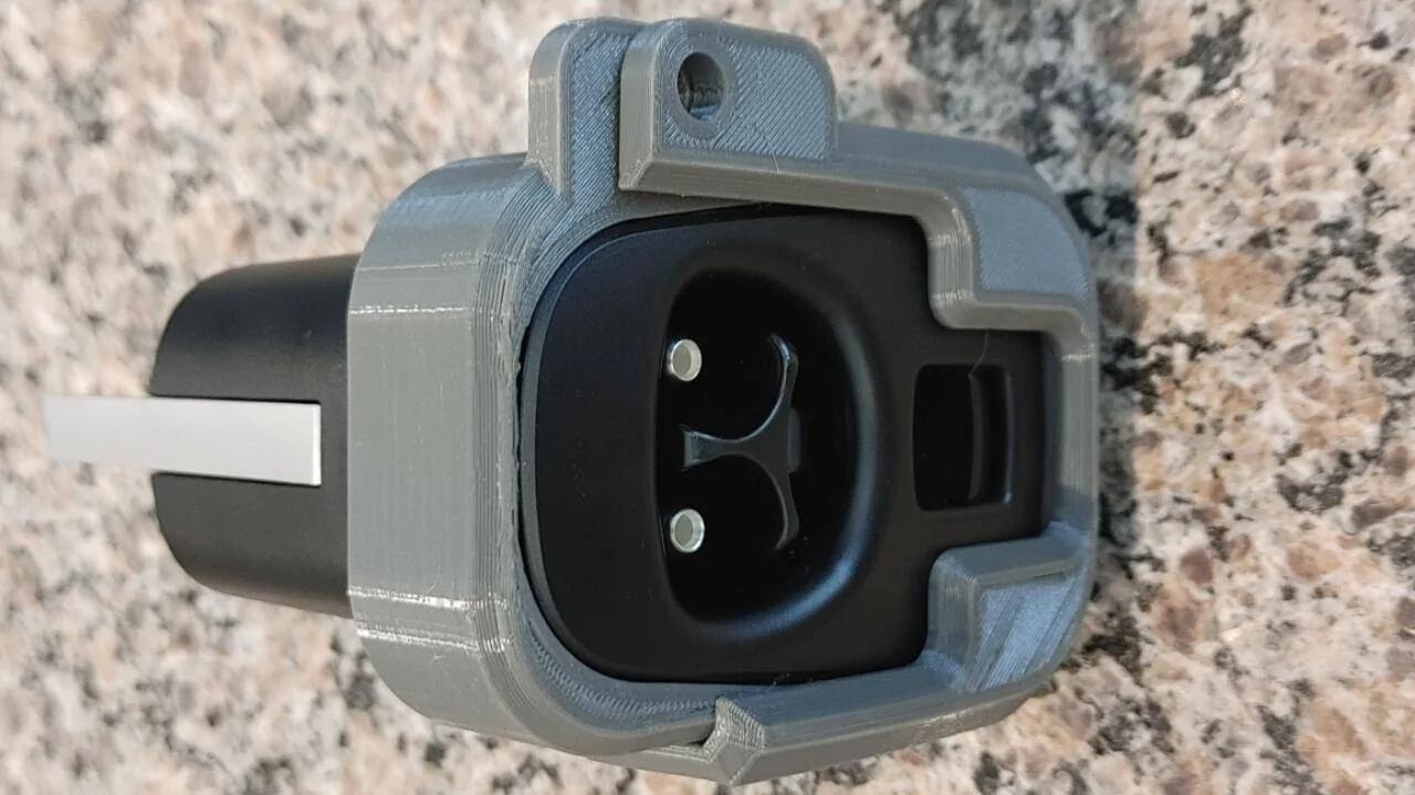

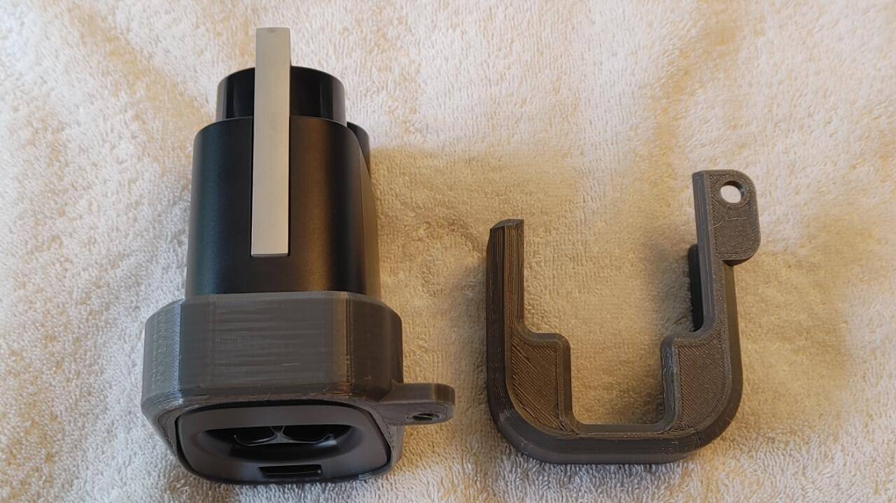

Here's my first attempt at 3D printing a lock for the adapter to prevent someone from just disconnecting the adapter and taking it while charging. It has 2 parts (plus a padlock). The inner sleeve that covers the release button is tapered to match the size/shape of the adapter. It has to be pushed on from the back side. I believe it's tight enough and strong enough so that it can't be pulled off the front of the adapter. Then the second piece slides up from the bottom to keep the sleeve from being pushed back. Lock together with a padlock.
I'm open to suggestions. This design does not prevent the locking lever from moving, but just prevents access to the release button. I don't believe you can pull the lever up when installed without some sort of hooked tool. Also, I left the release for the NACS plug exposed. That could be covered up as well, but thought it best to have a way to quickly unplug. I did consider some sort of hidden button lock (like a puzzle box), but thought that could be figured out. I plan to print this in black to conceal it somewhat when in use.
