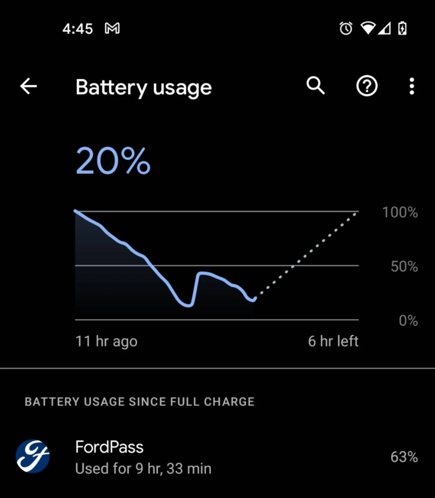

From around mid aug i have had this issue where ford pass app randomly starts draining my phone battery. Whatever the app is doing it gets so processing intensive that it even heats up the phone. I have to eventually kill the app to stop the battery drain, but then PAAK wont work till i open the app.
I was hoping with 3.30.0 update this will go away but haven't had any luck. I even deleted the app setup it up again to see if it would help but has made no difference. Was wondering if it was related to PAAK, so i even did setup the PAAK for few day (after reinstalling everything) but no luck.
It even has happened on days i have not even interacted with car (while my car was in service unfortunately.. but that's diff story)
Wondering if anyone else has been seeing this.
Ford pass App - 3.30.0 (have seen it in prev version too)
Phone - Android Pixel 4a 5G (running Android 11 /w Aug security patch)
Ford Mustang Mach-E Ford Pass draining Phone (android) battery Screenshot_20210915-164528

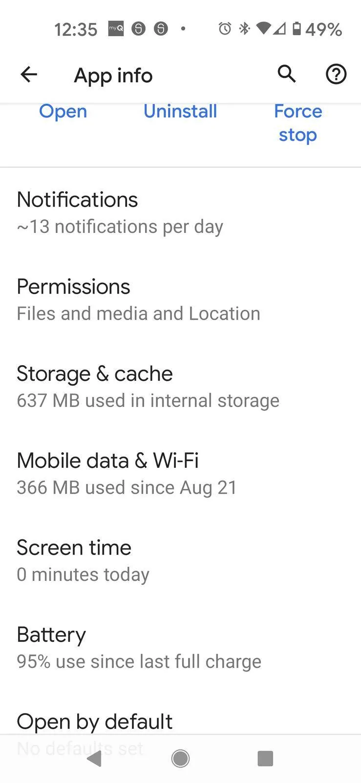

Today FordPass used a bit of my battery, quickly draining my phone below 50%...

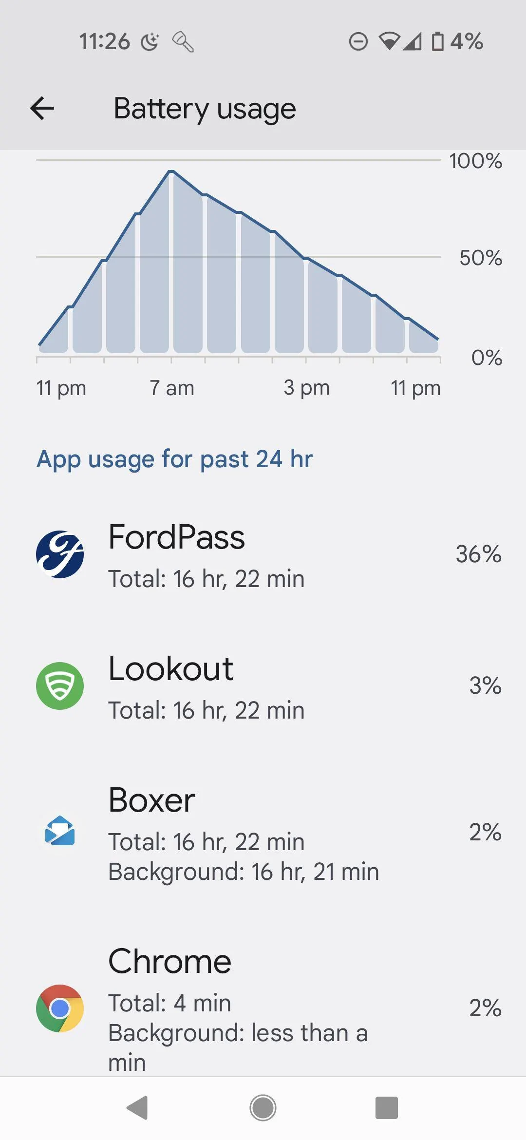

Noticed on Friday that my phone was near zero at bedtime, last night also. FordPass was the culprit yesterday, using 36% of my battery.
