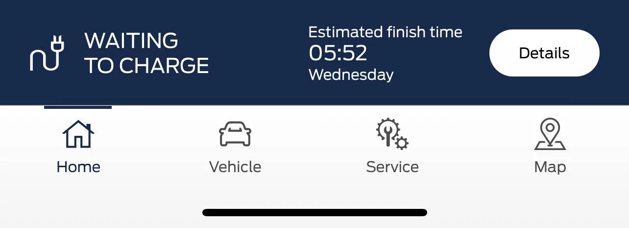

My car is scheduled to charge between noon and 4 pm HST daily. The pve system batteries are usually full by that time and the system is producing excess electrons.
I plugged the car in just before 3pm today when I got back from Kona. It stopped charging at 4 pm HST. This is what FordPass shows for when it’ll get to 80%
Ford Mustang Mach-E FordPass 4.27.0 Update IMG_4705
5:52 am tomorrow makes zero sense no matter how badly they’ve messed with time zone calculations. It’ll take a smidgen over 3 hours tomorrow to get to 80%.
I guess we know what they broke this time.
264
11,481
25,395
4 PM HST Tues is 02:00 GMT Wed (actual charge finish time). Time zone offset -10 GMT. Double that so -20 GMT. 02:00 GMT - 20 = 06:00 HST Tues (05:52 is close). Seems the day matches GMT?
I could be wrong, but applying the GMT offset twice seems to be the pattern (times are handled by the server in GMT and corrected locally).
