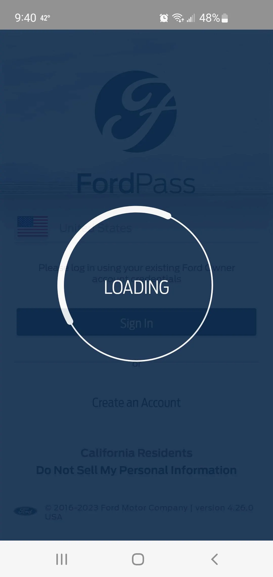

Everything is fine, nothing to see here....loading for 45 minutes........
In the immortal words of Steve Jobs; You are holding it wrong. It cannot be Ford's software that is not working right. Just cannot possibly be.
