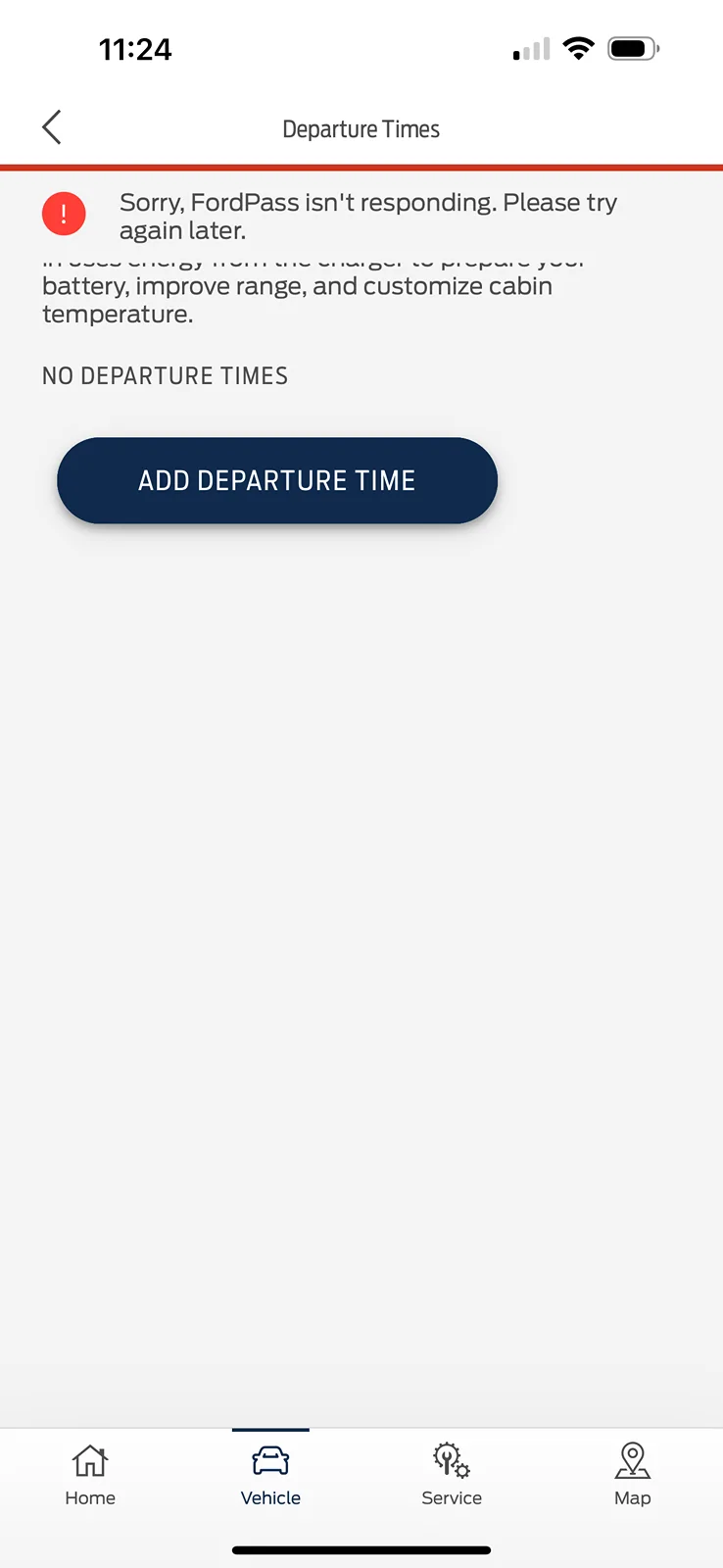

I have tried all of the trouble shooting tips except for deleting the app and starting over, and I could to use to get this message that ford pass is not responding. Worked fine for my first three days then all of a sudden I can’t program charging or departing times. Suggestions appreciated.
Ford Mustang Mach-E FordPass App Isn't Responding, Please Try Again Later IMG_4248

I've had an open ticket with FordPass support for two months now. I've reinstalled the app many times, performed two master resets, and no luck.
Workaround is to set those up in the car instead.
That’s not great news. But I guess I’m not the only one with the issue then.

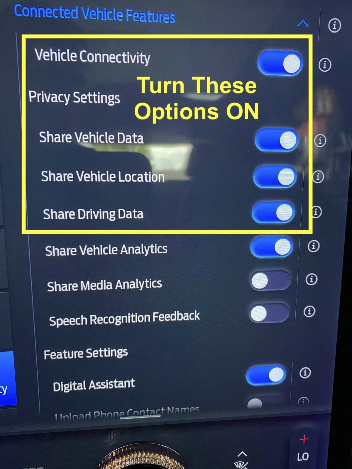

I got this one. You are in departure times. Departure times requires sharing your data with Ford. Try turning off connected services and turning them on again. You may need to delete your PAAK and Ford Pass and try again. Make sure you have Bluetooth on. Also you mast have at least 1 charge session to set some preferences. So if you recently reset your system, you must charge the car once before you can set charge levels or departure times.
Where do you turn off and on connected services? That option is not in my ford.com connected services page, and in the car I have flipped every connectivity and data sharing toggle multiple times.
11,365
25,026
Ford Mustang Mach-E FordPass App Isn't Responding, Please Try Again Later Connected Services Turned On
You might need to do a 12V reset on the car too (lift negative terminal) in addition to rebooting your phone.

Thanks @Mach-Lee . I performed a complete 12v reset, enabled all of the above data options, uninstalled and reinstalled FordPass on my phone. Deleted all PaaK, and reenabled PaaK, and I'm still facing the same issues.
Is there an order of operations I need to try if I were to do another 12v reset? Or is it time to go to the dealer? Thanks again for your help as always.
