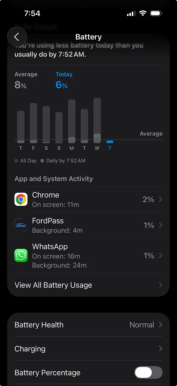

No issues here with iOS 18.7.1 and FordPass 5.28.0.
1% usage or less, even over 10 days 🤷🏻‍♂️

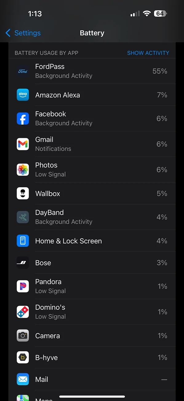

WOW! I'm on IOS 18.7.1 and just looked at my usage. I am in the process of upgrading to IOS 26, and I will see what happens.
Ford Mustang Mach-E FordPass High Battery Usage - iOS IMG_3137

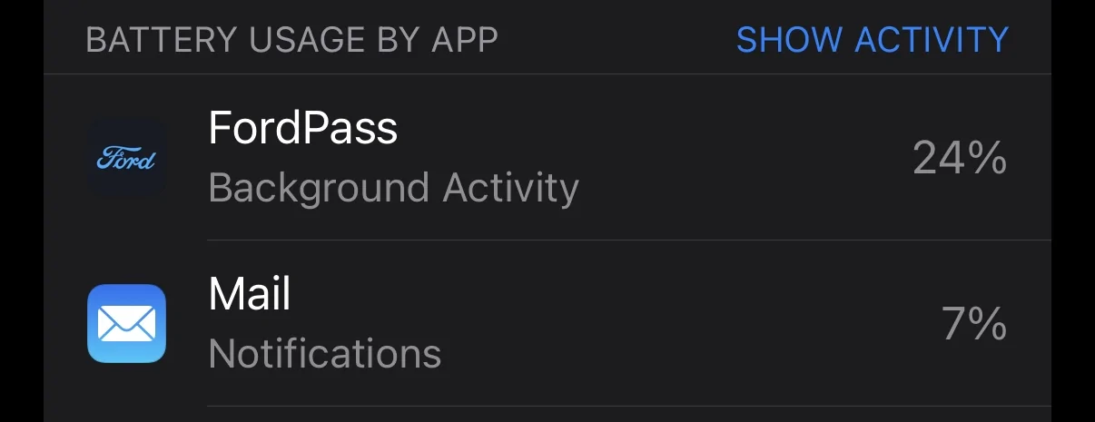

I checked and over the last week the app took about 10% of my battery on average. Not horrible but not great for just one app — especially since PAAK is flakey. Some days more some less. I’m not sure why. I do frequently walk near my car while in my house. Maybe there is some event or usage which causes the app to use more energy.
I also have the Apple Watch app installed with it on my watch face but I don’t think it does anything in the background since when the app is opened it takes a while for it to refresh.
You realize that’s percent of what’s used, not percent of your battery. If you kill all your other apps and use only FP, it will eventually show 80%, but it’s not using more battery.
I realize that, but I use many other apps a lot throughout the day, and the Ford app in proportion is using a significant amount. Even with my upgrade to IOS 26, Ford still ranks #1 in usage.

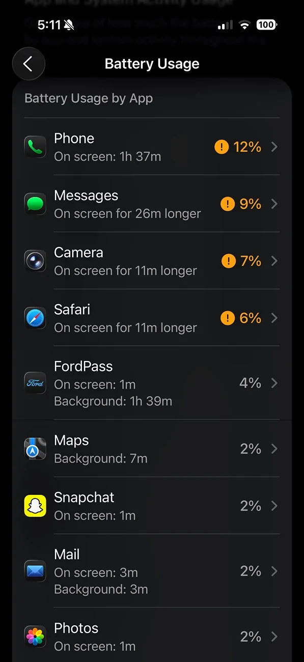

23% used. I updated to 26.2.1 earlier today. I didn’t even use my mache today.
