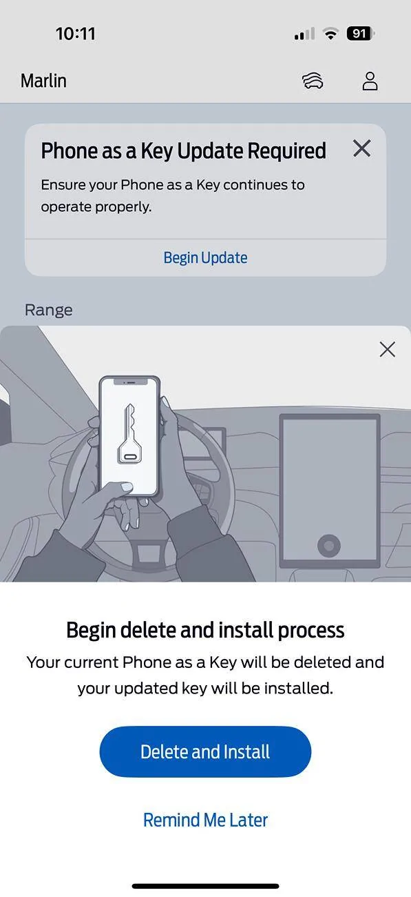

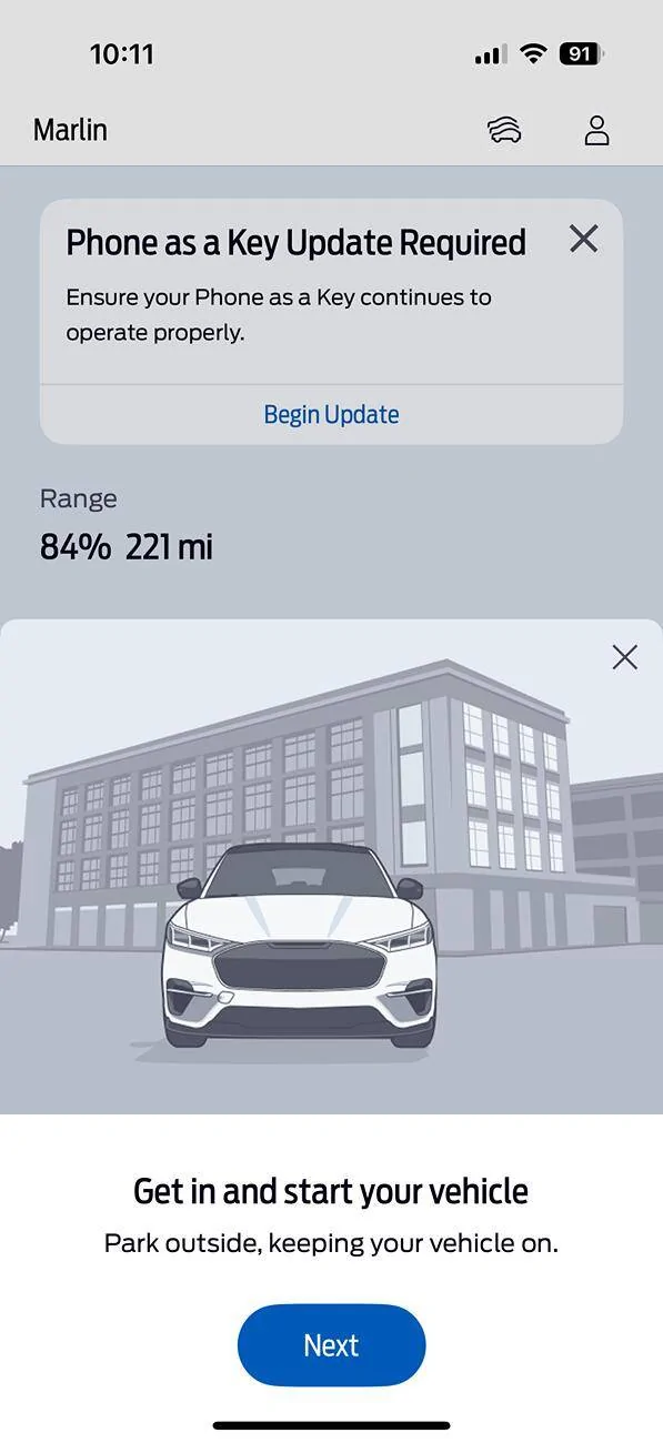

Got this a while ago and finally stopped procrastinating and ran the update this morning. It got in a failure loop after deleting the PAAK where it couldn’t pair back with the car. Had to reset PAAK from the center console (General->Reset->Phone As A Key) and then re-pairing succeeded . (Had to search the owners manual to remember where that reset was)
My theory is that I initially had ignored the do this in an “open area” as per part of the prompts and the cell signal was too weak in my closed garage, putting it in a bad state. That being said, failing to pair for the second or third time (after I pulled the car out of the garage) should probably have a “you should try resetting the car's PAAK settings” guidance.
