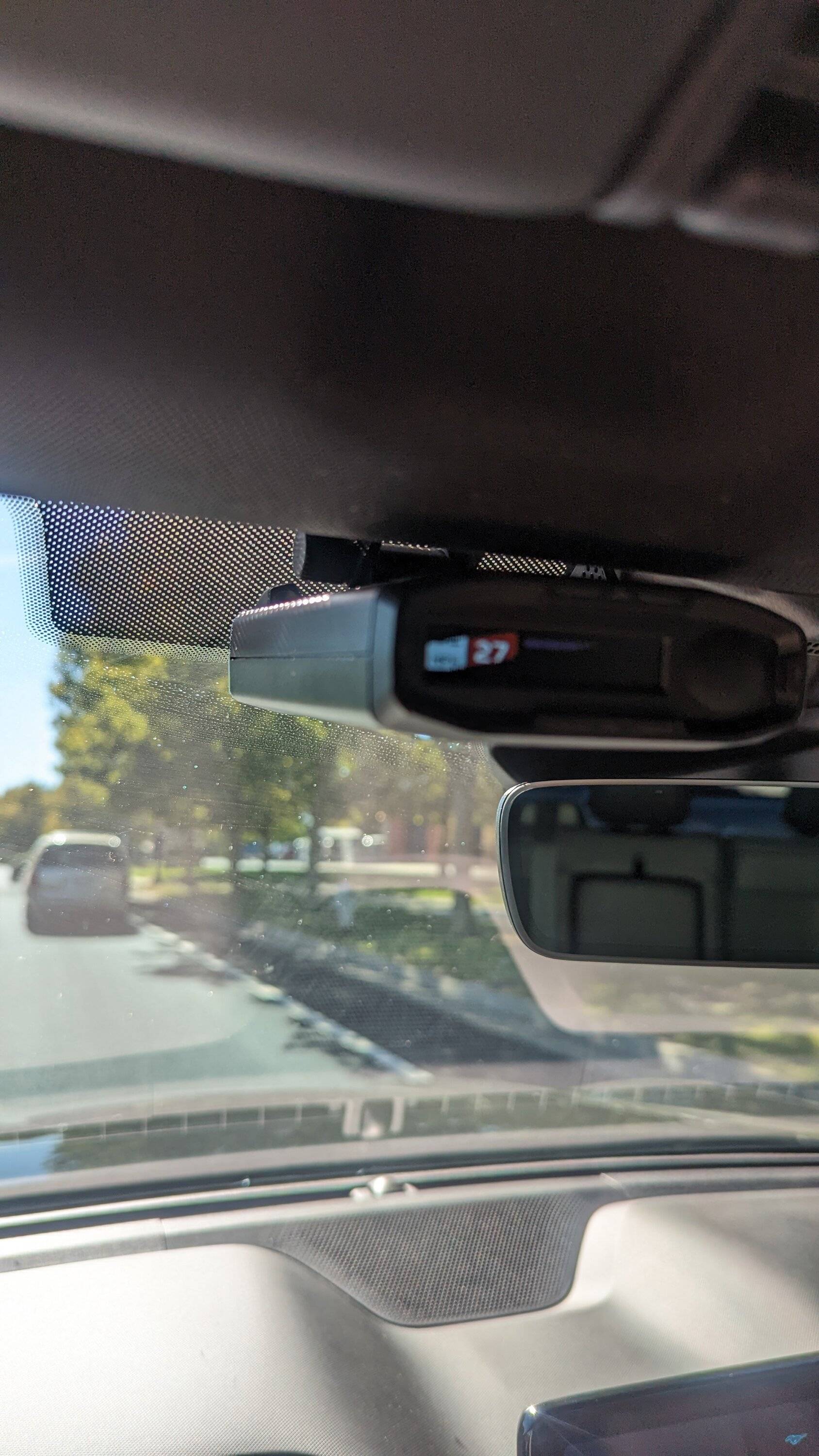

@DevSecOps Out of curiosity, which radar detector do you have? Hubs has the Valentine One (gen 1) and it's AMAZING. Trying to get him to upgrade so I can have his old one. Looking for other options in the meantime in case he says no.

Important to note about radar detectors. They have to go at the very top of the windshield in the black dot area otherwise they won't work well due to the IRR windshield. I designed a custom mount, also on the accessory page to accommodate this detector
Glad you finally have your vehicle back. Sorry to hear it was such a long process!
If you're looking for an alternative suggestion to the V1 or the Escort, I have the new Uniden R8.
It fits out of the box with their mount on the black part of the windshield, and it is spectacular if you're going to upgrade your radar detector. The R8 (and the slightly older R7) get great reviews. See here: https://www.vortexradar.com/2022/03/uniden-r8-review/
I have a Valentine 1 Gen 2. I use the mount on my sun visor to get signal through the black dots as Todd mentioned. I've had V1 detectors since 1998 and they have saved me a boatload of money in both tickets, stupidity and insurance. Regardless of having a radar detector, you need to drive smartly. One thing to consider is that there usually is that one person who will get the ticket. Don't be that guy. Learn where you can exceed the speed limits and where you cannot.

The nice part of the G2 is over the air updates via the phone.
The nice part about the newer escorts is that they connect to the wifi on the car, update automatically and there's social radar detection. If my detector gets a KA band hit, it publishes that to a database and any other detectors coming within the area will alert to my detector detecting the KA band within a time frame.
