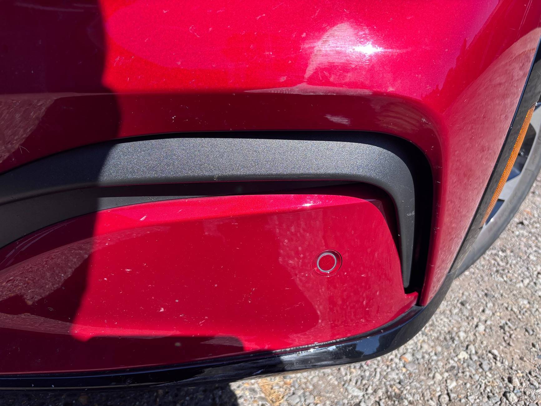

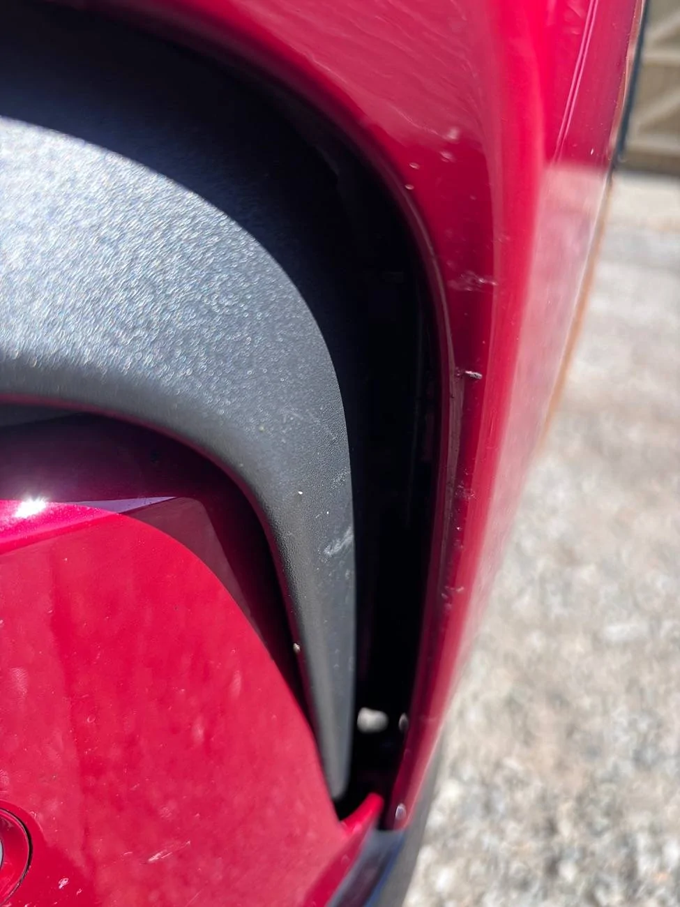

Hi. Following a small bump I noticed the black plastic piece in the photo had been pushed inwards and out of its clip leaving a gap between it and the metal bodywork. I tried to pop it out again but need to get to the inside as something is stopping it from popping out. Does anyone know how I would access the space behind this ?
Many thanks, Andy

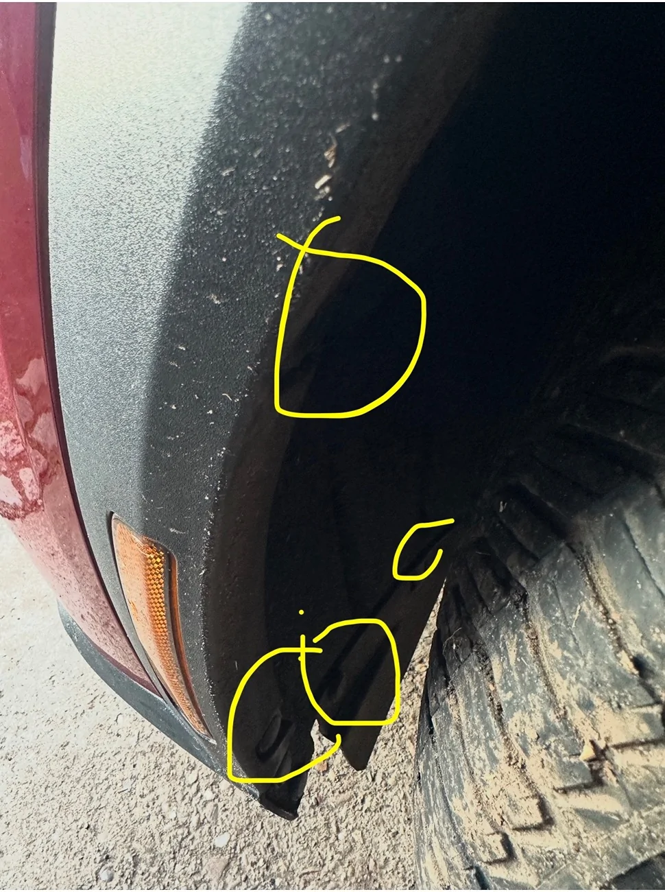

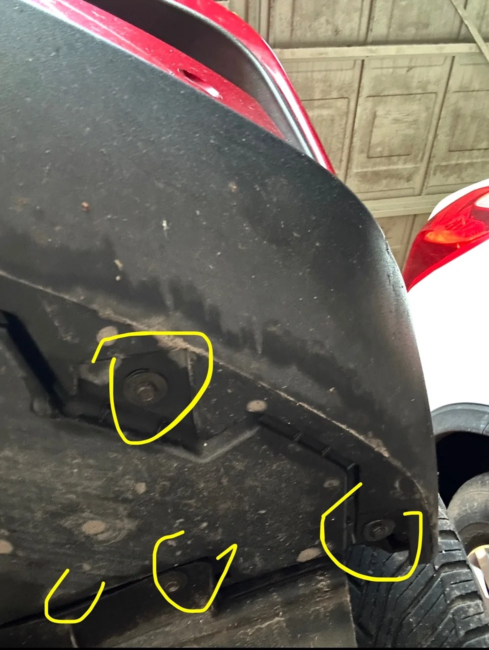

Look around the inside of wheel arch, the grey trim with the orange side reflectors fitted should be secured inside rim of wheel arch of wing by plastic clips with centre locking pins that need pulling out first, then pull the wheel arch trim with the reflector in it from the spring clips by pulling front to time directly out to the side and undo bolts under that corner of bumper to get into the wheel arch plastic insert shield and under shields .

Probably get enough access into corner of bumper to resecure those loose parts without entirely removing bumper.

Did you manage to get this resolved? Mine has the same issue. Wondering how much moulding I'm going to have to remove.

It is a little awkward, but you can get at it without removing the wheel. Turn the wheel, remove the stone deflector, fender moulding & the two lower splash shield push pins. Then you can get your hand in behind the bumper.
If it is anything like mine, there are probably some broken clips. Best I could do was push it mostly back into position. Damn snowbanks :sadface:
