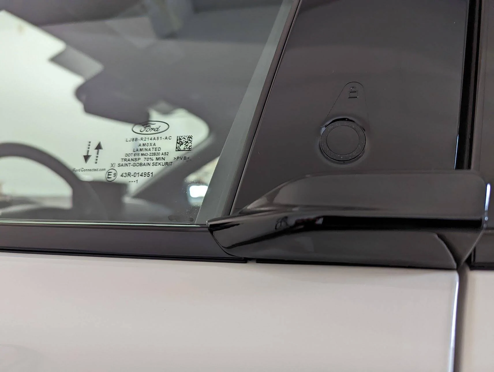

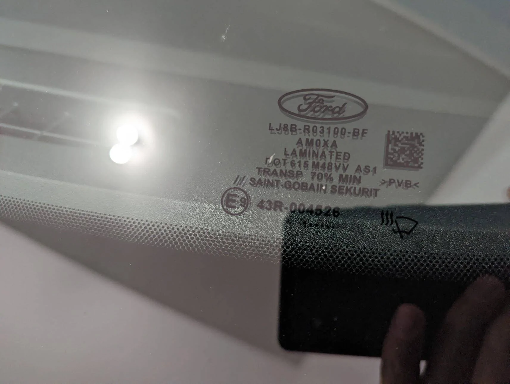

Here's the windshield and side windows if you don't have Pano roof.
Ford Mustang Mach-E Front Windows UV-Resistant? 1636044131822
Ford Mustang Mach-E Front Windows UV-Resistant? 1636044146154
Says PVB (Polyvinyl butyral) so that means it will block >99% of UV light. Infrared (heat) is different story if that’s what you’re worried about instead. UV and IR are different types of rays with different wavelengths and properties.
Oh, cool. So I don’t need to put UV blocking film on them. Less $$ to spend! ??
And yes, I am aware that IR and UV are on completely opposite ends of the spectrum. Not interested in IR, just UV (don’t want interior getting killed by the sun).
