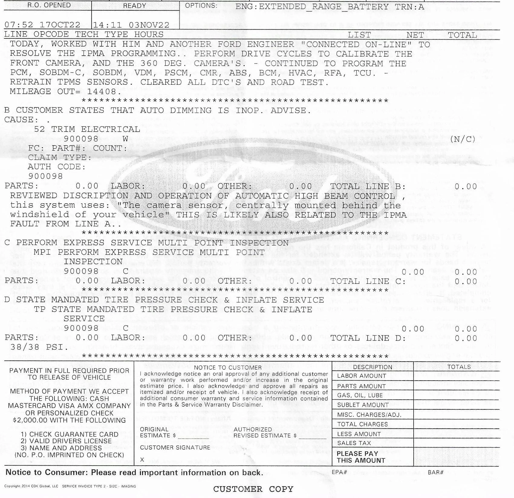

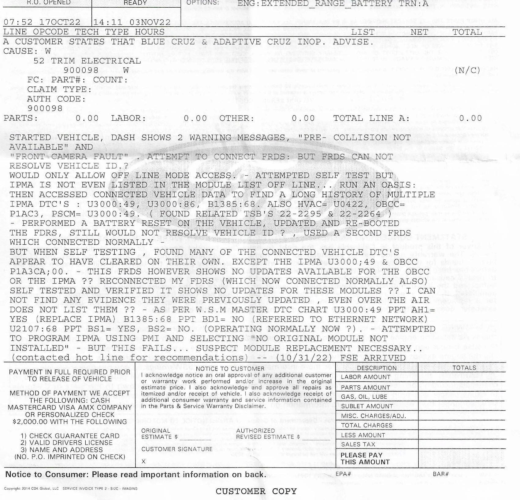

An update on my California edition Mach-E. It took about two weeks, but the Camara Fault problems seem to be fixed. Generally, the delay service seemed to be with the local mechanics having to work remotely with Ford HQ. I'm not even sure all that was done, but it seems to have been mostly software related.
Got it back today, and so far BlueCruise and everything associated with it are working perfectly. So far... Of course I'll be on pins-and-needles for a couple weeks hoping there's no relapse. And if there is, I'll let you all know. But so far so good.
An update for you all.
I took the car in on 11/17/22
It was repaired on 11/31/22
As of 11/07/22 it is still working perfectly. No cameral fault messages. Blue Cruise working as it's supposed to.
My understanding is that most of the repair was "software stuff". The local service manager could only tell me so much as most of the work was directly remotely from Ford engineers, often via email exchanges. I am attaching the pertinent portions of my service receipt. Most of it is gobbledeegook to me. But it may be helpful to some of you.
Ford Mustang Mach-E Front Camera Fault & Pre-Collision Assist Not Available Errors 11-03-2022 Service_01
Ford Mustang Mach-E Front Camera Fault & Pre-Collision Assist Not Available Errors 11-03-2022 Service_02
Well, do you want me to let you down easy or just give it to you straight ? Maybe you will have better luck, but that's essentially the same exact "fix" that did not work for me and several others, e.g., run through TSB-22-2295 and replace the IPMA and/or IPMB. Please keep us up to date on whether it somehow sticks for you.

Oh, I'm well aware that this is the same "fix" that didn't work for a lot of people. So, I'm on high alert for the next few weeks. But so far, so good. Keeping my fingers crossed. If things go sideways, you all will be the first to know.
