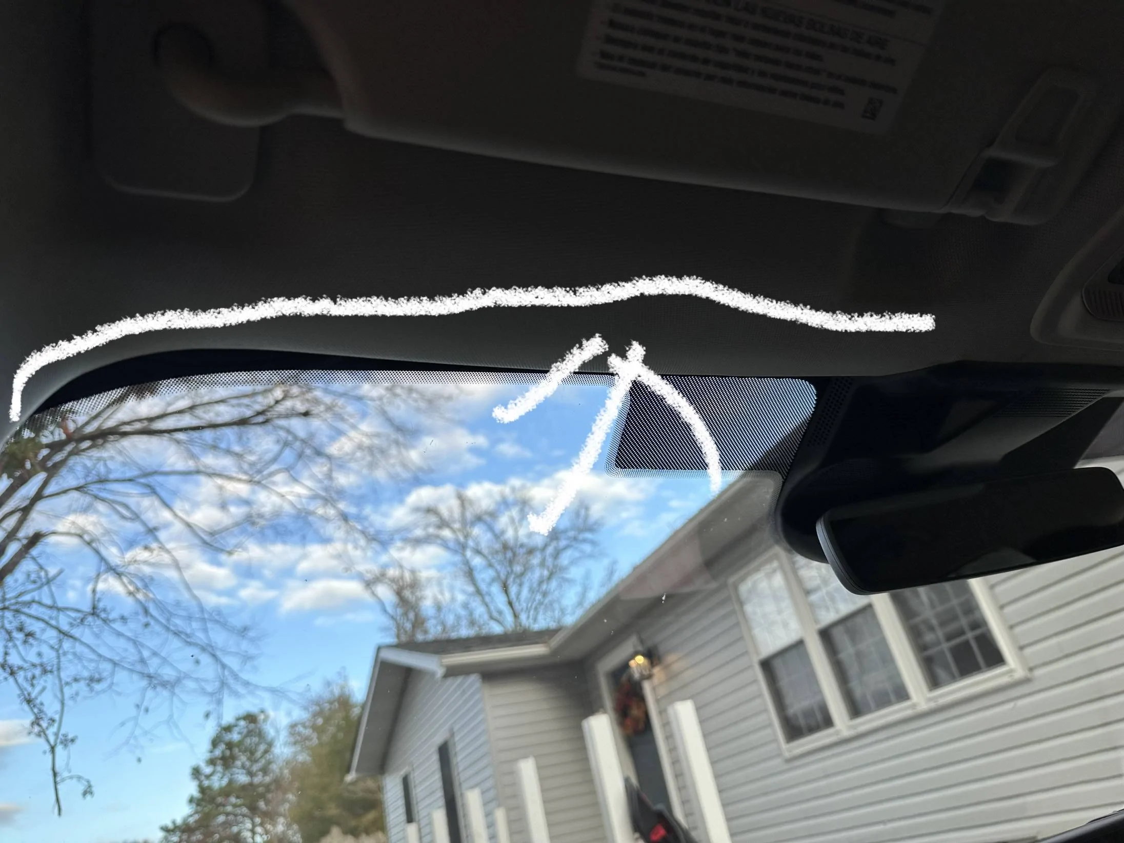

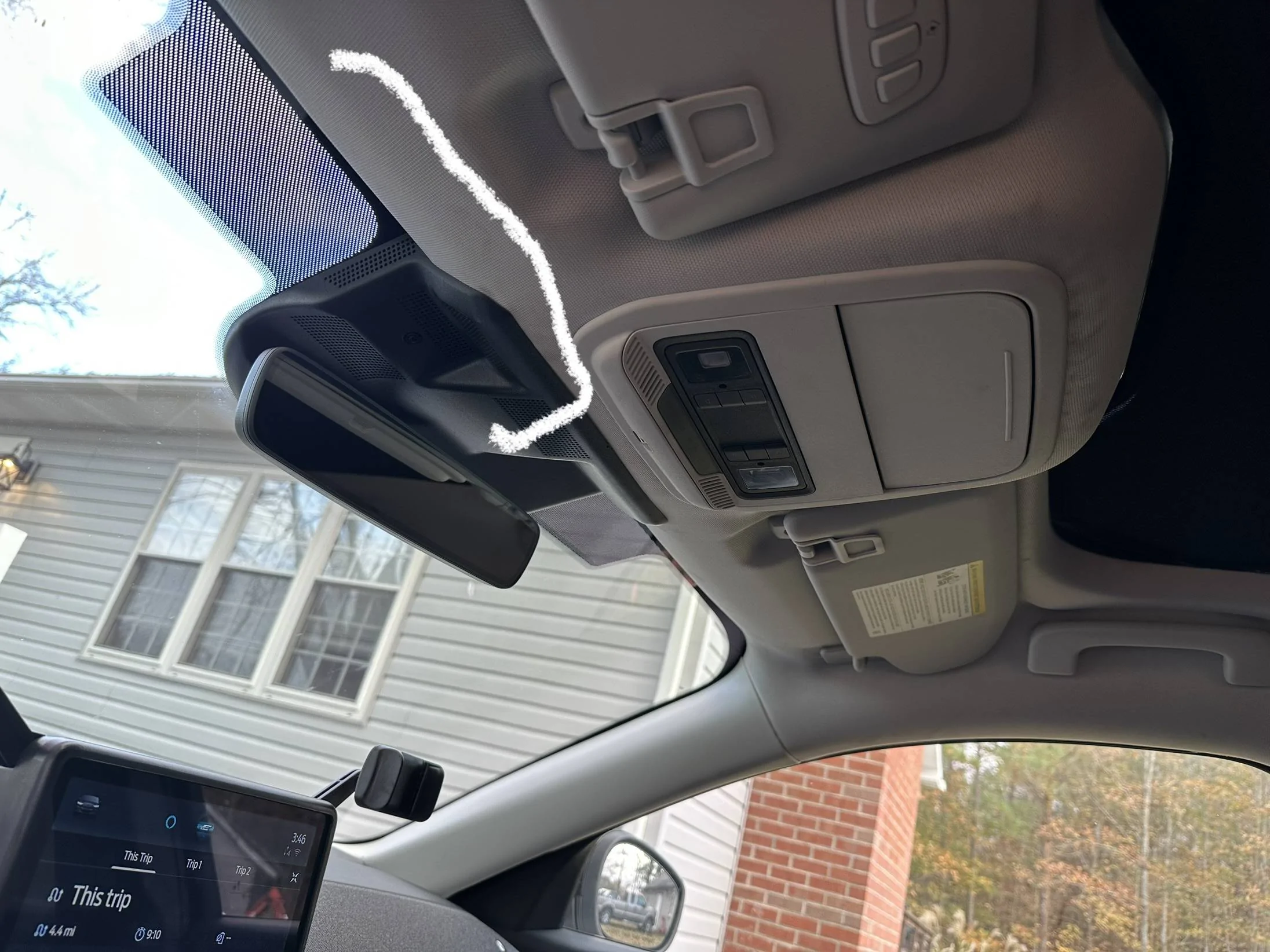

Mine is faulting in the same manner. Thank you Tug for finding all of this. Months with this malfunction and weeks in shop.
Now not only did the windshield/roof recall lead to replacing $2000 in trim pieces due to tech mishandling, but it likely caused this issue and the loss of use of a brand new car for months.
Just lightly tap on the front of the headliner with the car on and ready and see if the fault occurs. The arrow is about where mine had a problem. The cable is wrapped in harness with other wires and then glued to the headliner.
