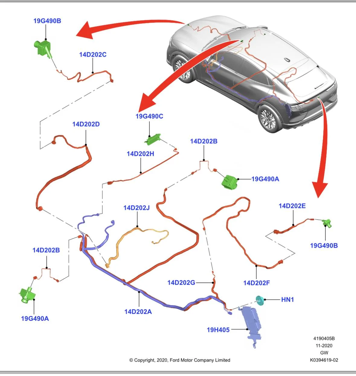

14D202H in the picture is the part.
Is that the _only_ part that might have potential issues? E.g., this post
They are not all in the same location, some are further towards the rear along the harness
Seems to hint there are downstream locations as well.
And, I'm also super curious how IPMA / IPMB replacements and "TSB 22-2295" software reset sequences seem to change from perma-fault to occasional-fault?

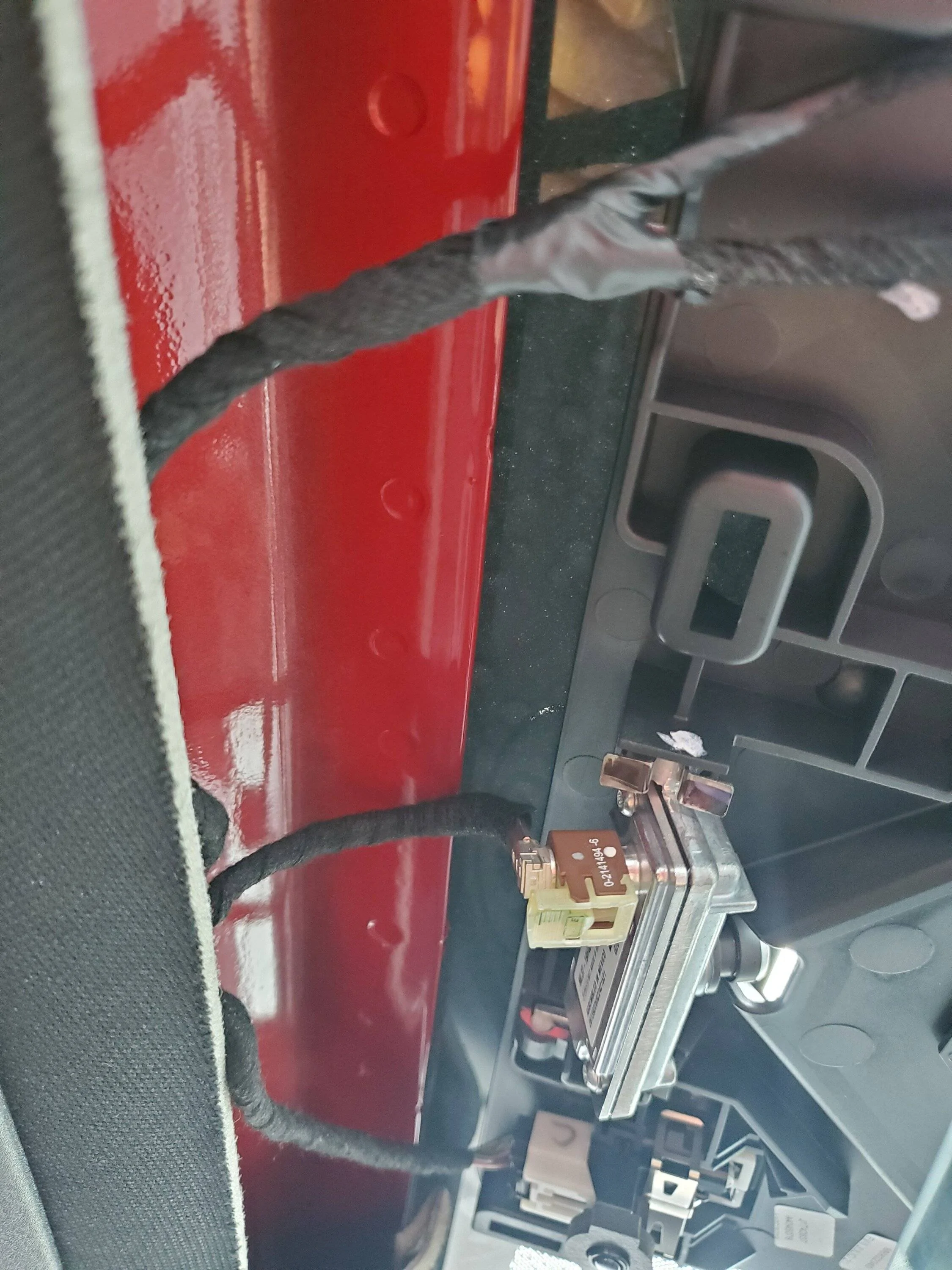

Update: A Ford field engineer finally checked out my car today and instructed my SA to order the FC coaxial cable/harness assembly. I assume it's just the initial headliner/A-pillar run only. I didn't get any more info but did inspect the car myself on Monday and started it up. No faults on the driver IPC. So, this is good news after 30+ days in the shop on repair attempt #3! Uggggggg.
Ford Mustang Mach-E Front Camera Fault & Pre-Collision Assist Not Available Errors 20221107_084507
Ford Mustang Mach-E Front Camera Fault & Pre-Collision Assist Not Available Errors 20221107_084548
11,351
24,978
I don't like that cable routing, the connector should come off the camera at the 9 o'clock position instead of the 11 o'clock position so it isn't being bent sharply or touching the windshield. Maybe that's why they want to replace yours now.
For those that don't know, coaxial cables are fragile and should never be bent sharply. All turns should be gradual with a large enough turn radius. Bending a coax cable sharply permanently damages it. That's not a design flaw, that's just how coax cables are. These intermittent cable faults are likely going to be due to improper cable handling or routing at some point in the past, either during assembly or during previous dealer work. Most mechanics have zero clue how to handle a coax or sensitive data cable properly, so it would not surprise me if many were damaged during the glass recalls when the windshield was removed or the headliner dropped.
I also want to reiterate that some pre-collision faults are software related and not hardware related. Cable faults are only one cause of many.
