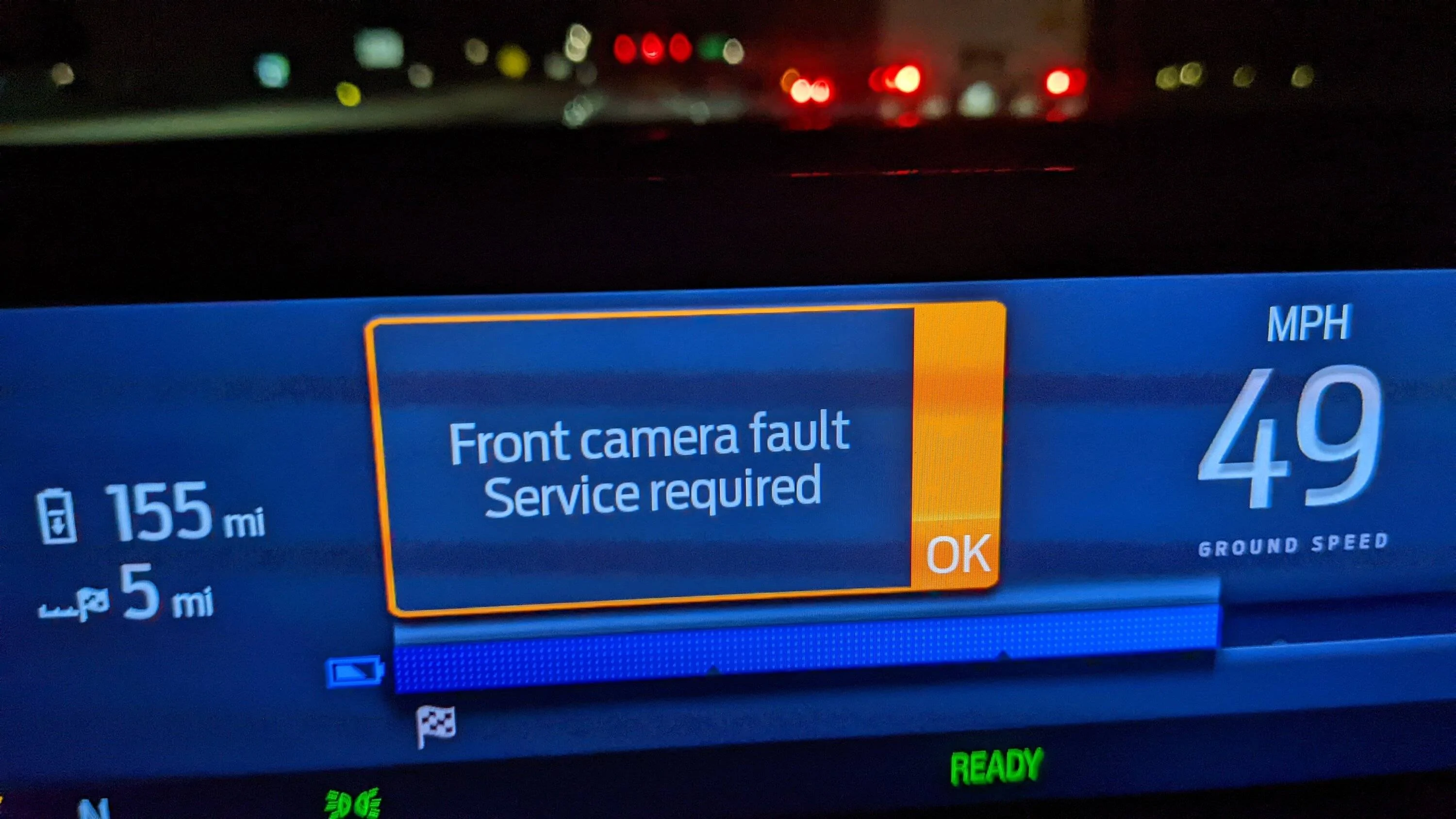

Add me to the naughty list ... :(
Pretty much exact same symptoms as being described. Initially we randomly go the error but it quickly went away for maybe days. Then, over time, we get the message more and more. I just dropped of the car at the dealer to diagnose, and on the way during the 15 minutes it came on 5 times. Seems like the common symptom is it just keeps getting worse until is stops completely.
