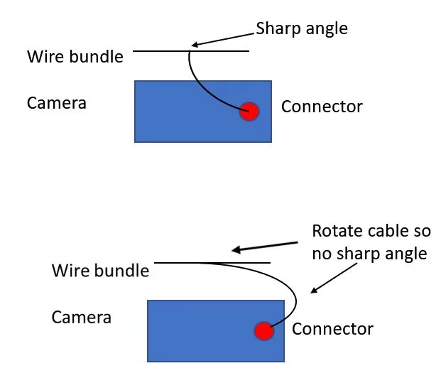

Quick update: Using the tools suggested I was able to easily and safely pop off the camera cover and adjust the cable. I drove from my house this morning into Phoenix for a meeting and back, about 70 miles round trip over bumpy rods (and while not yet hot, the temp was indicated at 85 on the way home.) No front camera faults and the CC worked great. This is the first drive I have taken in months without a camera fault. Thank you for the tips!
While I did not snap photos (because I forgot) below is a quick sketch of what I did. The camera cable exited the camera to the left but then was sharply bent where it entered another wire bundle. I simply rotated the cable so it exited to the right and had a smooth entry into the wire bundle.
We are driving up to Vegas on Thursday and that will be the real test.

Final update from me unless the errors return: After the cable re-route I described above and which was suggested by member @SnBGC we enjoyed a drive from Phoenix to Las Vegas and back over the weekend with NO camera faults and cruise control and lane keeping functions working perfectly. It's the first time in over a year that I've driven the car without these errors. I had almost forgotten how enjoyable a long drive can be in the MME.
If you get the front camera fault errors, doing this easy repair is highly recommended.
