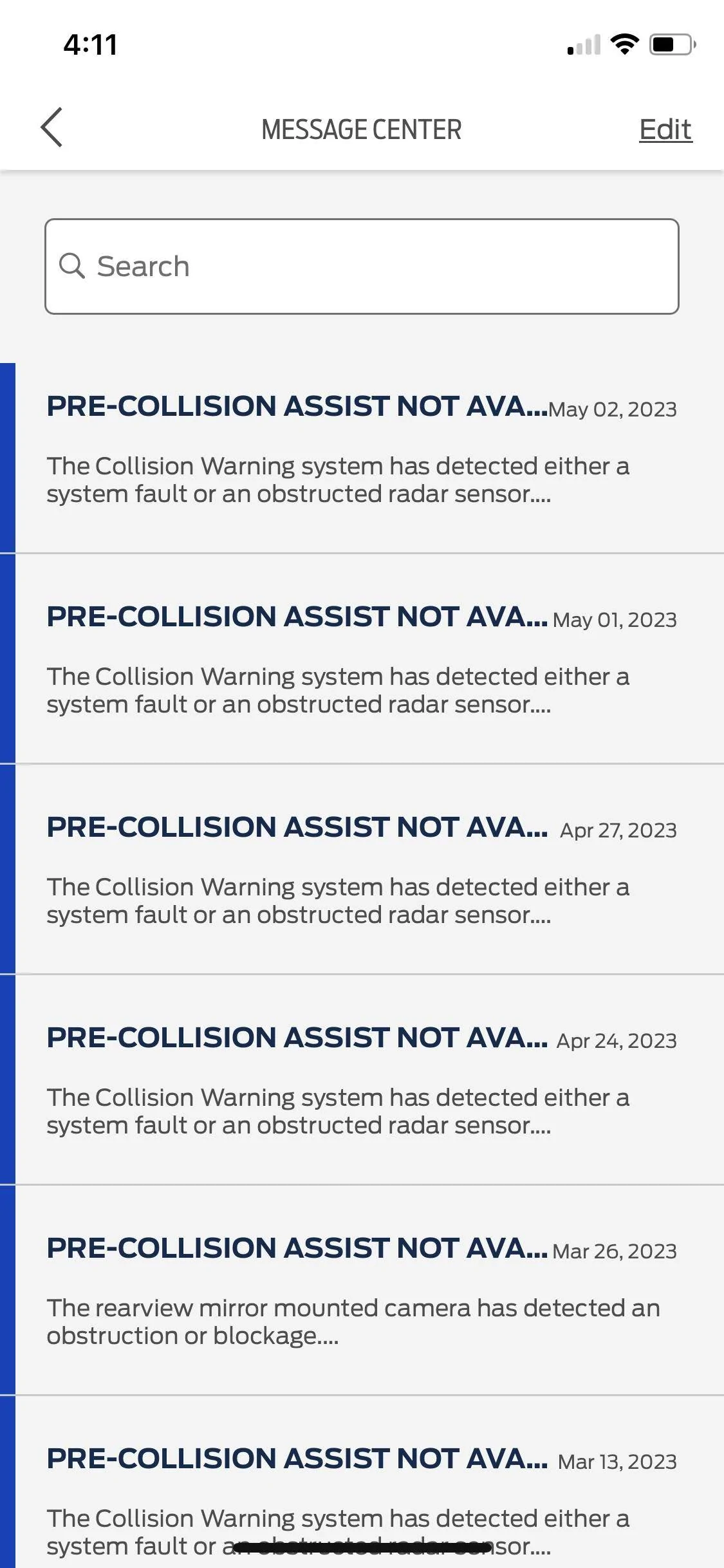

I have this issue on and off. Went to dealer replaced ipma module and front camera. They billed 2800 Ford cover 1900 rest I have to pay. They have 8 year 60000 electric warranty. I don’t know, this is bs. Ford is always be fix or repair daily…

Yes, 100000 miles. I have 49000 miles and problem started since they replace windshield. They said even though problem started during warranty period but problem still exist after warranty period. All repair made after warranty period , they cover partially. Also if the problem still does not fix. You have to pay for next part replacement if it is not replaced in replaced previously

.... problem started since they replace windshield. ....
as did many others.
I am convinced that techs messing with the windshield running tools around the edges *probably* pull on the mini-coax cable pretty hard, and in some cases the resulting strain *may* create sketchy signal.
I'd say chances of fixing the problem simply by wiggling the connector, and rotating to relieve the strain, are just as good as replacing the camera.

3FMTK1RM4NMA13806 we have been getting this also. and the closest dealer to us sux balls. everytime we take one of our fords to them something is wrong with the service. front camera ans pre collision unavailable
try checking the connector yourself.....
- pop off the black cover (5 clips)
- rotate the coax cable/connector around to relieve strain
- pop cover back on
- clear codes either with ODB2, or hard-reset by disconnecting 12v fuse or battery for 15 minutes and re-connecting.

dtc pulled
have you tried self-fix ?
- pop cover off front camera above rearview mirror. 5 clips
- rotate mini-coaxial cable around to relieve stress and sharp bend
- push in to make sure connection is seated
..... and .... clear DTC to see if you get another error.
