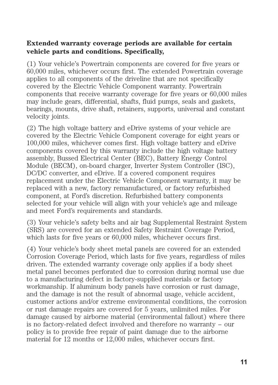

Link to warranty.
Some of the relevant bits:
5/60
Your vehicle’s Powertrain components are covered for five years or 60,000 miles, whichever occurs first. The extended Powertrain coverage applies to all components of the driveline that are not specifically covered by the Electric Vehicle Component warranty. Powertrain components that receive warranty coverage for five years or 60,000 miles may include gears, differential, shafts, fluid pumps, seals and gaskets, bearings, mounts, drive shaft, retainers, supports, universal and constant velocity joints.
8/100
The high voltage battery and eDrive systems of your vehicle are covered by the Electric Vehicle Component coverage for eight years or 100,000 miles, whichever comes first. High voltage battery and eDrive components covered by this warranty include the high voltage battery assembly, Bussed Electrical Center (BEC), Battery Energy Control Module (BECM), on-board charger, Inverter System Controller (ISC),
DC/DC converter, and eDrive. If a covered component requires replacement under the Electric Vehicle Component warranty, it may be replaced with a new, factory remanufactured, or factory refurbished component, at Ford’s discretion. Refurbished battery components selected for your vehicle will align with your vehicle’s age and mileage and meet Ford’s requirements and standards
This only confuses me more.
It sounds like Ford did a copy/paste from their gas vehicle languages.
We don’t have a lot of the “may include” things on that list.
And if the electric motors aren’t a part of the powertrain, I don’t know what is. The eDrive is definitely listed in the 8/10 you posted.
For the 5/60 there doesn't really seem to be anything we have listed that's not also an ICE thing, but in the 8/100 there is.
High voltage battery and eDrive components covered by this warranty include the high voltage battery assembly, Bussed Electrical Center (BEC), Battery Energy Control Module (BECM), on-board charger, Inverter System Controller (ISC), DC/DC converter, and eDrive.

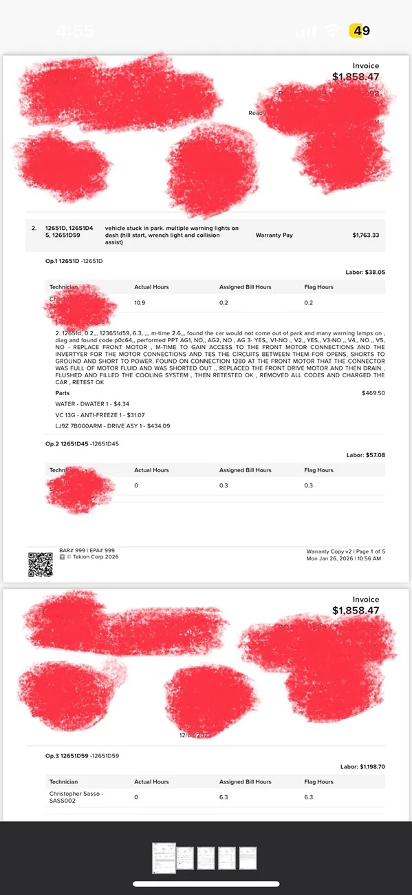

The invoice image I posted has a bit of wording describing on what was wrong. It seems like it was different than yours:
Connection 1280 was full of motor fluid and was shorted out
I'm just hoping this doesn't happen again at 94k miles, and lasts longer than the 47k miles I got
So I think it’s different and same, you also had a seal fail. The electric motor should not have diff fluid in it. Your just failed internally vs externally.

Just wanted to share an experience with my 22 Mach E California Route with 47k miles.
the front drive motor failed in the freeway.
Dashboard started giving lots of warning signs. Pulled aside and tried restarting the car but I could no longer drive it after that. It would only stay in “Full Accessory Power” mode. Attach video later.
Used FordPass towing, which took two hours to tow to dealership, free.
I’m out of the regular warranty but luckily transmission warranty was still good to cover this. If I didn’t have warranty cost would’ve been $1850. Attached details about repair.
The part was in back order so it took 3 weeks to repair. I had a regular Mustang coupe loaner for the meantime.
it’s scary to have this type of breakdowns with no idea what the repair entails nor the price it would cost until it’s diagnosed by the dealership.
Anything to do with the drive train is covered for 60k miles. If you insure your car with Geico, you can obtain breakdown insurance for very very cheap and be covered for 7 years or 100k miles with only your comprehensive deductible. Or it maybe just $250 deductible.
kens
Ken
Jan 27, 2025
419
432
IL, USA
2022 GT
Ford covers the electric motors for 8/100.
