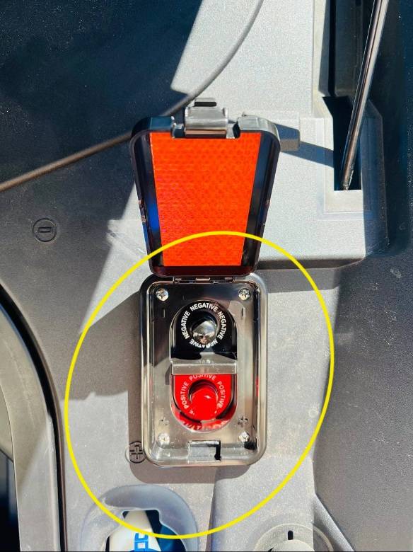

I'm pondering following in your wake on extending the AGM battery posts with a weatherproof receptacle. And making access available in the driver's side wheel well?
The sole intention is to eliminate the catch 22 the Mach-E has for accessing the battery if the battery is dead.

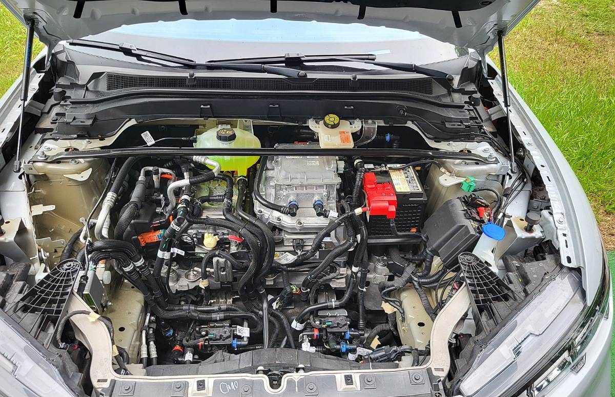

I leave those covers out except the one above the 12v battery, so I can conveniently check battery and motor coolant level. I also have drilled two access holes to the jump points. That way I can leave that cover alone. I don’t see why the other two can’t be left out.

This didn't take me but a few minutes to accomplish the first attempt.
It will take me much less time the second occasion. Easily less than 10 minutes, still using soft-hands to avoid damaging anything.
But, how many clips needed to be fished back out from said spider web of underhood stuff? No matter how hard I try i lose at least 2 each time and have to go fishing.
In all of my frunk tub in and out exercises I have found missing exactly two clips between the 2021 and 2024 (and I am pretty sure that the one that was missing from the 2024 was simply missing and not lost since I didn’t hear or feel it release). Are you being a mad brute with the beauty panels Erik? ??

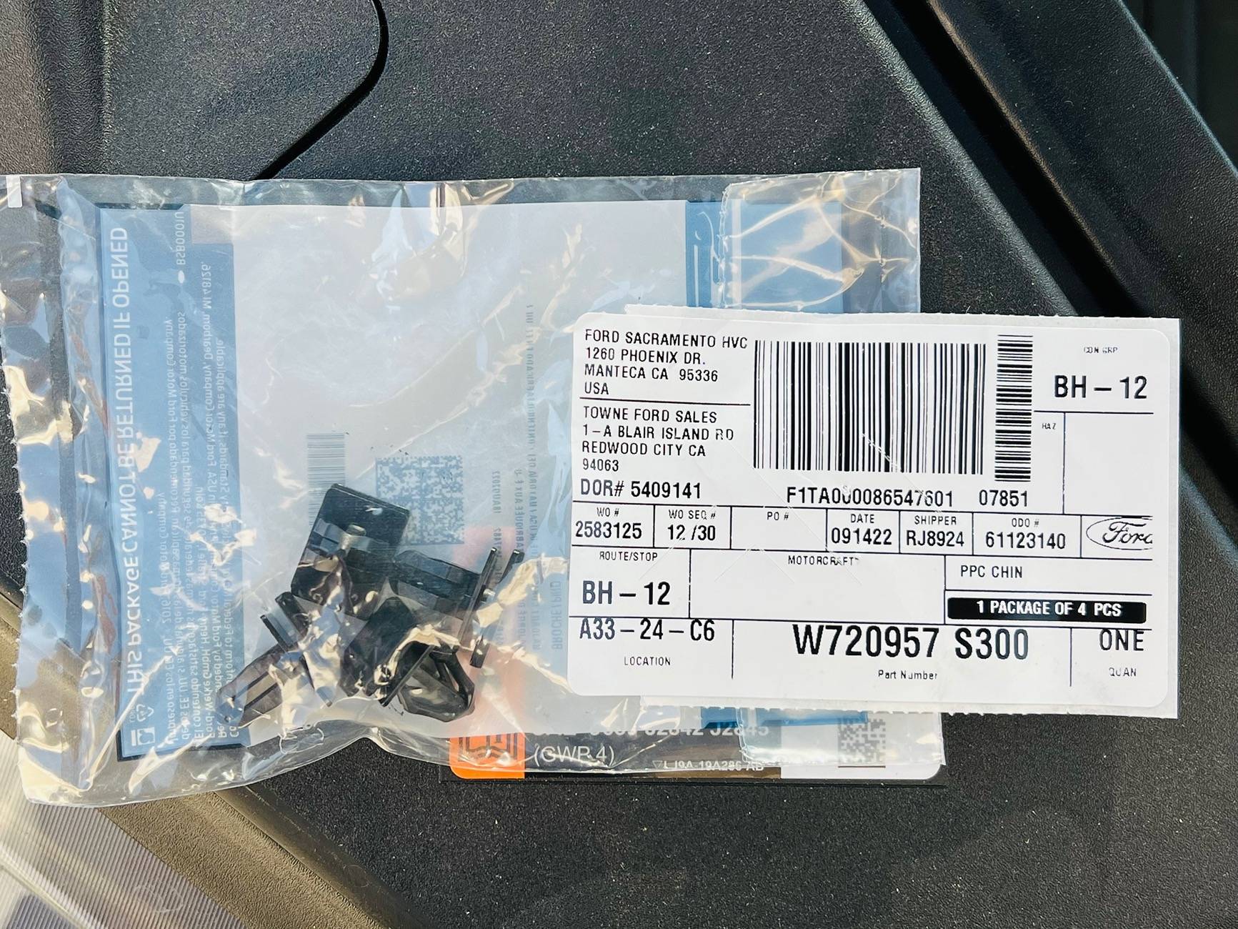

Is there a place to purchase replacement clips when I invariably break and lose them ? I’d like to be proactive about my failings.
12,974
17,450
Your Ford dealer? They sell them in 4 packs. ??
