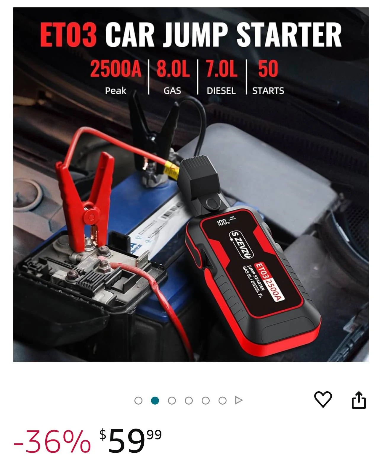

I wonder if something like this would work. https://a.co/d/jbfGWne
Might try it and let yall know.
I forgot to ask, but that doesn’t work even with a jumper box, unless the batteries dead you can’t just connect jumper cables to that connector behind the bumper and it’ll pop open, correct? The battery has to be dead, right?
Correct. And even then, the jumper box needs to have an override function.

I’m not sure what you mean on the override that battery example that I’ve got should that suffice?
Most jumper boxes have a built-in safety function that requires some voltage before the clamps are energized. This is to prevent you from touching them together or connecting them to the wrong terminals. The better ones have an override button that let‘s you disable that safety feature, which would be necessary if the 12V battery was completely dead. That override is also necessary to pop the frunk since there is no voltage on the bumper leads. I don’t know if the one you have has that function.

I don’t know if that feature is in there, but here’s a safety write up of that jumper.
  • 10 INTELLIGENT SAFTY PROTECTIONS: This jump starter battery pack is super safe to use with 10 intelligent safety protections against overcharge, short circuits, reverse polarity, power surging and sparking, and so forth. You can detect the errors by simply checking the lights and the beep sound from the smart jumper clamps.
