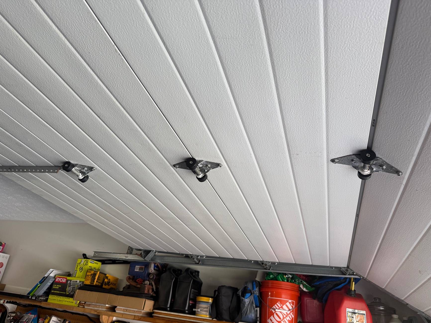

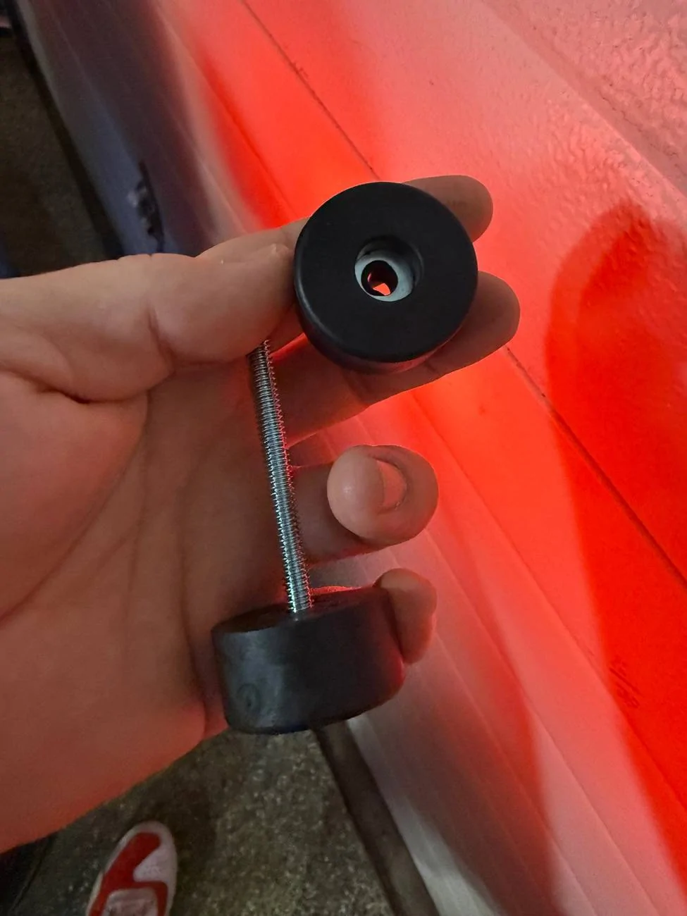

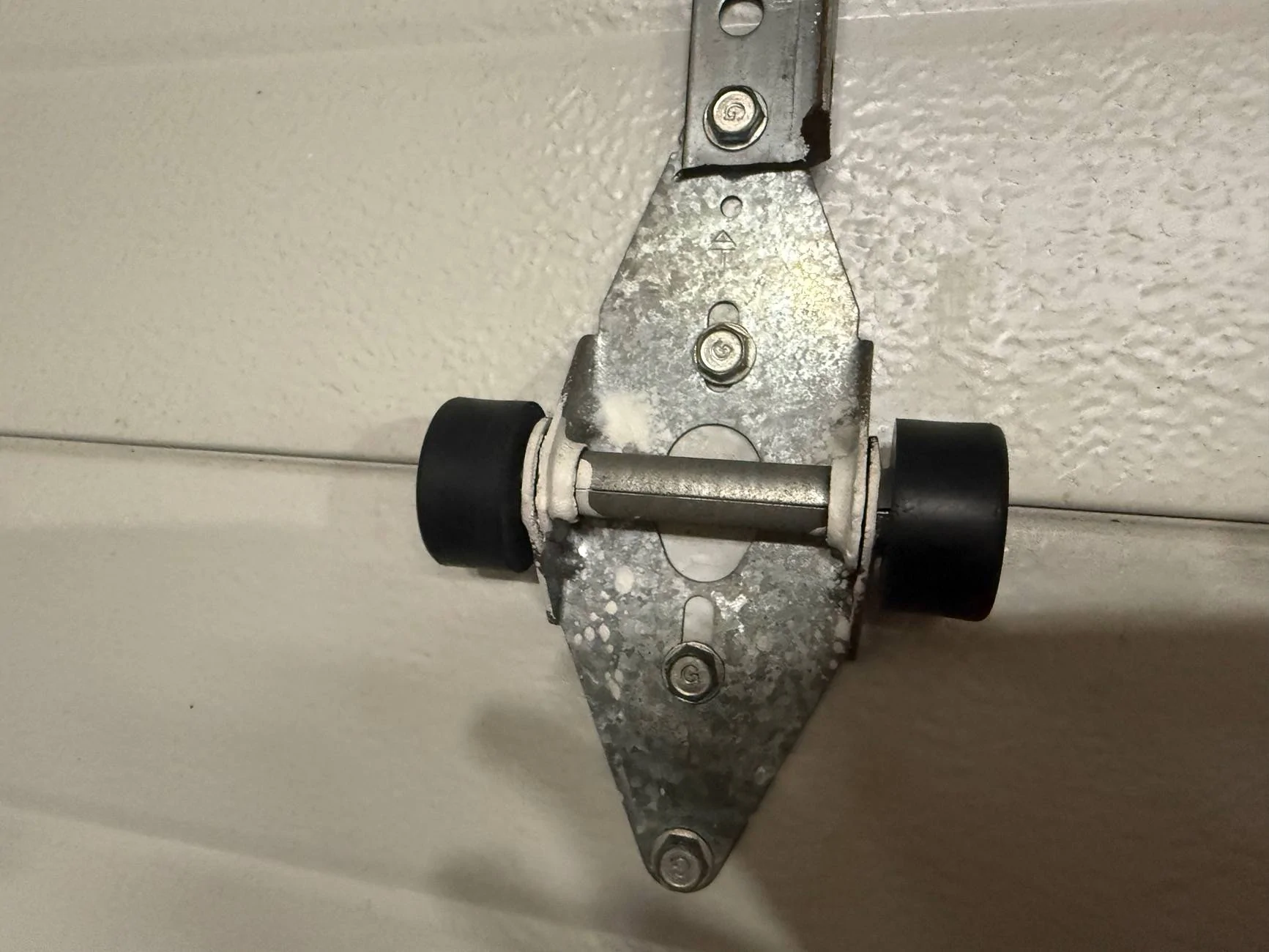

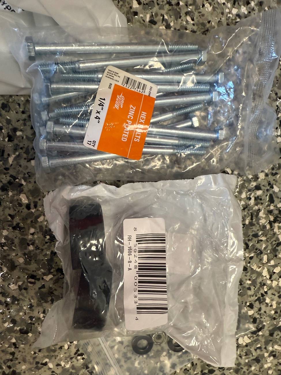

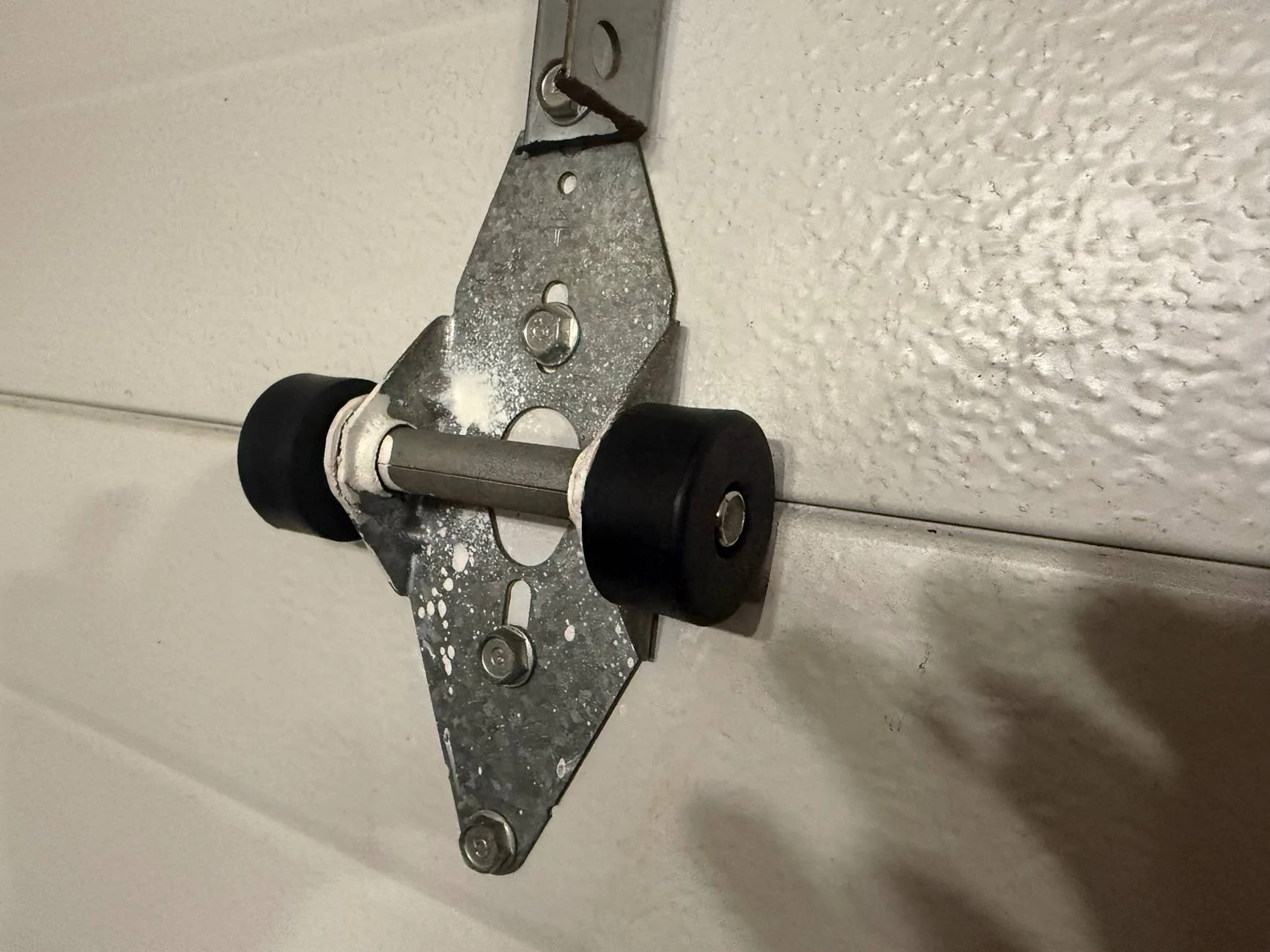

So I have a life hack for everyone!
So this is a common issue obviously. It happened to me several times in my 2021 GT PE.
There were several scratch gouges down the backside. These were from the hinges.
It opened randomly upon walking up as well approaching from the front. Just random.
I was going to look into trying to turn into warranty but I ended up trading it in for a 24.
So far, the new one has not done this at all. So I am guessing it has been addressed.
That said, I didn’t want to take any chances. So I came up with a cheap and easy solution to protect the car from the garage door hinges.
These rubber feet/stoppers can be purchased on Amazon. They have a width of 1 and 1/2 inches. They have a built in washer and 1/4” bolt hole. $7.29 as of this writing. However, the size is most important, not where you buy them or comparable. I am guessing you guys will buy them all out of stock when you see this. lol.
https://a.co/d/79fBhT8
From there, you need some long hex bolts 1/4 inch diameter. With a length of 4” minimum. 4 and 1/2 is better. I ended up with 4” and the worked but the threads could be a tick longer.
So then, you just need some 1/4” nuts.
I purchased the hardware at Menards for about $4 total.
So for a little over $11 you can do this and protect from any accidents like that.
The key is, these do not bind the door or cause any issues. They simply provide a barrier between the edge of those sharp door hinges and can spin and roll.
