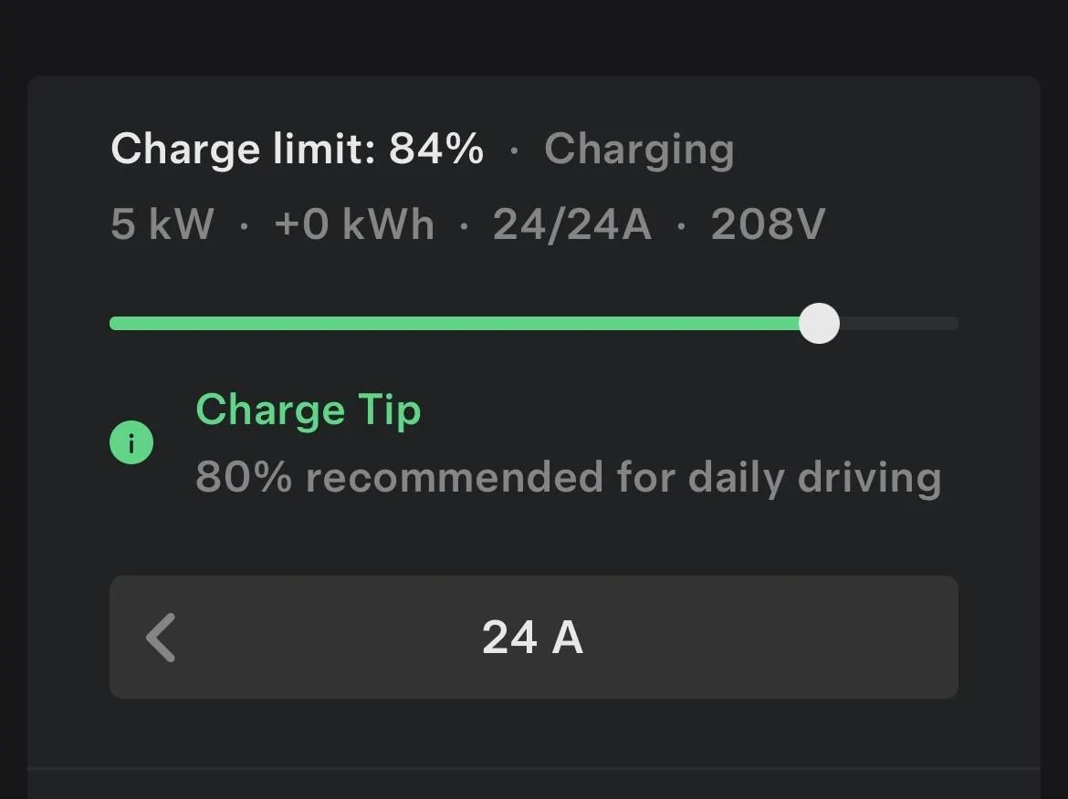

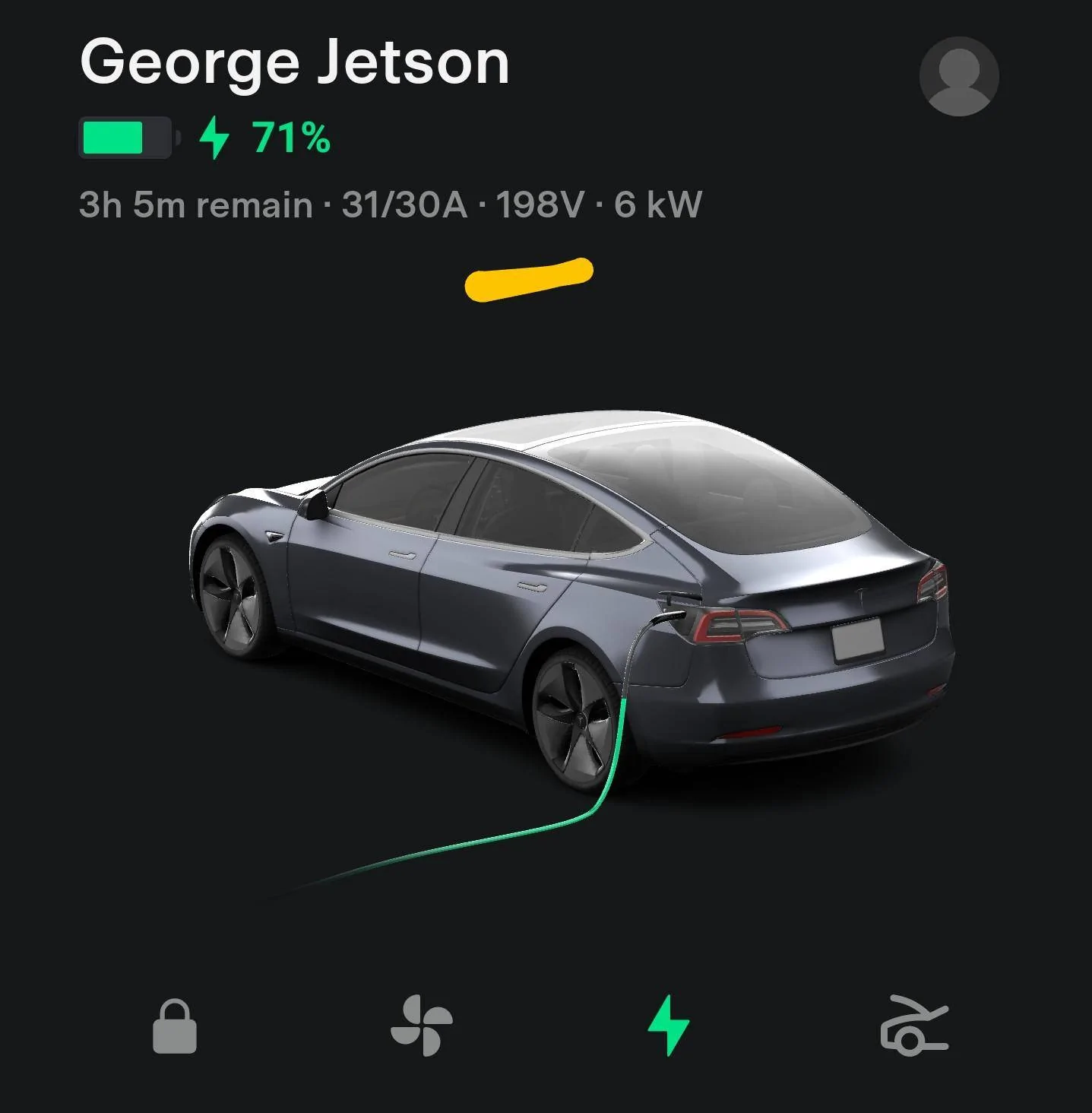

Also if you charge your Tesla with that setup, what is the exact voltage reading while charging? (Reading from the car, not the EVSE)
267
17,906
27,878
A quick search shows the Tesla wall charger operates at a minimum of 208v...
11,345
24,967

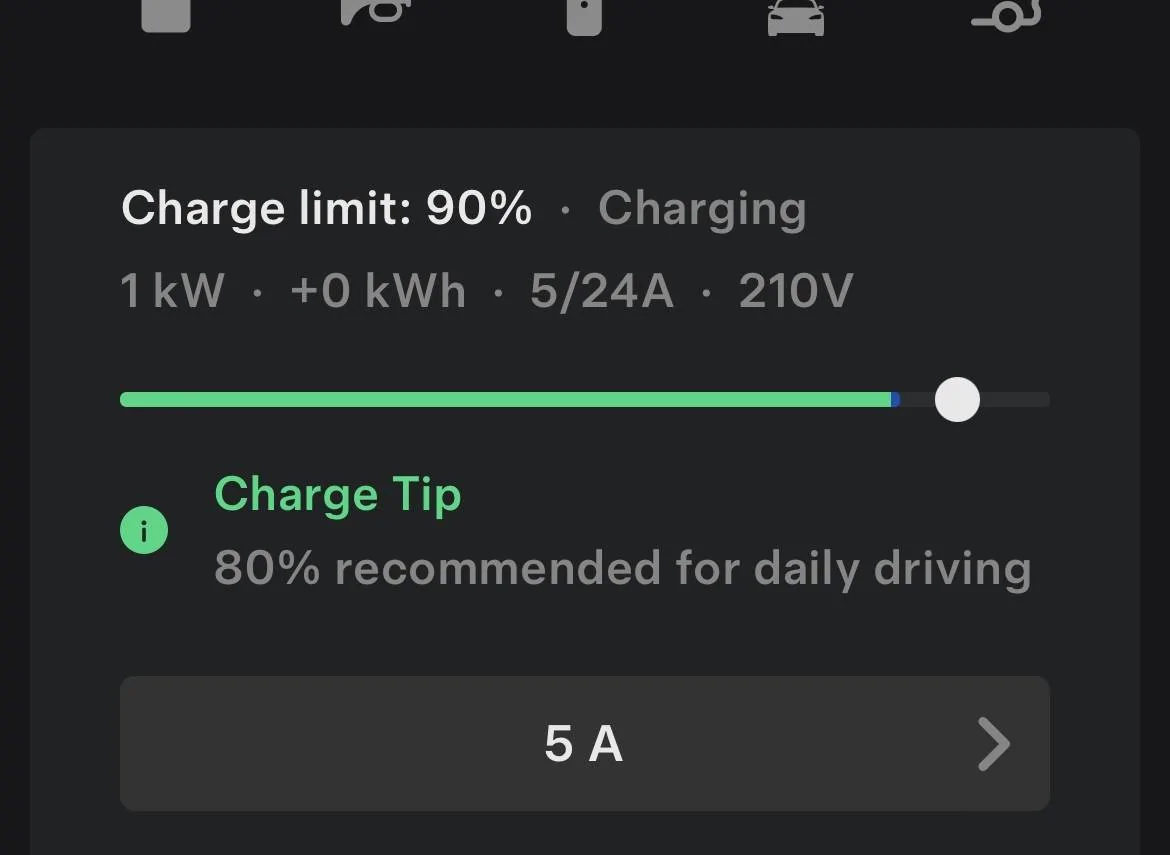

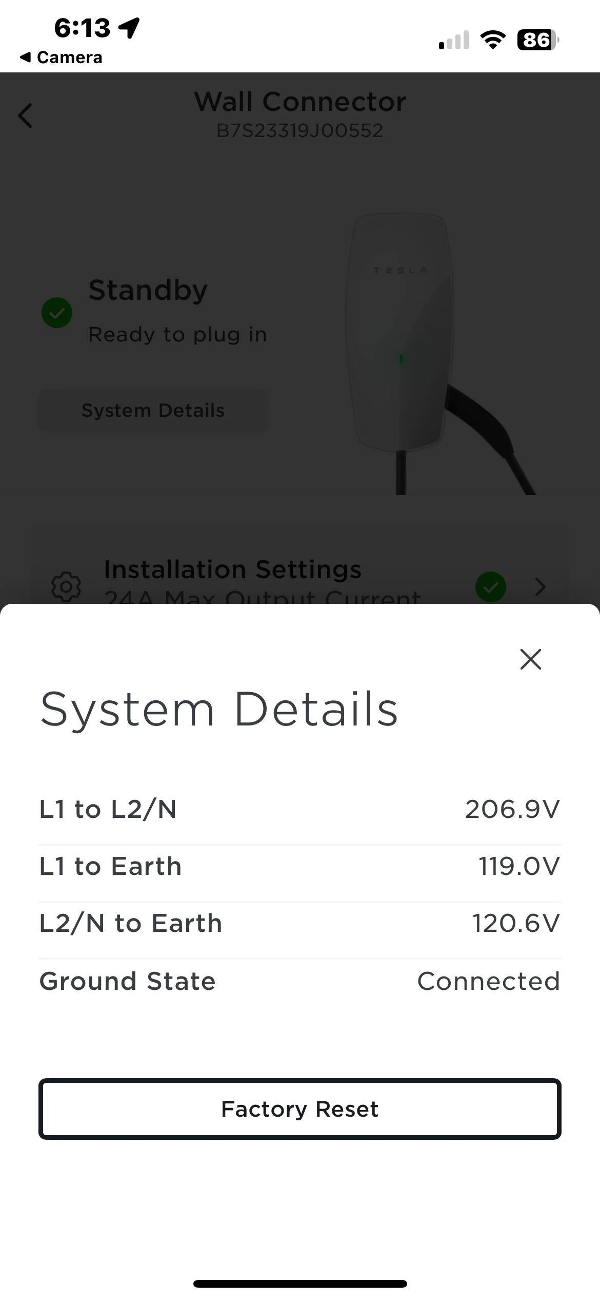

Thanks. Is your service 208V or 240V? If you are in a standard residence with 240V that is an excessive voltage drop. If you aren't sure, set your Tesla to the lowest possible amperage and read the voltage again.
Ringo
Sean
Nov 6, 2023
Vancouver BC Canada
Mache Premium 2023
more or less the same....but it is related to the MME which cannot charge?
Ford Mustang Mach-E Frustrated! Cannot charge by 23 MME IMG_5717
11,345
24,967
OK, so you have 208V service. I was just seeing if you had an excessive voltage drop for some reason. Mach-E should charge just fine on 208V so I'm not sure what the issue is with it. Try this if you haven't yet: Try This First - Powertrain Malfunction / High-Voltage Battery Warning / Service Vehicle Soon While Charging

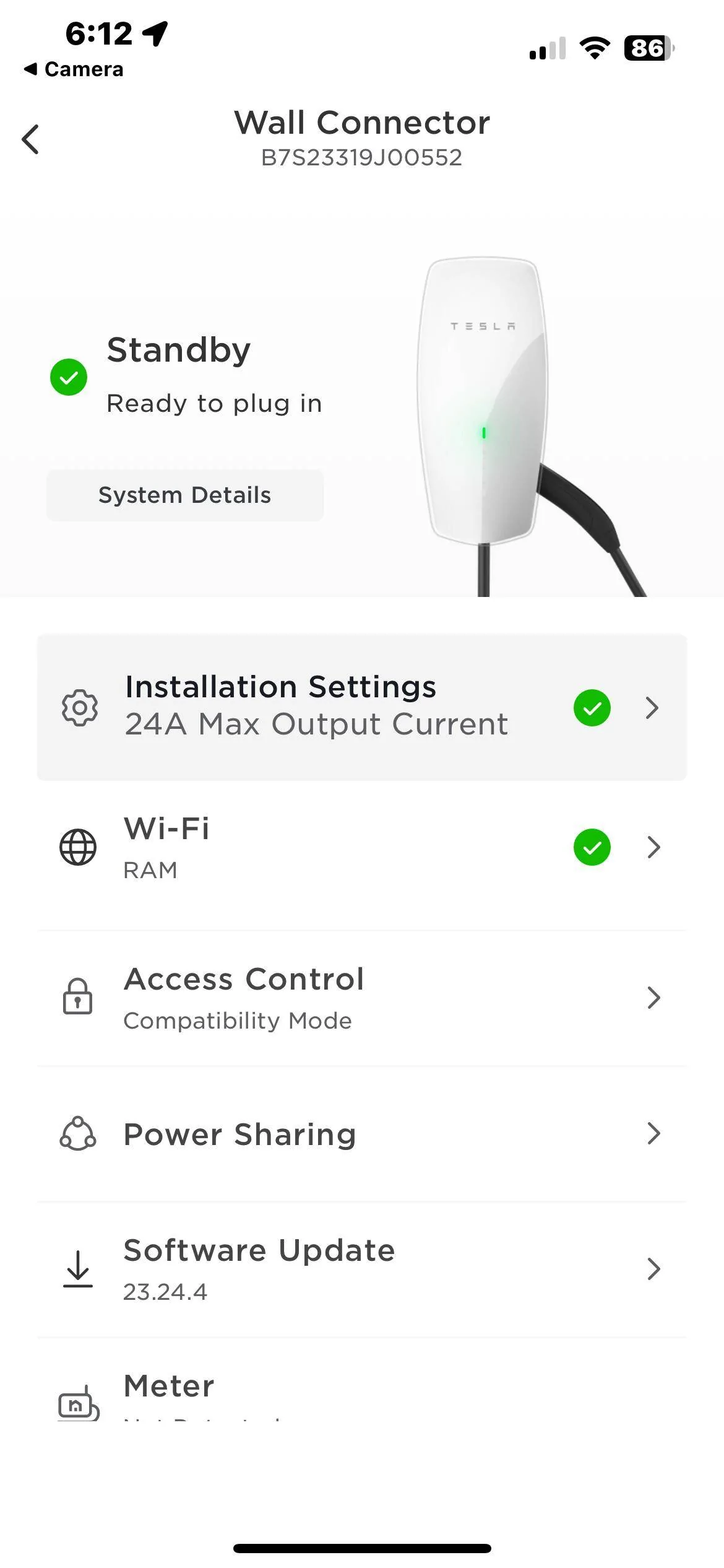

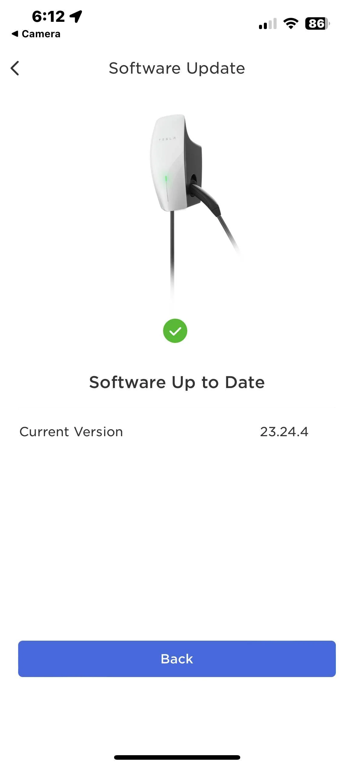

Doing some more digging, it appears Tesla recently released new firmware that fixed a problem that caused the Mach-E to charge fault while using the Tesla Wall connector. Verify you are on the latest 23.24.4 firmware and have set type to J1772 compatibility mode. You could also try manual rollback to 23.8.2.

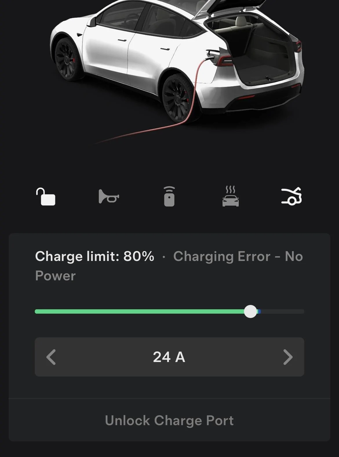

Tried the method:
Tesla Universal Charger with the J1772 adapter then connect to the Tesla made J1772 to NACS adapter then plugs into the Tesla, it shows "Charging Error, No Power".
Also tested with the Ford Mobile Charger connected to the Tesla made J1772 to NACS adapter, plugs to the Tesla, no problem at all.
In conclusion, not sure if there is something wrong with the NACS to J1772 comes with the Universal Connector.
Is there any release note for that newest fw which fixed tge charging problem? Where can I find it? Also, how to roll back to 23.8.2 manually for trying?
11,345
24,967
https://wallmonitor.app/app/firmware/23.24.4
On second thought, I'm not sure if you can roll back to the other firmware because it might be older than the Magic Dock unit. I would try to do a factory reset on the unit and set it up again. If that doesn't work, then contact Tesla. You might have a defective unit, especially since it won't charge your Tesla with J1772 either.

On second thought, I'm not sure if you can roll back to the other firmware because it might be older than the Magic Dock unit. I would try to do a factory reset on the unit and set it up again. If that doesn't work, then contact Tesla. You might have a defective unit.
Since the universal one is quite new and I think I just leave it with the firmware. Will follow up with Tesla first to see if it is a defective unit. Thx dude for your advise! Will update my findings later with Tesla. Merry Christmas!
