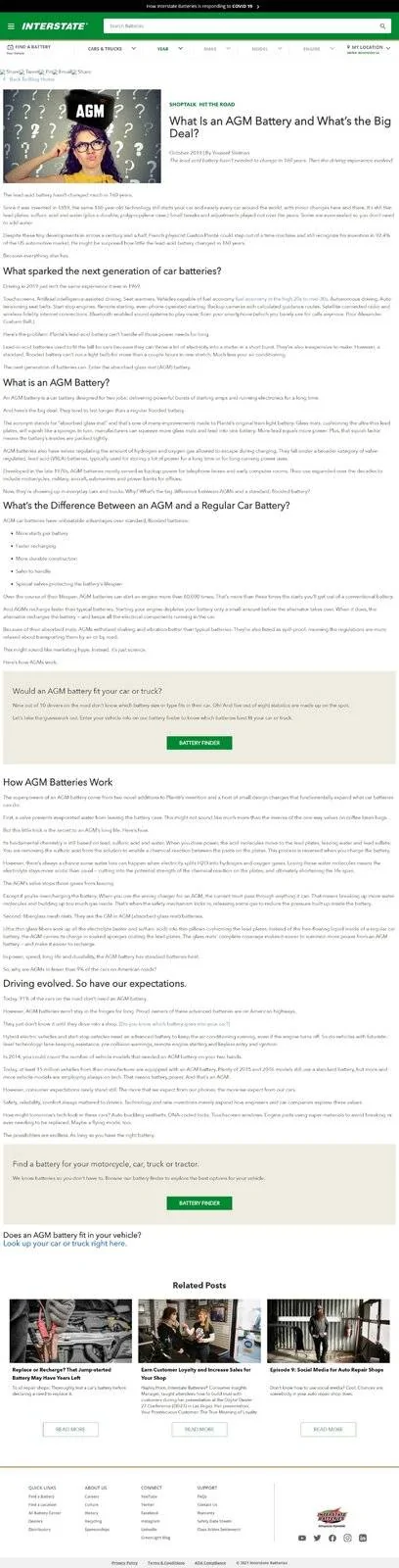

So I have been waiting for almost a full week to get a similar problem fixed. The 12v battery is part#BHAGM - H3, it is a special order part and per the dealer is on national back order. My MME broke down last Wednesday on the way home from a trip, 150 miles from home. After having this battery replaced at a dealer 1200 miles from home the prior Monday. The first dealer also performed tsb#21-2190 and supposedly the #21b36 update. All seemed fine until I pulled into what would have been my last fast charge to top off so we would have enough buffer to get into the driveway. Same stop safely now, not able to restart trouble codes as I got before first dealer swapped out 12v battery and did the updates.
Ford Mustang Mach-E Going downhill- car won’t start Web capture_6-7-2021_133716_www.interstatebatteries.com
