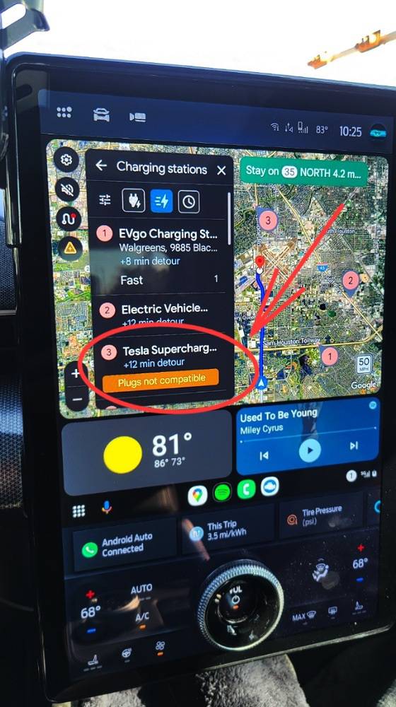

Has anyone here had the "NACS adapter" toggle setting in google maps disappear for them? I had it when I first got the Sync update that enabled the EV features in Android Auto google maps but now I don't have that toggle option anymore for some reason.
Was able to find it after some searching and figured I would put it here for others since it's sort of buried.
Click on search in Google Maps on Android Auto, NOT on your phone. Go to categories on the left, then charging stations. In the top left of that menu will be an icon of 3 sliders, select that. In that menu select the option below the text "compatible plugs." There will be a toggle for NACS adapter, which will enable navigating to compatible superchargers along navigation routes. If you don't have this option toggled, if you try to manually navigate to a supercharger it will warn you that your car is not compatible.
That explains.
Because I have actually charged at the location referred to in the Pic. (A2Z adapter)

That explains.
Yup, if you just select the slider icon below the back arrow you'll find the compatible plugs menu where you can enable the adapter setting!
