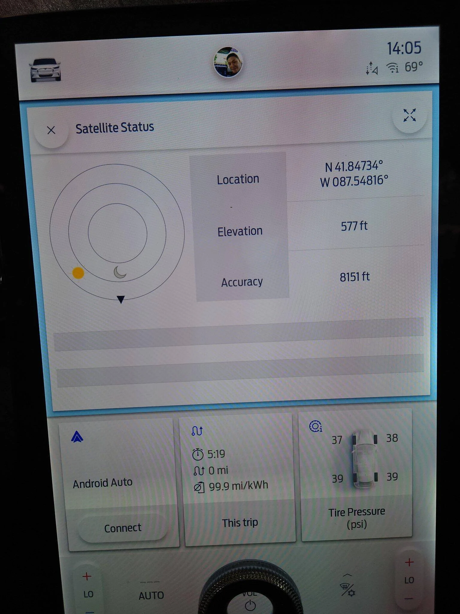

kltye
May 21, 2021
1,115
1,761
Chicago
IB MME Premium RWD
I've had this problem over the last couple months, seemingly at random (i.e., not tied to any particular update). I have Android Auto, so I didn't know CarPlay doesn't use the car's GPS - good to know! Each time it also showed me a couple of miles off (at one point I was in Lake Michigan...). It would move at high speed (say, 100mph?) when the car was in motion at normal speeds, but not even in the correct compass direction. Resetting Sync didn't do anything; it only fixed itself either after sitting for a while, or after driving a certain distance.
This is what the satellite status would look like when it was malfunctioning:
Ford Mustang Mach-E GPS keeps breaking 1658766820476
