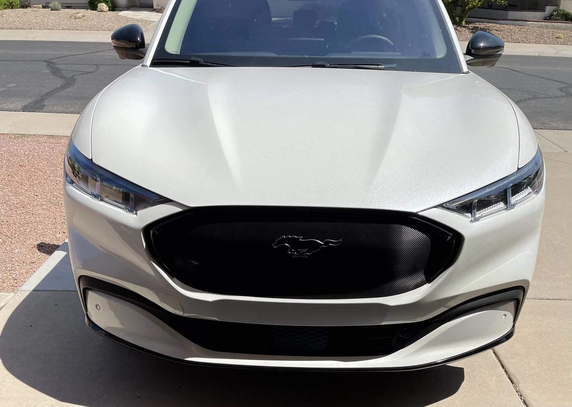

Just added Grille to my Shadow Black Mach E
Hell yeah that looks amazing. Nice job! Adding the grille does so much, actually that was my first choice - but wanted more of the GT look.

Thanks, appreciate your comments. Thought I would dress up the bottom a little bit since it looked a little like that area is disappearing into the bumper.

That looks great!!

please tell me more about this. Was it custom made by the shop you went to?

This is gorgeous ? and now makes me want to change my order to black with a grille wrap. A bit uneasy about the DMG color I ordered without having seen it anywhere. Its pretty much light black. This grille wrap on black looks awesome!

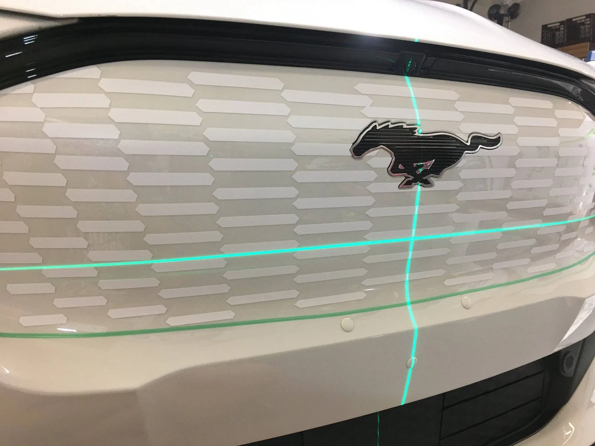

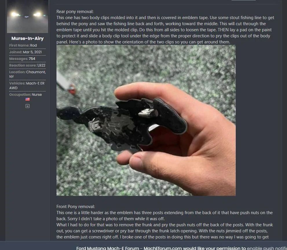

they did an outstanding job. Something I'm curious about with not removing the pony to install, will the cut out edges detach over time? I would think those areas would tend to loosen and I why I'd probably try to do it removing the badges. Here's a photo of a post on the forum about doing that.

FWIW, the guys who installed my PPF (and did a fantastic job) didn't even consider taking the pony off. I think the cutout is part of the template provided by XPEL. My sense from talking to them is that removing and reattaching trim like that is way more trouble than it's worth.

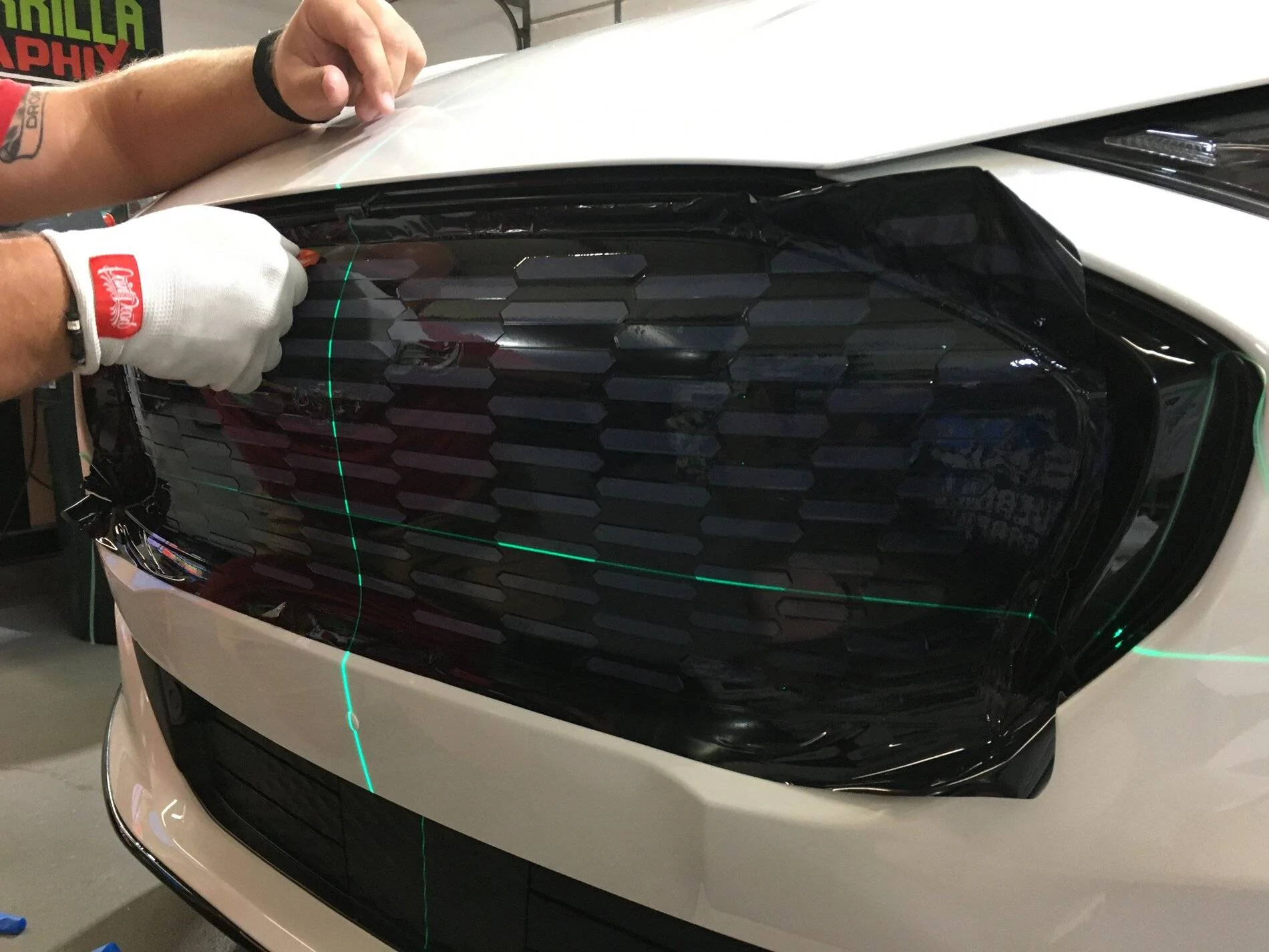

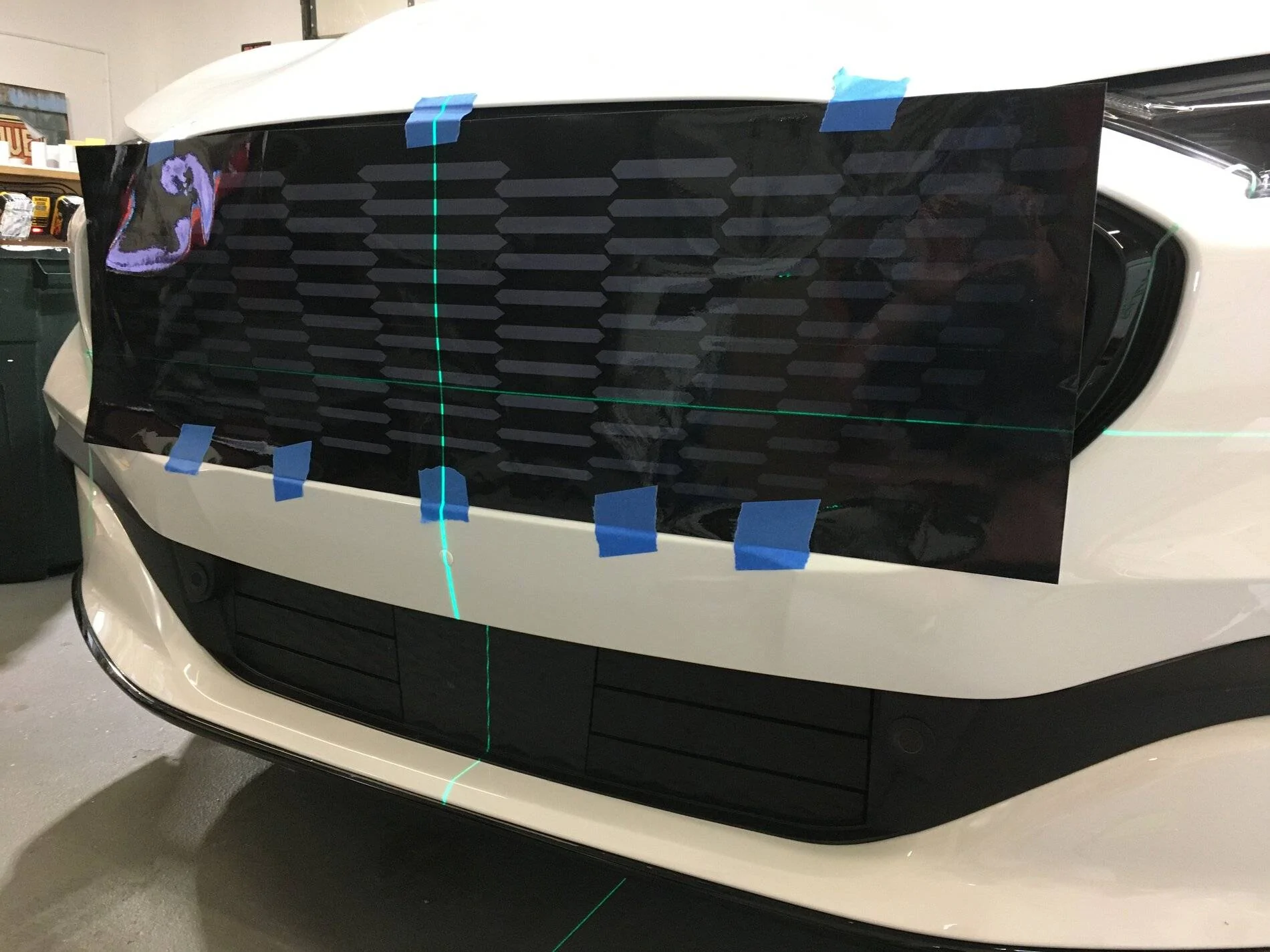

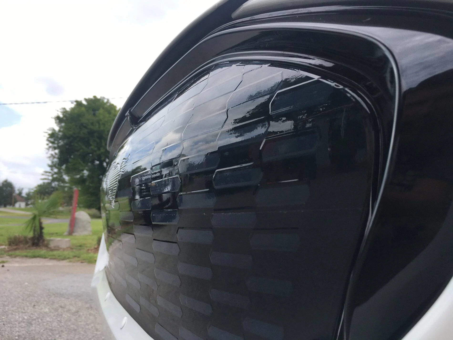

My grill wrap (created and installed) by Guerrilla Graphix (ww.ggrfx.com). Tried to approximate the look of the GT.

How much did this cost? Not the normal wrap it looks like, incredible! I love it and they nailed the GT look!

$100 for the wrap and $150 for the installation. It is thick and not flat but raised (3D). They put a lot of effort into getting the color just right in the sun. Contact them at the email I listed and I'm sure they can send you one. I do have a StruckNdesign wrap (high quality but thinner) but decided to go with this one. I'm very pleased with the quality.
