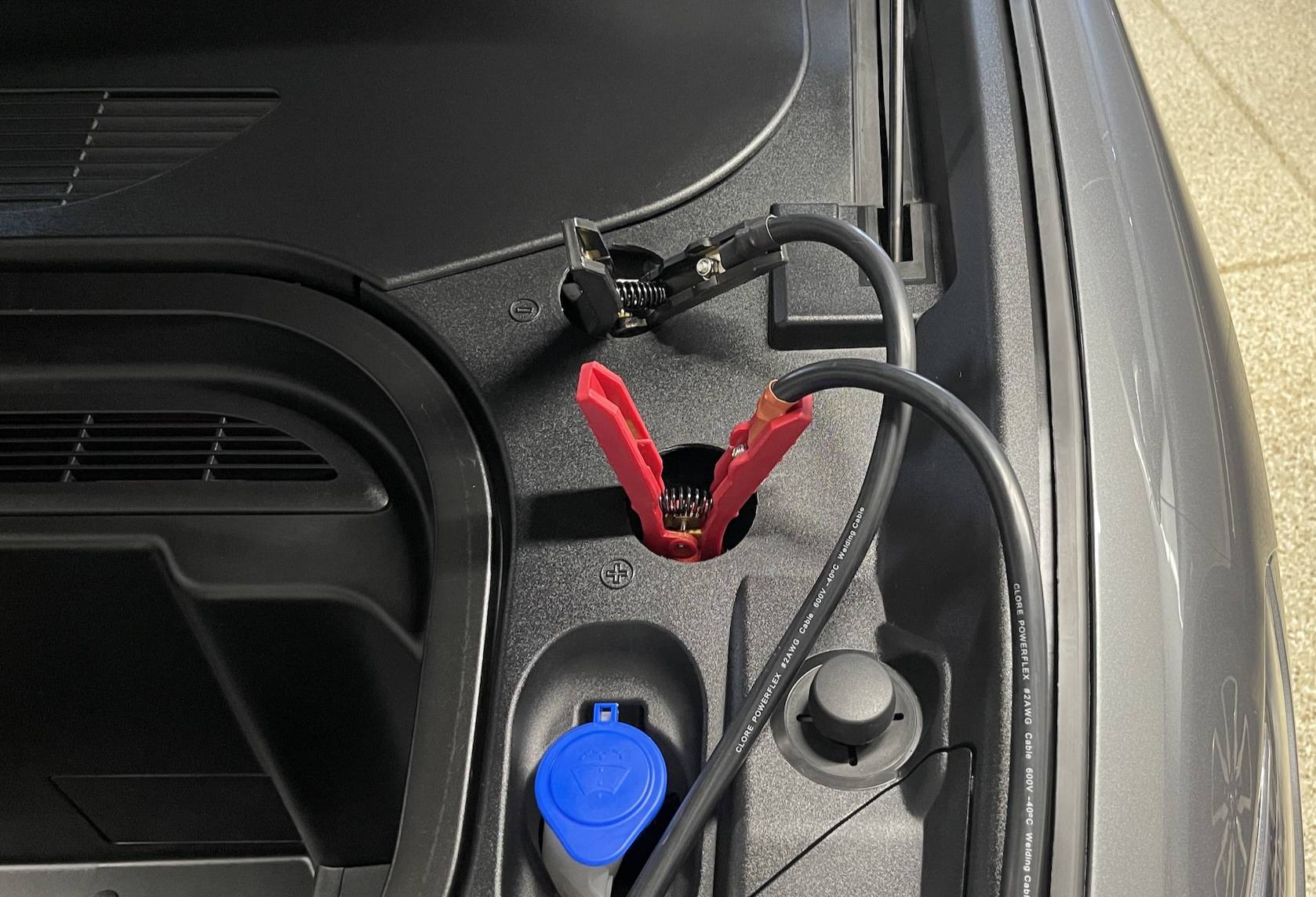

I've had the hole plugs sitting around and template file downloaded for almost a year and finally got around to putting some holes in my frunk. I went with the 2.5". Must have been leftover motivation from finally replacing that stupid grille insert this weekend.
Ford Mustang Mach-E [Guide] Better Jump Point Access (Battery Access) PXL_20250722_223417046

Mine are 2-inch as well.

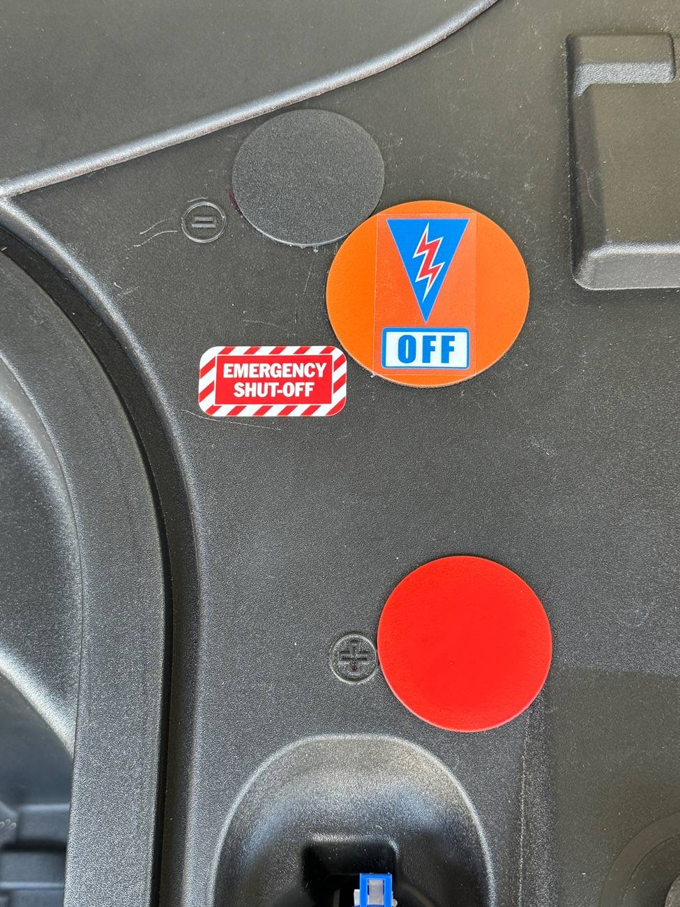

FYI - member dtbaker61 suggests adding a 3d hole between these two for the high voltage battery cutoff switch. I'm sure 1st responders would appreciate that if ever needed... it's the rectangular green thingy under the driver's side cover with the red pull-up tab on its side.
I did that too. Drilled a 2” hole right above the HV cutoff switch. It’s may not needed if one of the other two were closer to the switch at the first place.
