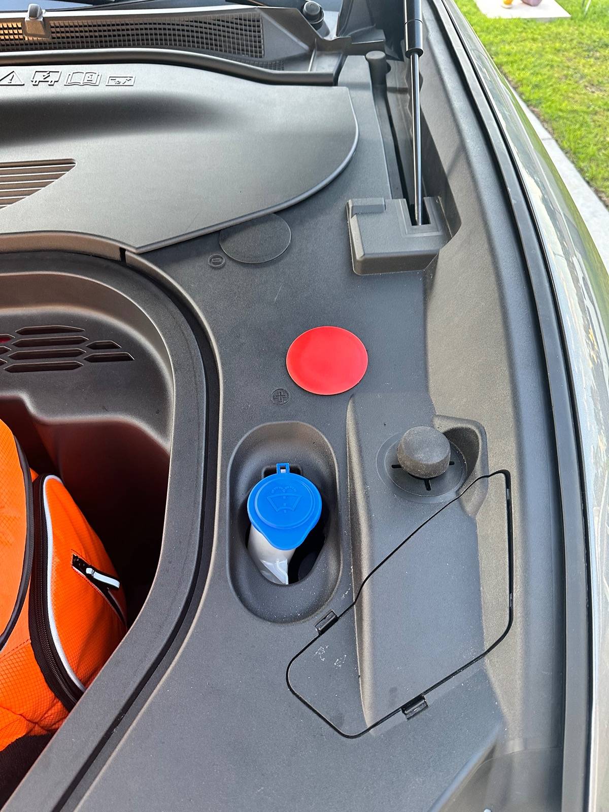

Here is my attempt at Battery access. I am wondering if the existing covers play some sort of functional role (like preventing water egress), and whether cutting these holes compromise that? I assumed that the covers were purely aesthetics before I cut the holes ?
Pretty much what I have done, including the labels. Super useful mod.

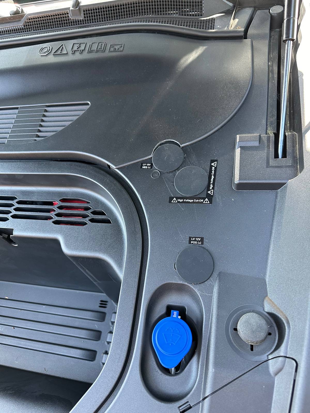

Just finished this... The caps are temporary until I get time to redesign and reprint them, but these (from thingiverse) work fine for now.
Nice. What is the diameter of the opening?
rreddy3
Richard
Mar 25, 2024
988
1,060
2023 Mach e Premium AWD X
~ 2 inches. Probably a tiny bit larger after I cleaned up the holes.
Seems to be a good size. I’ve seen sizes from 1.5 to 2.5” mentioned. No problem getting a good bite on the jump points with a 2” opening? Understood that clamp size varies among cables or charging devices.
You'd need to have some large clamps to have an issue with the 2 inch holes.
