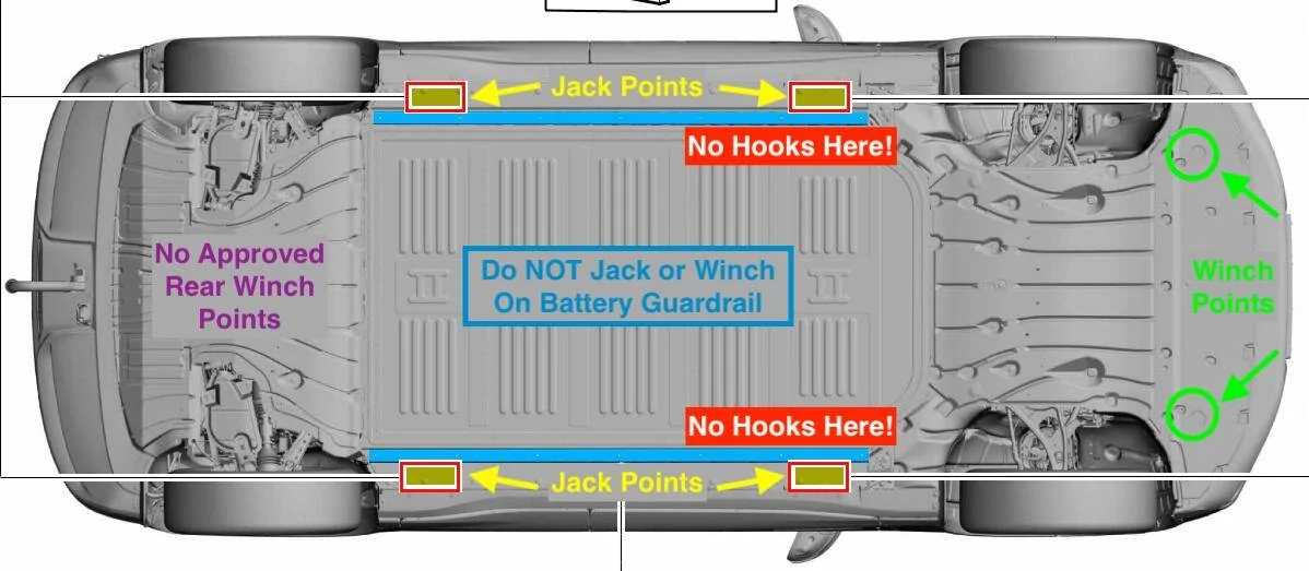

Does anyone have a link here to where the stickers should be inserted (like a diagram)? Thanks!

I appreciate you so much!!!! Thank you!
Heh, I copied the picture from one of the towing/winching threads. I’m a plagiarizing Poodle! ???

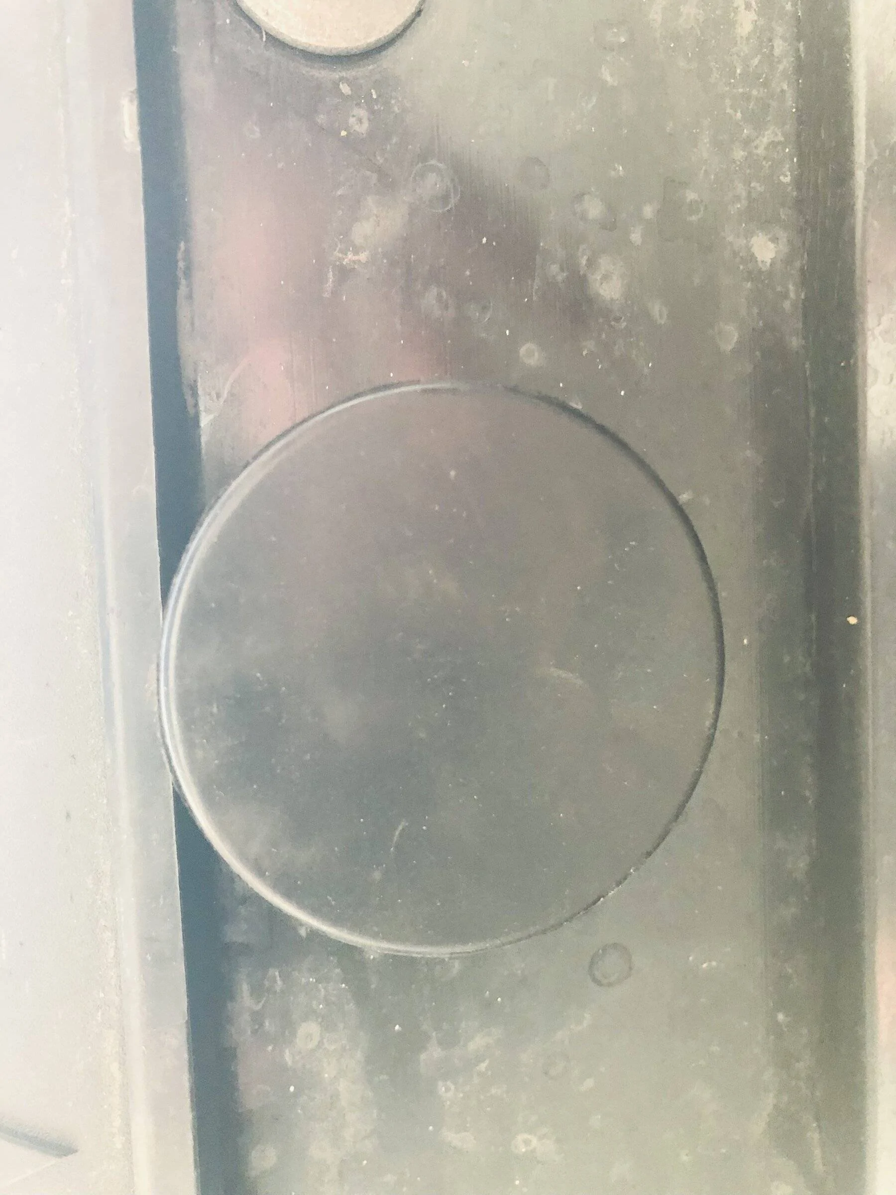

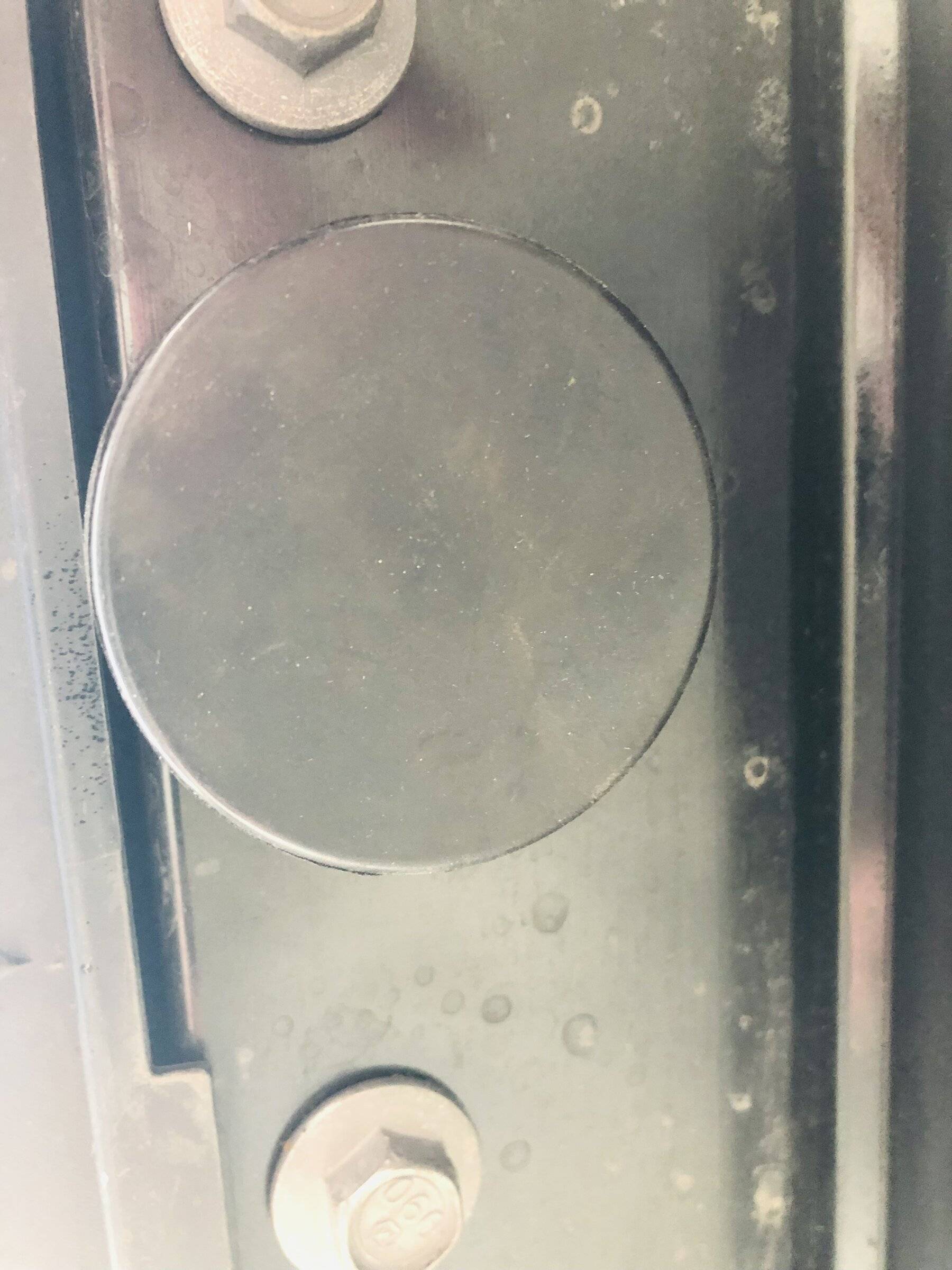

There are little arrows on the plastic cladding indicating the lift points. When I got a screw in my tire, the guy at the mom-and-pop tire shop goes: “Hey, arrows to mark the Jack points! Nice.” ???
There are also holes for lifting pucks. You can just see the top of one of the arrows in the first pic and most of one of them in the second. ??

The pucks sit in a bag under the rear cargo floor board. They will not stay if the car is driven. There is enough friction from the side cladding to keep them there only if the car is stationary. Insert pucks, lift car, place car stands under pucks, lower car. ??
I got GM (Corvette) pucks and modified them by cutting off one of the ears. I got these because they came with a bag. https://smile.amazon.com/gp/product/B091FFG64D/ref=ppx_yo_dt_b_asin_title_o01_s00?ie=UTF8&psc=1 ??
