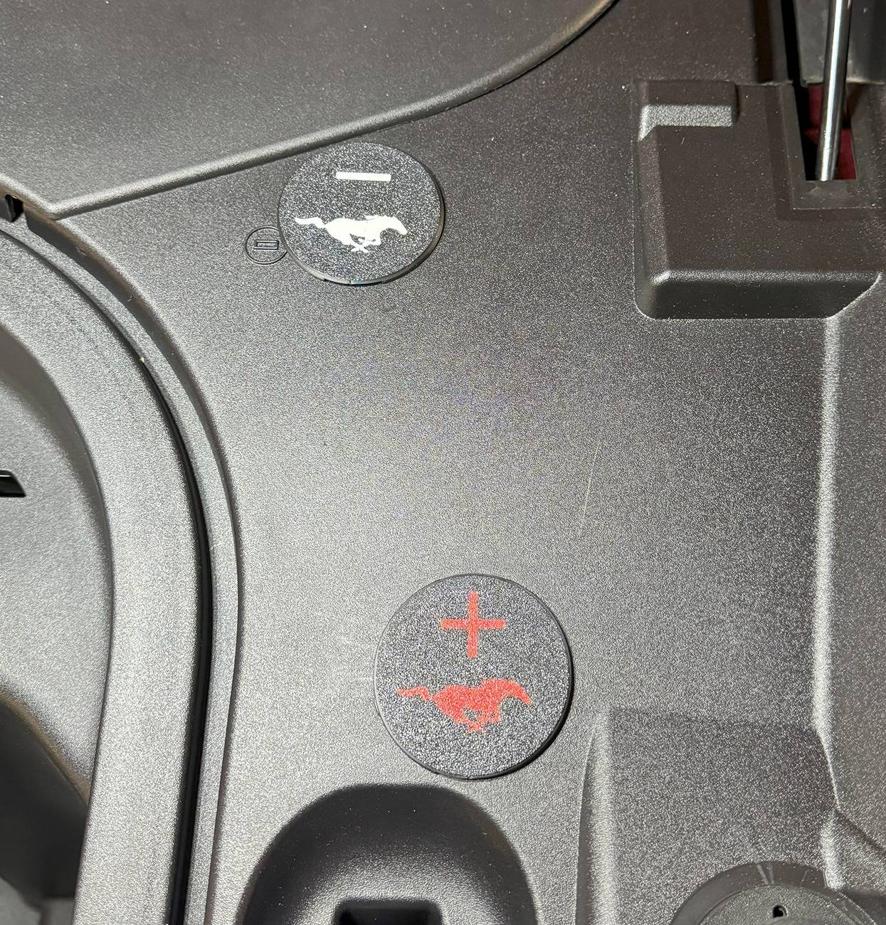

Caps for the access holes... These are 3D printed with two colors of ABS filament. (Voron V2.4 with ERCF filament changer.) The cap's top texture is a texture inherited from my build plate.
Ford Mustang Mach-E [Guide] Better Jump Point Access (Battery Access) IMG_1442
Here's a closeup of one of the caps. You might notice at the bottom of the cap a gap was designed in for a fingernail or tool to be inserted to lift up the cap.
Ford Mustang Mach-E [Guide] Better Jump Point Access (Battery Access) IMG_1441

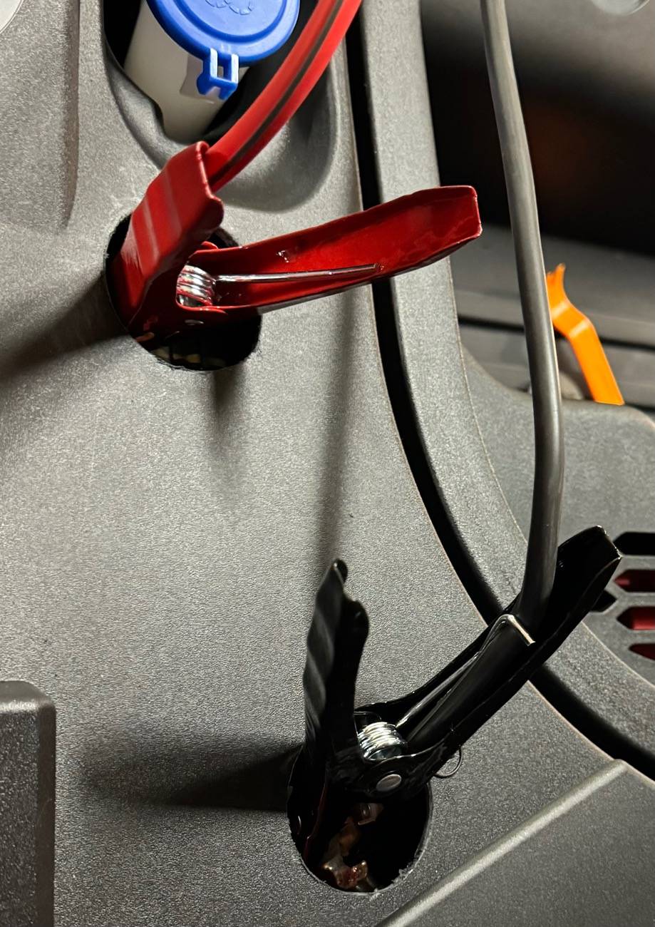

The clamps that came with the charger. Then I reinstalled the plastic pieces so no one can touch the clamps by accident. I put the connector up next to the WW fluid fill for access, as shown in my photo.

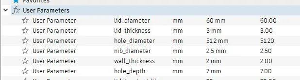

I had always intended to share this model, but somehow managed to forget. Because everyone has different size holes (heh), I'm sharing this as a fusion360 export. You'll want to change the parameters so the "hole_diameter" + "nib_diameter" is just slightly bigger than your hole diameter.
So, in the image below, the hole_diameter is 51.2 and the nib_diameter is 2.5, meaning that (if your filament has no shrinkage) the cap will slide into a hole that's 53.7mm. Of course, you don't want to actually slide in easily - you want a bit of friction to hold it in place, so this size would be better for a hole of perhaps 53.0mm. But, wait! If you're using ABS or ASA filament (which I'd strongly suggest for heat resistance), you have to assume that the printed cap will shrink a bit... How much? Well, that can be different for any specific brand/color of filament.
Ford Mustang Mach-E [Guide] Better Jump Point Access (Battery Access) 1747956589429-7f
In other words, you should get some numbers you like, print a single cap, and test fit it. Then adjust from there. :)

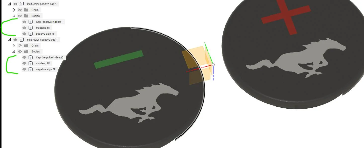

If you have a multi-color printer, you'll want to save the caps as a mesh (stl file) and bring it into your slicer. In your slicer, you'll need to split the model into objects so you can set the colors you want. Each cap has three objects: the main cap, the mustang logo, and the plus or minus sign.
Ford Mustang Mach-E [Guide] Better Jump Point Access (Battery Access) 1747956764915-ru

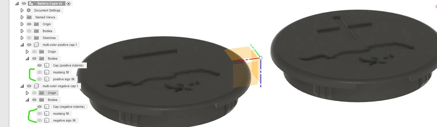

If you don't have a multicolor filament, I'd suggest hiding the "mustang fill" (both of them), the "positive sign fill" and "negative sign fill" bodies before saving as a mesh. This will leave hollows in those areas. It's not as fancy as multiple colors, but it still looks nice:
Ford Mustang Mach-E [Guide] Better Jump Point Access (Battery Access) 1747956881708-99
