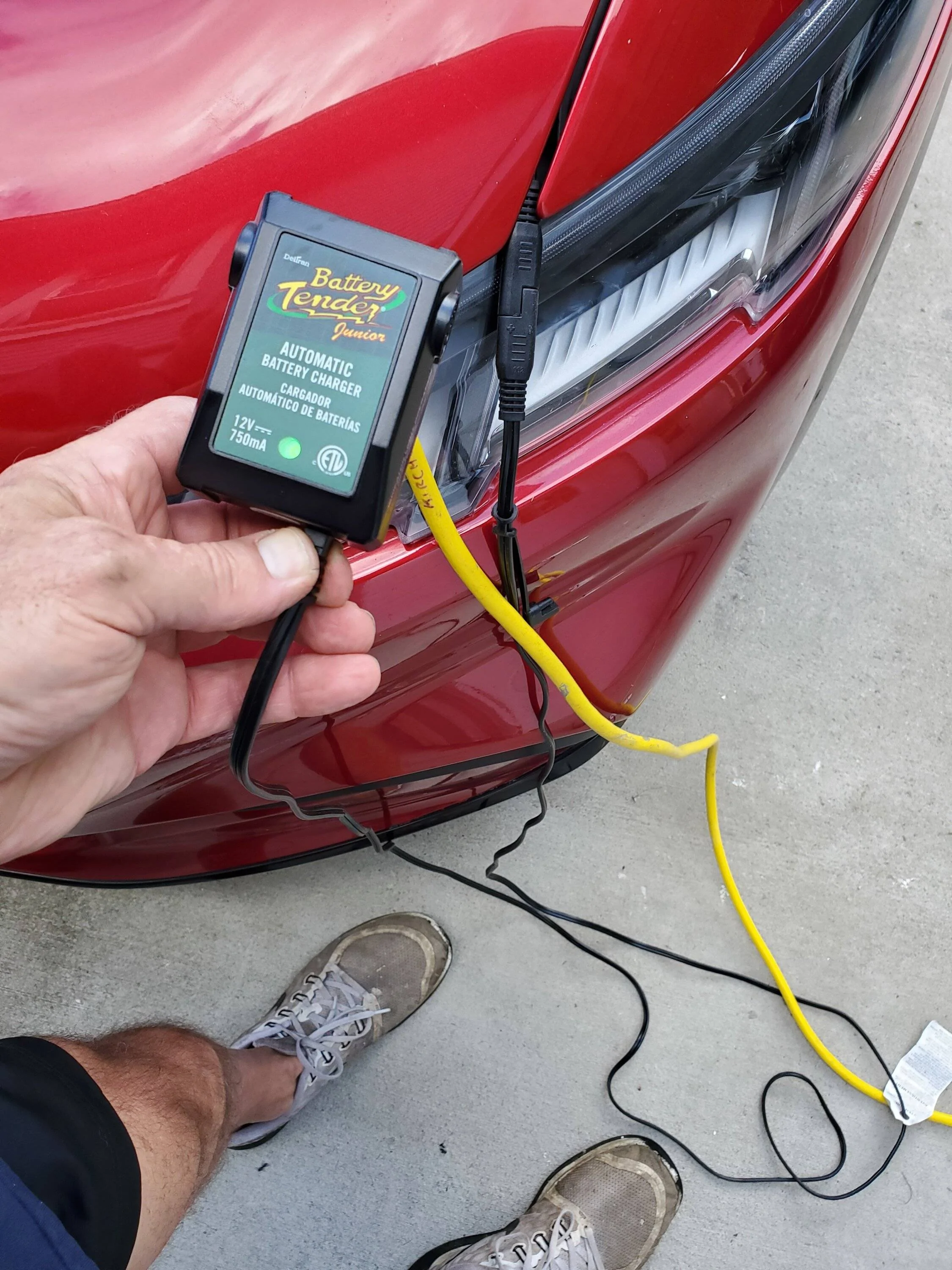

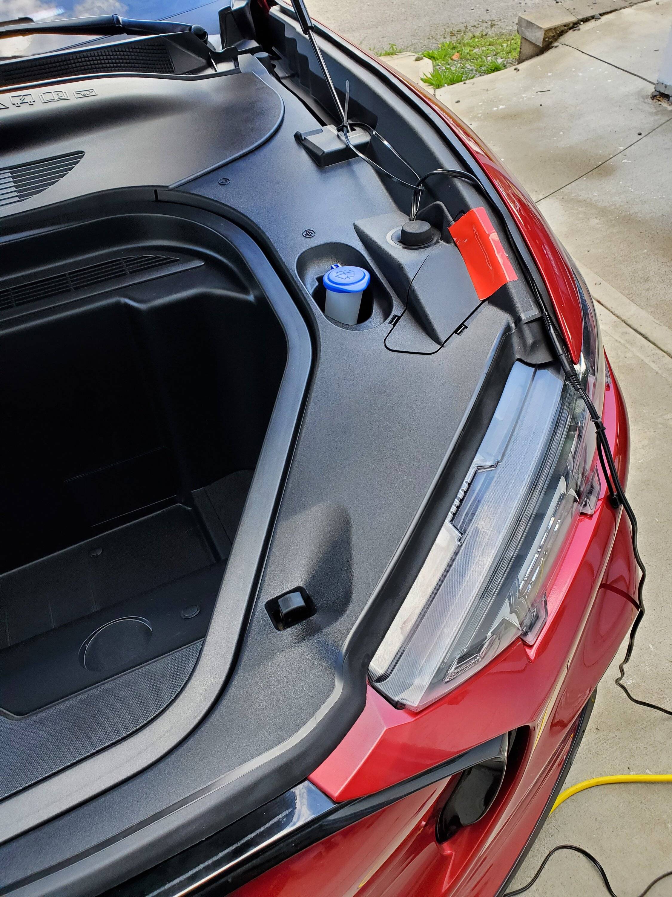

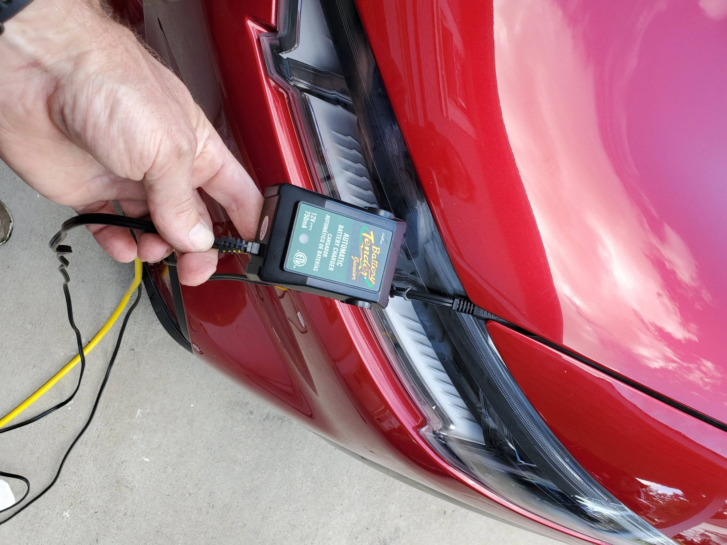

Another option is to run a trickle cable out the front funk and trickle charge the 12V battery as desired.

I have used de-sulfating low current battery chargers for years (lately NOCO brand) to maintain/restore old batteries. One day, my MME LVB will be an old battery. I also connect up the battery charger for a day or two once a year or so to extend its life, and I do that on all my cars. Since I started that practice about 5 years ago, I have not had to replace a 12V battery. Also, I note that my MME uses 12V power every time I walk past it with my phone. Lights come on, relays click, etc. Some days I walk by a dozen times without ever opening up the car or starting it. Since the software fix (mine was one of the first in my area - coming up on a year old - and the battery went dead once), I have reasonable confidence that the 12V will be kept charged by the car itself, but that still does not give it the de-sulfate experience. I connected a cord from my battery maintainer to the MME battery, ran the connector up through the windshield washer fluid bottle neck hole. When gone for a long trip (we use our Highlander Hybrid as our vacation car), I leave the charger plugged into the connector under the MME hood. I don't expect to need to "jump start" my MME any longer, but battery maintenance is good for the battery and easy now with the connector accessible. No holes.

The clamps that came with the charger. Then I reinstalled the plastic pieces so no one can touch the clamps by accident. I put the connector up next to the WW fluid fill for access, as shown in my photo.
