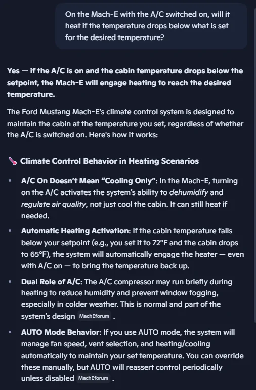

The main issue is that heat is not indicated anywhere on the screen unless you go into a sub menu. This is a poor design choice and should be fixed. A/C is indicated (and selectable) from the screen at any time, why not heat?
It seems you need a bit of clarification on the term A/C. It isn't only cooling. It is "conditioning the air to be at a conformable temperature" whether that is to cool or to heat the cabin.
Pressing the A/C button so that the indicator is off is the same as turning off both cooling and heating.
So, in a way you can consider the Heat button the option to make the A/C button "only cooling".
Here is what CoPilot has to say about it:
Ford Mustang Mach-E Heater is on by default? 1761855104795-bx
As I said my main complaint/desire would be to control this range of where it switches between the cooling/heating. But that isn't available.
