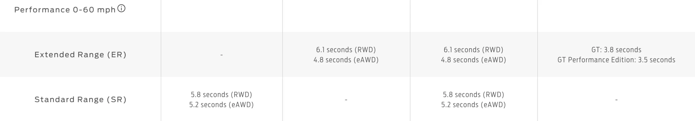

Ford Mustang Mach-E Help me understand: ER vs acceleration Screen Shot 2022-03-02 at 7.03.25 PM
The above is from the Mach E Specs comparison chart. The columns are Select, Route 1, Premium, and GT. ER RWD is slower than SR RWD (presumably due to the added weight), while ER eAWD is faster than SR eAWD (presumably due to the greater current sourcing ability of the ER battery pack being able to drive two motors faster than the SR pack can). Though in all cases the differences from SR to ER are small...
