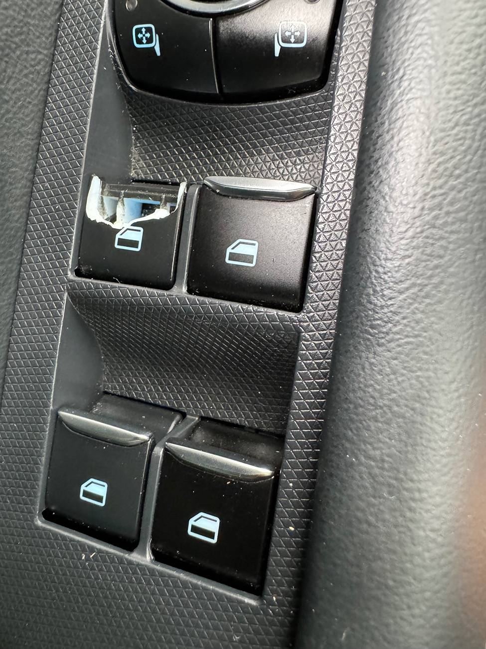

Before I go balls to the wall and start pulling stuff
Anyone have a clue how to remove this broken plastic

Absolutely. Follow these steps:
1) Call your dealer and make an appointment.
2) Show up, and have them replace switch under warranty.

Wonderfull if they replace this without blaming me for doing something to it. Thank you. I’ll make a call tomorrow , i didn’t think it would be covered.

If it broke in normal use, and you're within 3 years / 36,000 miles, it will be covered. If you hit it with a hammer, it won't.

To answer your original question, that is a module. You can’t replace the individual switch cover.
The good news is it’s not horribly expensive, around $30. Part number is LV4Z-14529-AA

Thank you GatorGrowl. You understood the question.
Other than the obvious “Call the dealer”. Which I really didn't want to do. This other option is exactly what I wanted to know. Thanks.
