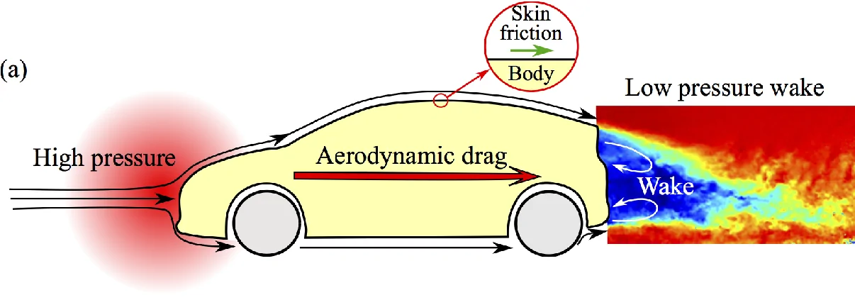

The tires kick up dust into the wake behind the car. Since that's a low pressure zone, the tire spray and dust gets trapped behind the car and can settle on the rear window.
Ford Mustang Mach-E Dirty rear window 20-Figure1.2-1
How dirty the back window gets is a function of how dirty your roads are. If you want to make the back glass easier to clean, put a ceramic coating on it and use the rear washer.

No, I just have an aerodynamics and fluid flow education. The phenomenon is similar to one that we find in an engine called "windage." That's one where the rotating mass creates a low pressure area immediately surrounding it, making all of the oil that is aerisolized want to stick to the rotating mass (which in turn creates massive drag on the rotating mass). This is countered in high-performance engines by the use of windage trays and crank scrapers. 🤔🐩
In short, because science.
