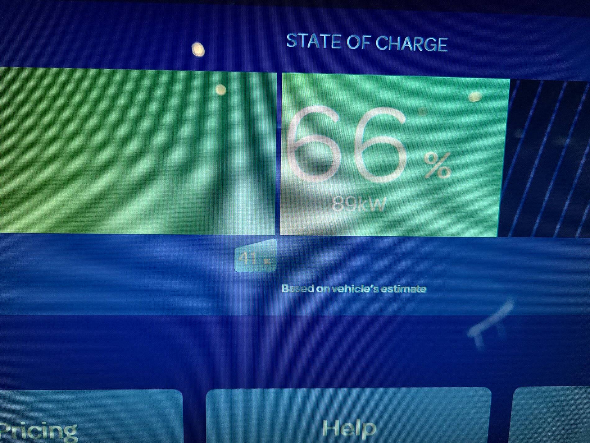

Yeah I went to get a coffee and when I came back it's now up to high 80s/low 90s.
8% more since posting this picture under 4 minutes ago. That is sufficiently fast for me for now. 😊. Plenty of time to post here, listen to a podcast..

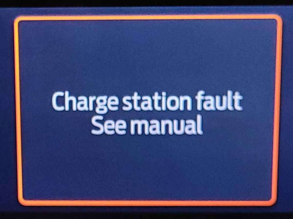

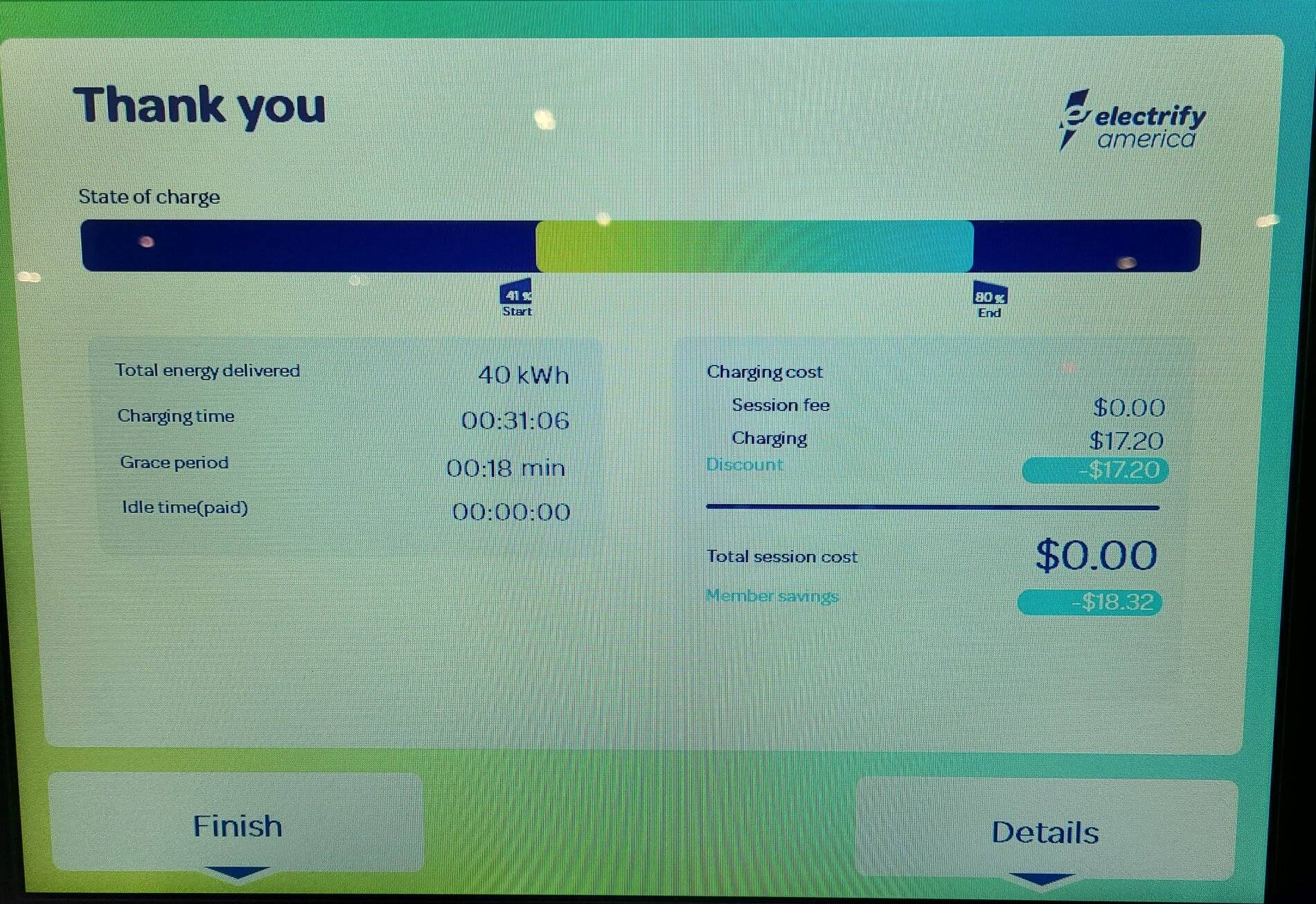

The 80% drop is in fact real. And as at least one other person has posted on here, it looks like you will be charged, then... Magic! The drop is so severe that shortly after I stopped recording the video, the cooling stopped on the station, presumably because it didn't need it any longer .😮
Weird charge station fault in the car when starting but everything worked.

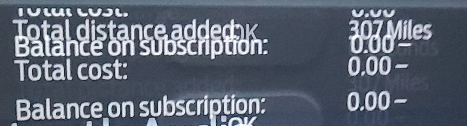

There was also a brief display on Sync 4a a few minutes later I haven't seen anyone mention that tried to tell me about my charge status, cost, etc., but it disappeared before I got a good picture. I wasn't expecting it since it had been like 5+ minutes after starting. I did get a picture as it was scrolling off. Notice "307 miles added" which is nonsense but 307 km might be right?:( The information was in other ways wrong anyway (notice the "Balance on subscription: 0.00-":

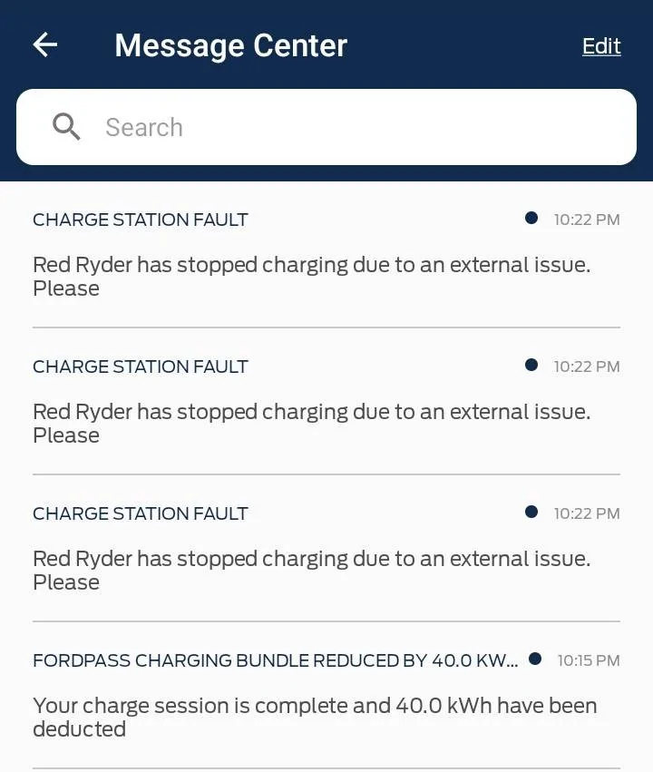

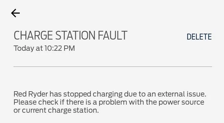

a little more (I know I know) - it looks like the car was a little confused by the charge session stopping and translated that to a fault, based on what FordPass says:
and yes that's three of the same fault messages from what I can tell 🙄

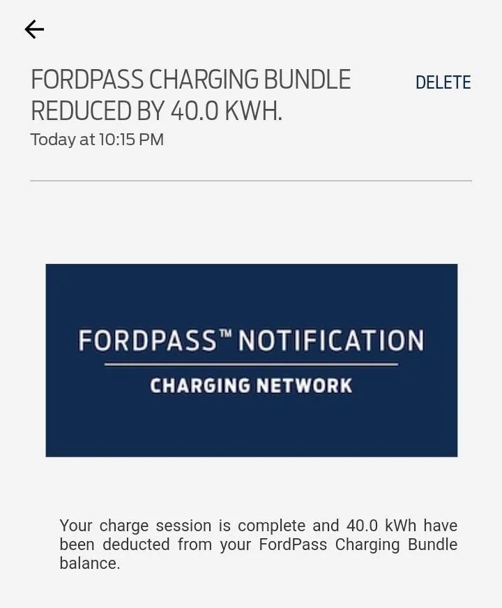

FordPass does show the decrement from 500 kWh to 460 kWh.

apparently the charging fault message is tied to opening the door (thanks @DBC): https://www.macheforum.com/site/thr...-gives-the-service-vehicle-soon-message.4977/
this is a wacky one that I'd hope would be fixed in an OTA.
Actually I unplugged the PowerLine and viola, have not had a fault since. Unfortunately I think my report was false. Not literally, what I described was true, but in retrospect seems more conincidence than cause. IOW I think the fault on opening the door was more symptom than cause.
