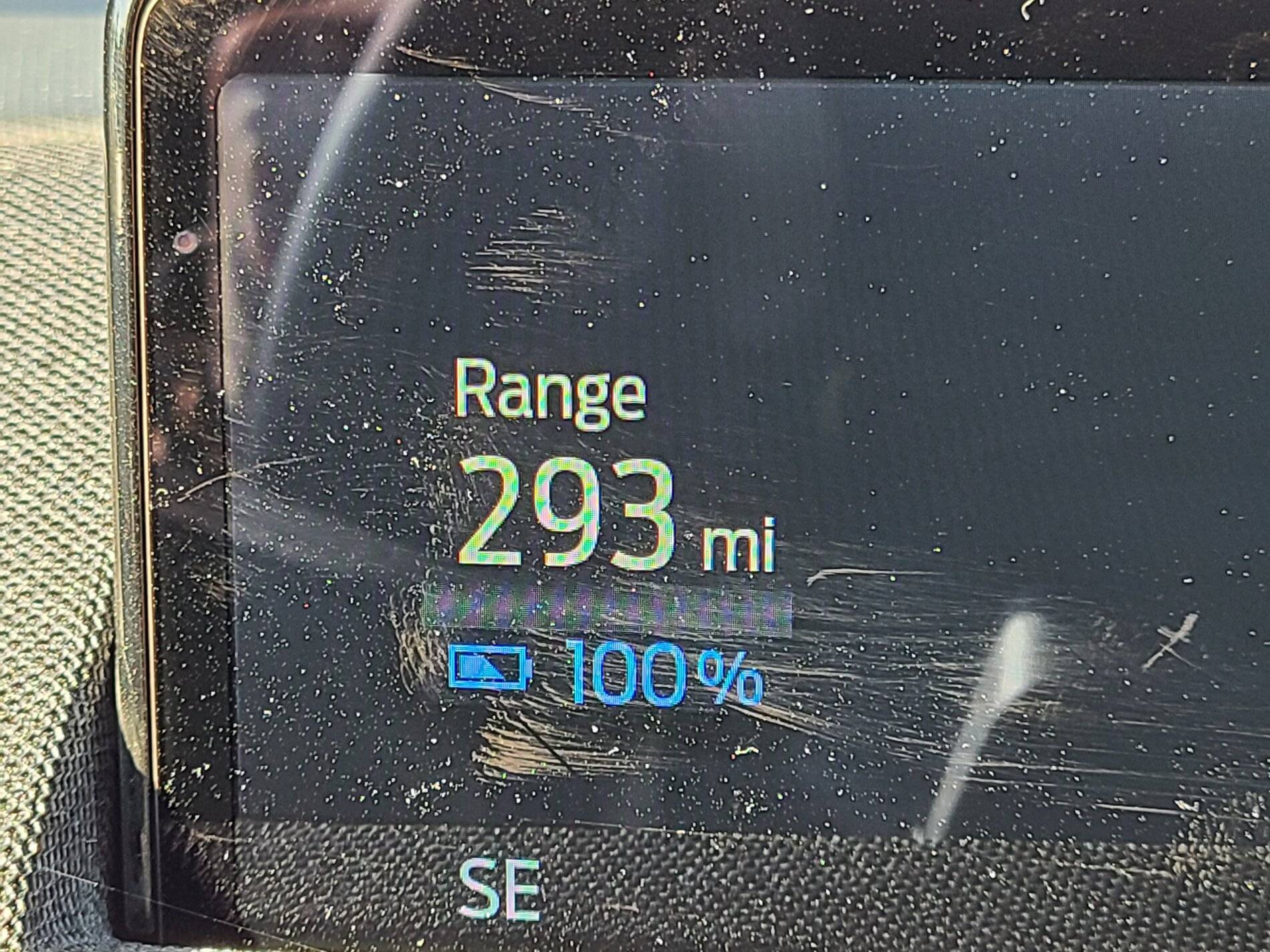

Today, after driving about 3 miles. The GOM read 292 and went up after the three mile trip.
Ford Mustang Mach-E hey, I have a car! 20210605_082931
