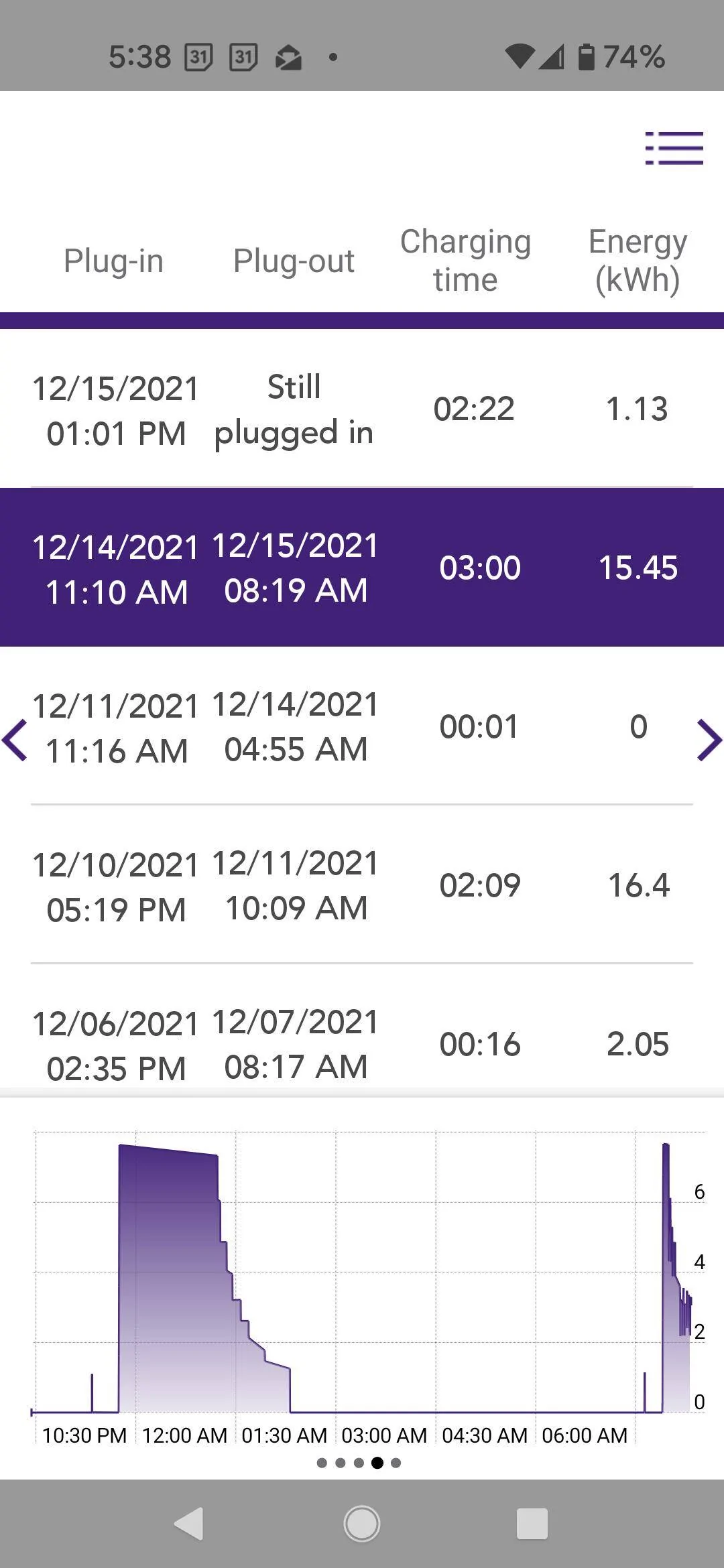

yes, to first order. Certainly shows gross power and total energy. The time from point to point is usually 15 or 30 minutes. Most charger logs probably (?) would not pick up a short time use. That is the question, does MME only take long intervals of use, or does it take short sips from time to time? Would a 3 minute use show up on a regular charger log? A high resolution (time
Not only will a 3 minute charge show up, even a less than one minute charge shows up. I get a notification that the charger has initiated charge, and then that it stopped.
Here's a picture I posted previously,notice the quick blipsa:
Ford Mustang Mach-E How much power does Mach-E draw when plugged in but not charging? Screenshot_20211223-173822

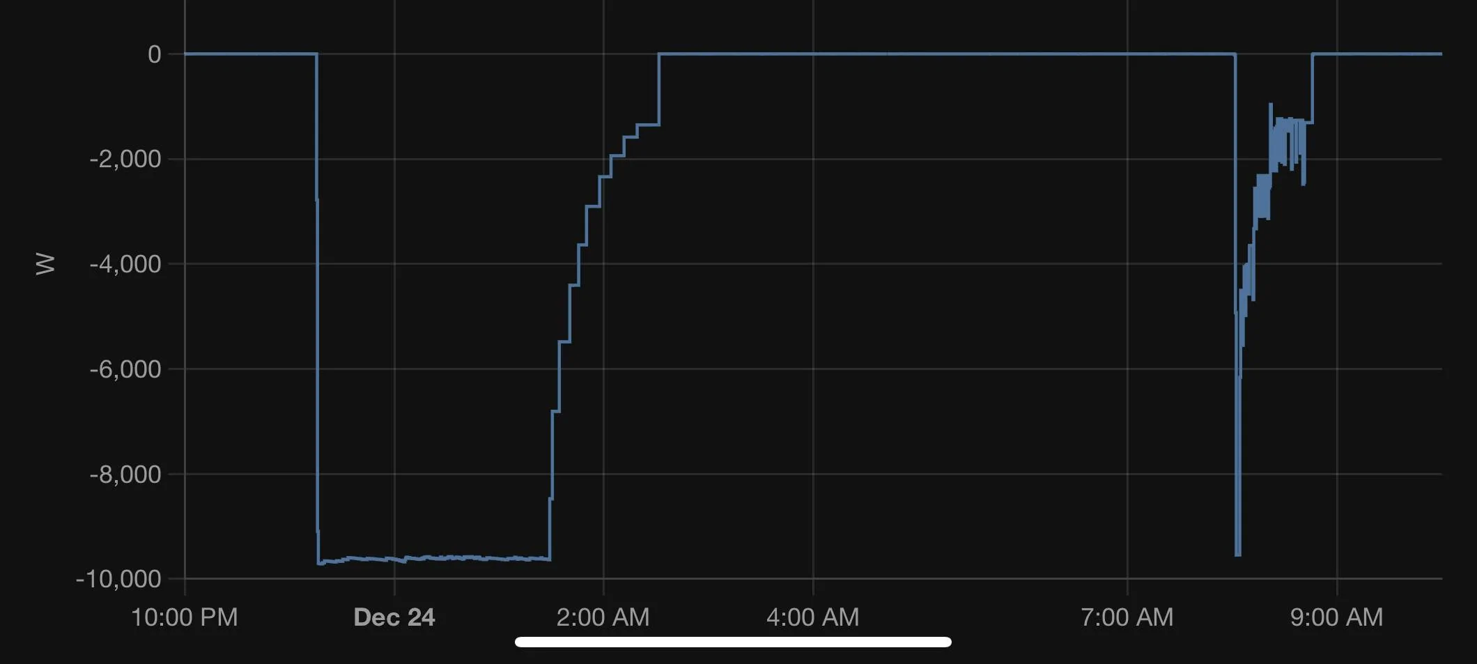

Here is a typical day when plugged in the whole night, the first load is an actual charge cycle, the second is preconditioning in the morning.
note that power is inverted in this view, so negative is consumption by the vehicle.
The zero power lines truly are zero watts. I see between 0 and 2W when the contactor is open, which is just the tiny idle draw from the charger.
Ford Mustang Mach-E How much power does Mach-E draw when plugged in but not charging? 10884813-4B60-44A0-BC8D-BB2A66BEFDFD
This is just a snapshot, but most days look like this, either a significant draw or no draw. No low constant loads.
