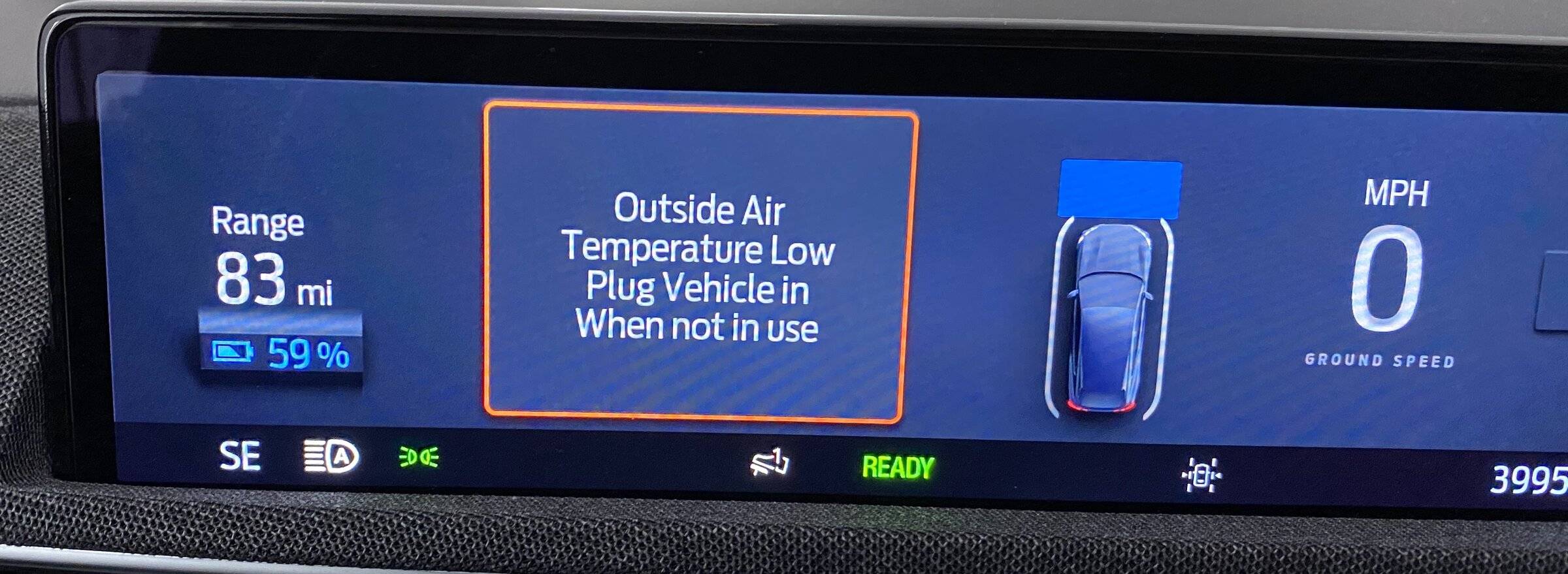

My original question was not about battery loss while idle. It was about additional power usage while plugged in but not actively charging. recently every time I turn off the car I see a message saying
Ford Mustang Mach-E How much power does Mach-E draw when plugged in but not charging? 834D5521-B8E9-4EC7-9E83-A9A6A0FCCE84
so why would it be important if it were not going to use energy? In addition, while it is sitting idle I’m my garage there is the sound of some sort of motor running.
So it is definitely using some electricity. Just a question of how much. And since my car spends 12-24 hours a day plugged in, that could add up. Both of the graphs offered display kilowatts, but even a small extra 40 watts for an average 18 hours per day is 21 kWh per month. Not going to break the bank, but I would just like to know.

I'm not sure what other explanation you wanted. Like I said, it tells you that once external temperatures are < 32F, just in case your pack temperature falls below that temperature. Li-ion cells cannot be charged when they fall below freezing. Since the battery pack has a large thermal mass, it'll take a while for the pack to drop below freezing, so driving the car daily probably won't cause it to heat the pack.
The motor you're hearing is just the pumps running to circulate coolant. They don't run forever, and turn off after a while. Pumps don't take very much energy to run either.

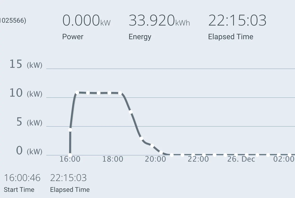

Any intelligent charger shows you this.
We last charged on 12/15. We have used 1.13kWh since then which includes a 30 second remote start. Unchanged from several days ago.
yes, to first order. Certainly shows gross power and total energy. The time from point to point is usually 15 or 30 minutes. Most charger logs probably (?) would not pick up a short time use. That is the question, does MME only take long intervals of use, or does it take short sips from time to time? Would a 3 minute use show up on a regular charger log? A high resolution (time and power) logger would show a short use for sure.
