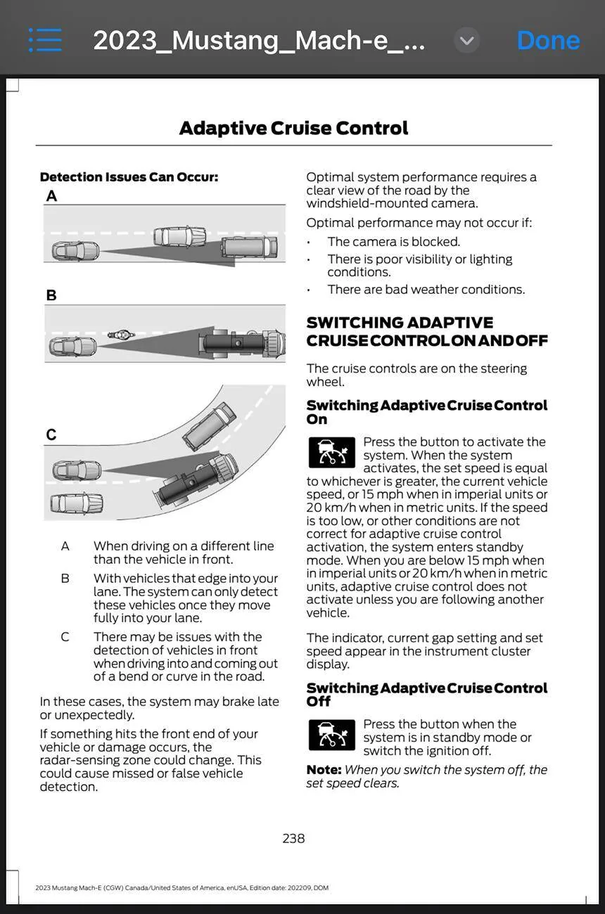

It does have a resume button. Left side of steering wheel. The rocker switch for changing the speed up/down also pushes in. Pushing in toggles cruise control off/on while a speed is set.

Also if you accelerate it will resume most of the time but I don't think in all cases
If you manually brake like the poster above said, hitting the accelerator won't resume the cruise speed since you canceled the speed by hitting the brakes.
