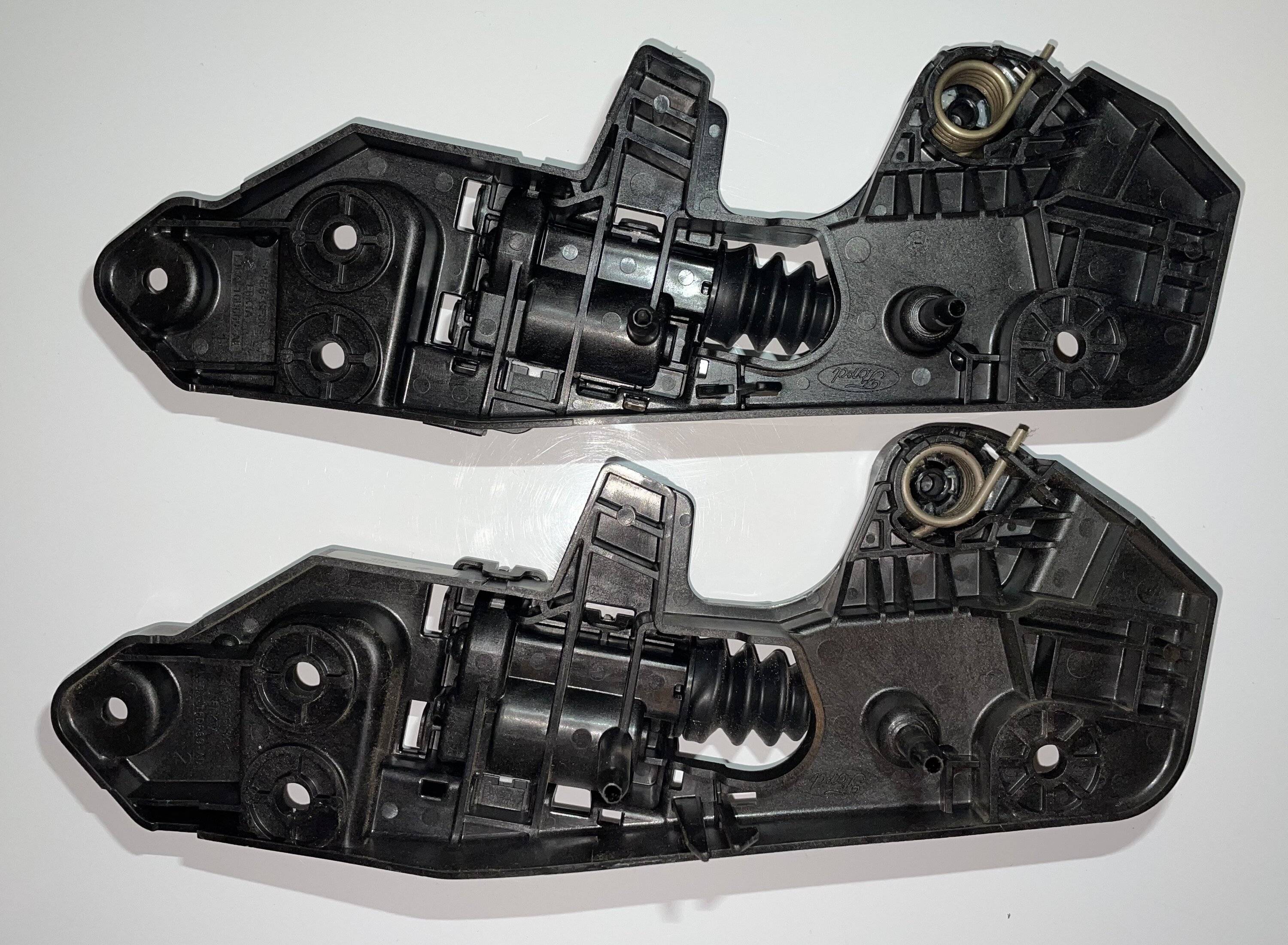

Got these 2 parts replaced:
Part Description
LJ8Z 16700 C LATCH ASY - HOOD
LJ8Z 16700 A LATCH ASY - HOOD
Part Description
