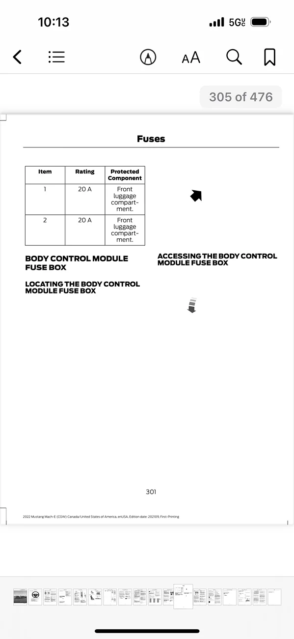

I feel like a complete idiot, but I can’t figure out how to open the fuse box under the glove box. The owners manual literally just has a photo of it with an arrow, and I couldn’t find any YouTube videos with that particular fuse box. Do I just pull? Do I have to remove the panel that’s just above it? If anyone can point me to instructions or a video, would be much appreciated.

Looks clear as mod.
I would guess you peal it off from the top.
Ford Mustang Mach-E How to open Body Control Module Fuse Box IMG_3392

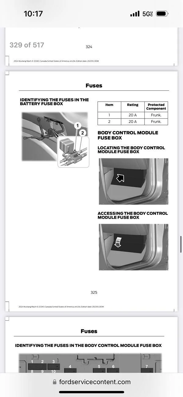

The 24 manual has this. But I guess that not a picture of the fuse box.
Ford Mustang Mach-E How to open Body Control Module Fuse Box IMG_3393

There is two plastic trim-fasteners that has to be removed ro get the cover off. The type with a center piece that has to be removed first

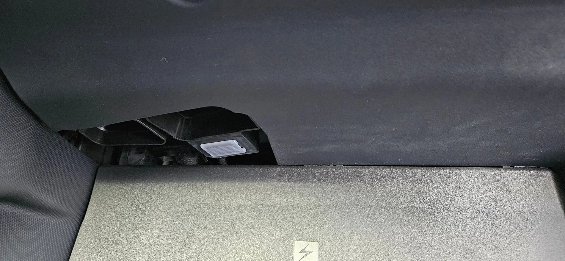

Is it below the glove box, or it needs to be removed first to get access to the fuse box?
Ford Mustang Mach-E How to open Body Control Module Fuse Box 20260201_103537
Is the white square plastic thing the one that covers the fuses and needs to be removed?

No. Look up at the FRONT of that top panel. You will see 2 fasteners. Using a screwdriver, pull the middle section of each out, then the panel comes down.

The white thing is the footwell light. Do not attempt to remove that. On the edge of the privacy panel that is farthest from the firewall (closest to the glove box hinge) there are two plastic reusable rivets. Pull the center pin out of the plastic rivets and remove them. The edge of the panel closest to the glove box hinge can then be lowered away from the bottom of the dash and then you can slide its feet from their mooring points. 😁🐩
