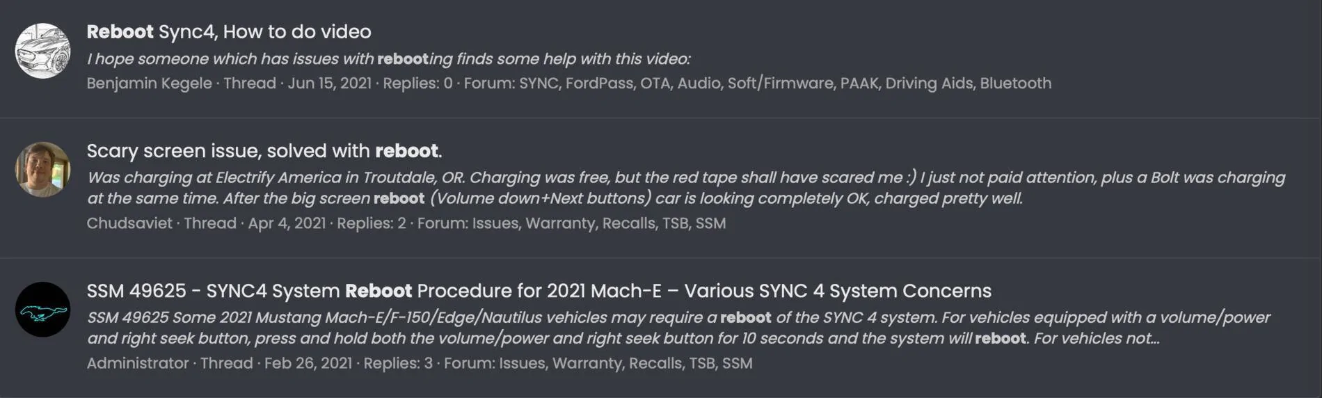

Yes, @TheVirtualTim posted a video about releasing a couple of the latched connectors in the underhood bused electrical center.
Thanks for this. Had the DSP fix about 14 months ago. All was fine until this past week. Radio silence. All audio silence. Reset Sync. No joy. Found this post. Followed the link. Pulled the fuse connections, let it sit for 5 minutes (okay 10), reconnected the fuse blocks, reassembled things. Cured.
Thank you. Thank you. Saved the pain of going through the dealer who, as pointed out, knows much less than those posting here.
