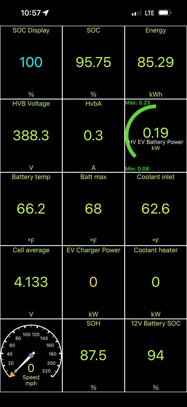

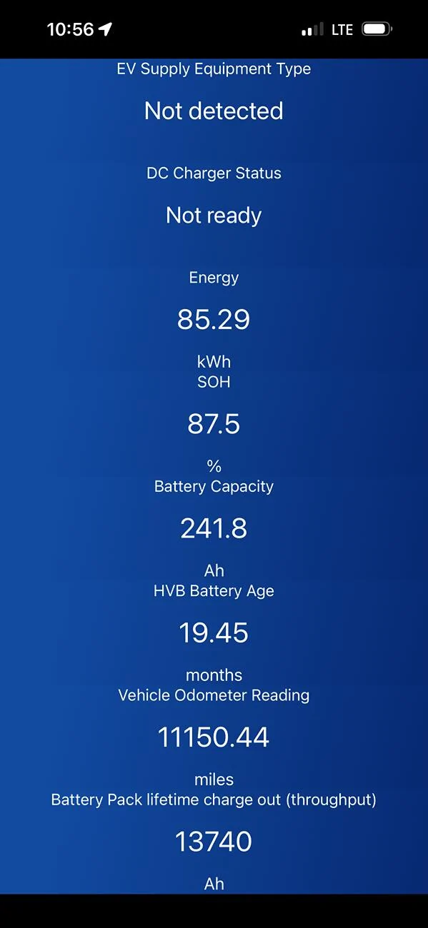

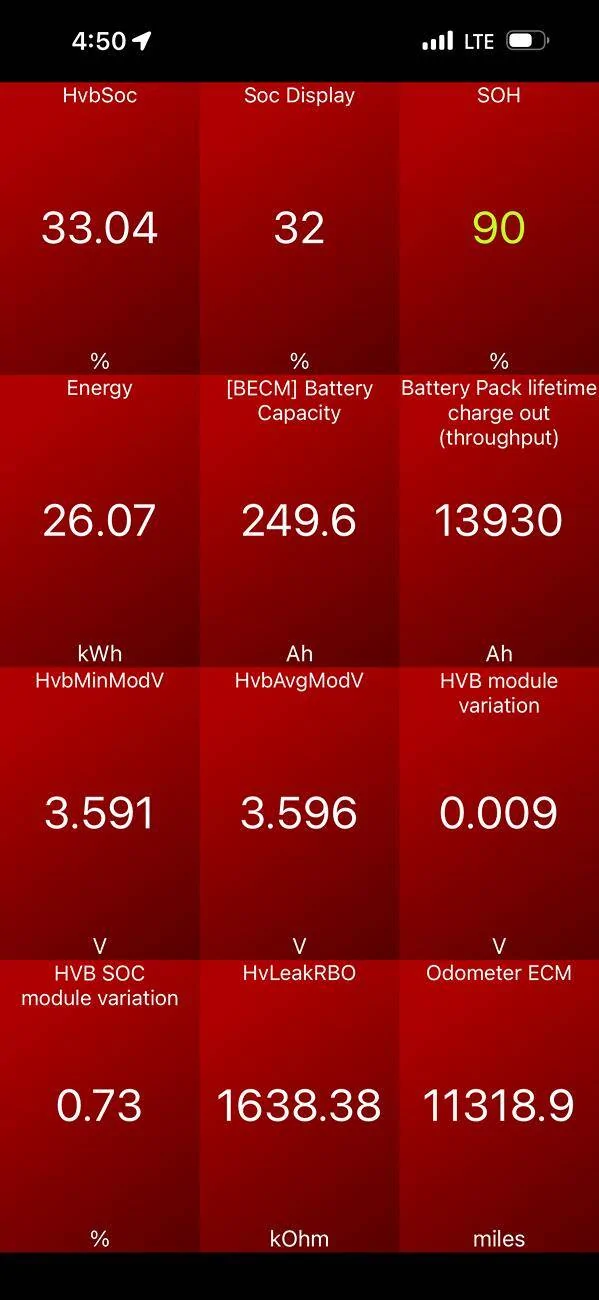

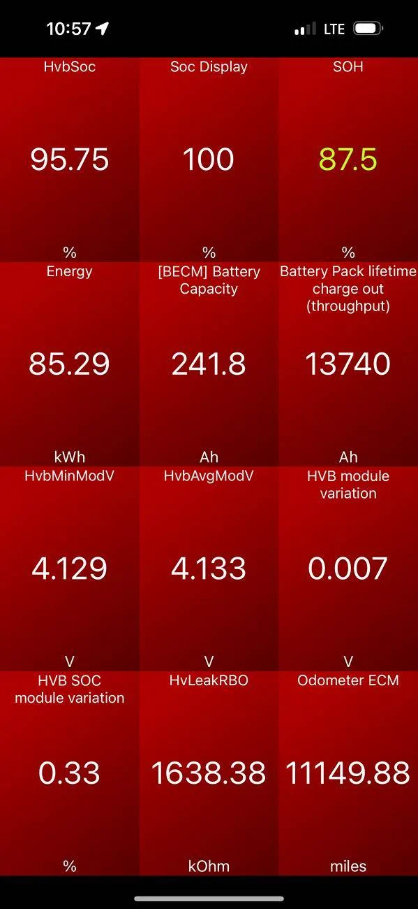

19 month old battery at 87.5 SOH with 12000 miles after calibration. There was 0 change of SOH after calibration. 100-5% At 60+ degrees overnight for low cell measurements. Overnight at 60+ for high cell measurements. What gives?? The charge session did stop at 50% for an hour because that’s my daily limit. My work commute is 25 miles a day.
Most likely because the charge session was interrupted. Charge sessions must be continuous and you can't use remote start or departure times because that affects the kWh measurement the car is making. You will need to use an always-on EVSE that doesn't have any limits or schedules.
If, from initial post “ there is no official procedure from Ford for battery calibration.” is this, therefore, not a recalibration of the SoH measure and explains why this procedure largely doesn’t seem to achieve very much that I have read or done ??‍♂
Results vary. Some people see no change, and some have seen up to 5% improvement doing the procedure a couple times. It does work if the battery is truly out of calibration and the procedure is followed correctly. Seems like most people see 1-2% improvement after doing it once.
85.29/91 = 93.7%. If you are consistently able to charge above 85 kWh, I bet the SoH estimate goes up.
